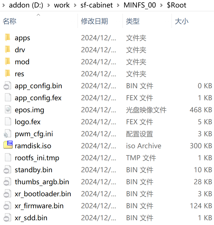

但是还是让我找到了一个提取 rootfs.iso minfs 文件的办法
https://github.com/wrongbaud/sf-cabinet
仓库本站下载:sf-cabinet_20241209_git.7z
extminfs.exe "D:\work\F1C200S_Melis_V1.7_mdk\melis2.0-sdk-release\workspace\suniv\beetles\rootfs.iso"
D:\work\sf-cabinet>extminfs.exe "D:\work\F1C200S_Melis_V1.7_mdk\melis2.0-sdk-release\workspace\suniv\beetles\rootfs.iso"
MINFS tree will be saved to MINFS_00
MINFS image analysis will be saved to MINFS_00\MINFS_analysis.txt

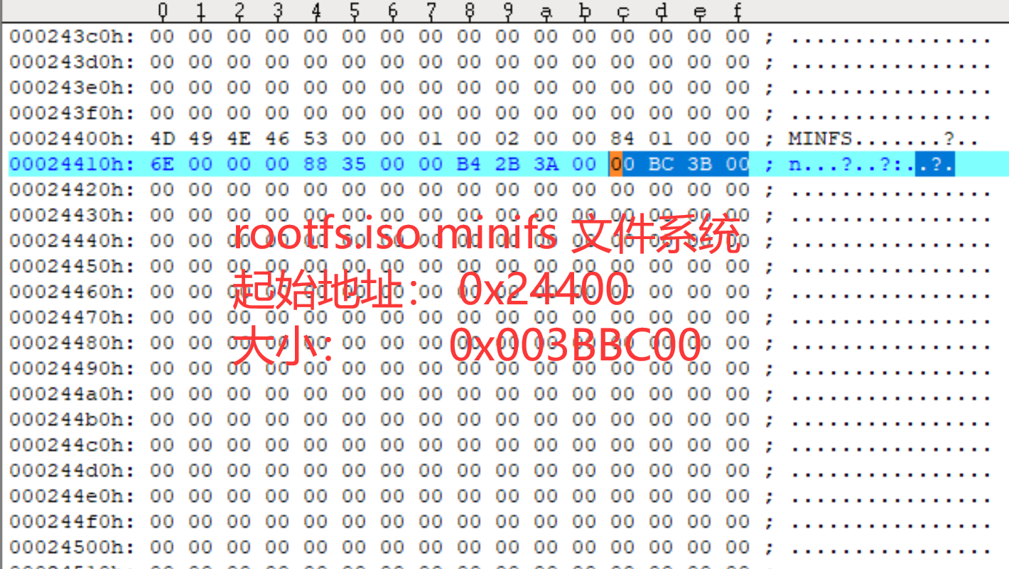

打开 melis100.fex 文件:
rootfs.iso minifs 文件系统
起始地址: 0x24400
大小:       0x003BBC00

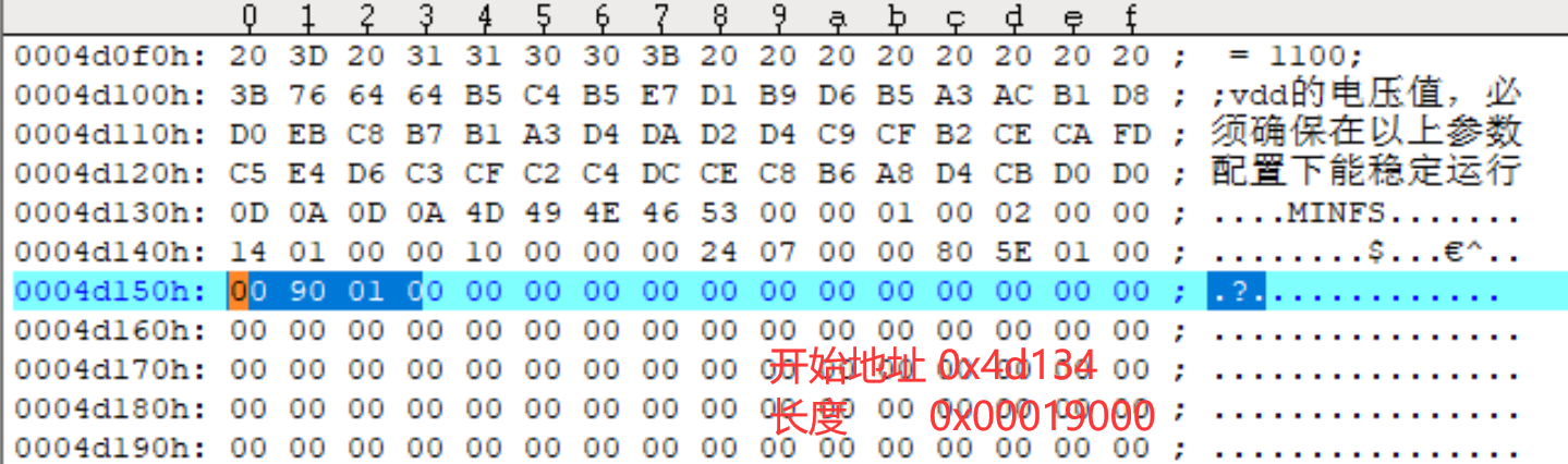

开始地址 0x4d134
长度       0x00019000

用 dd 命令提取ramfs.iso文件:
dd bs=1 if=input.bin of=ramfs.iso skip=$((0x4d134)) count=$((0x00019000))
dd bs=1 if=input.bin of=rootfs.iso skip=$((0x00024400)) count=$((0x3bbc00))
用 extminfs 释放文件系统:
extminfs.exe "D:\ramfs.iso"
