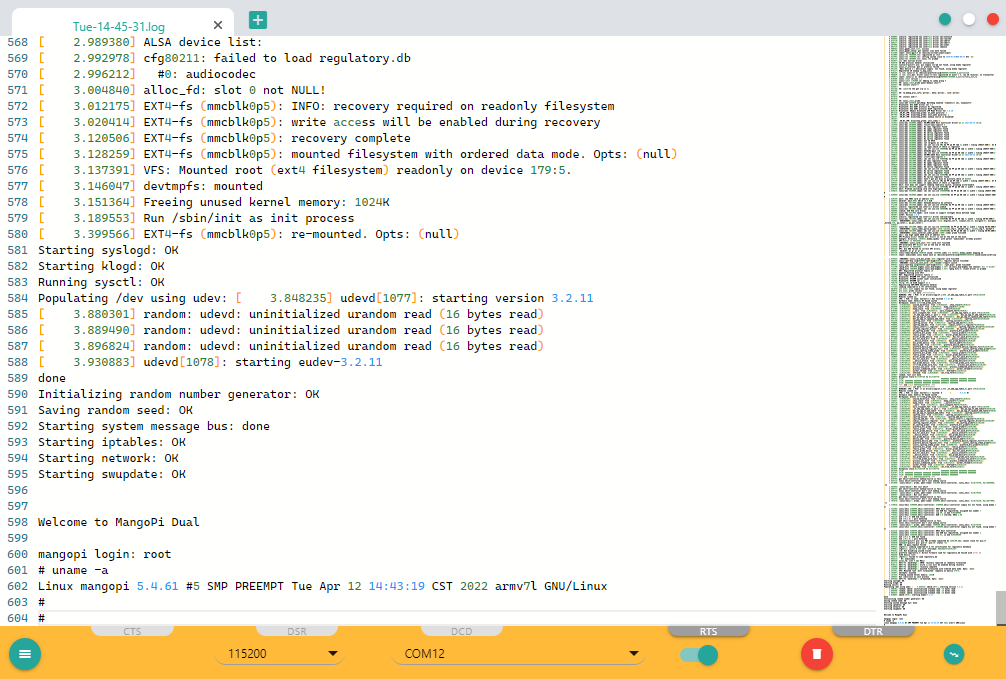

reboot 命令后无法重启,卡死在这里
# reboot
# Stopping swupdate: OK
Stopping network: OK
Stopping iptables: OK
Stopping system message bus: done
Saving random seed: OK
Stopping klogd: OK
Stopping syslogd: OK
umount: devtmpfs busy - remounted read-only
[  323.862951] EXT4-fs (mmcblk0p5): re-mounted. Opts: (null)
The system is going down NOW!
Sent SIGTERM to all processes
Sent SI[  325.876597] reboot_callback(): empty arg
[  325.881037] [ohci1-controller]: ohci shutdown start
[  325.886538] [ohci1-controller]: ohci shutdown end
[  325.891879] [ehci1-controller]: ehci shutdown start
[  325.897336] [ehci1-controller]: ehci shutdown end
[  325.902617] sunxi_ohci_hcd_shutdown, ohci0-controller is disable, need not shutdown
[  325.911163] sunxi_ehci_hcd_shutdown, ehci0-controller is disable, need not shutdown
[  325.931933] sunxi-mmc 4020000.sdmmc: sdc set ios:clk 0Hz bm PP pm OFF vdd 0 width 1 timing LEGACY(SDR12) dt B
[  326.722147] reboot: Restarting system

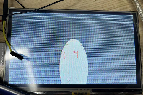

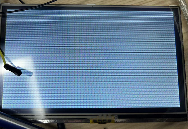

一样的板子。 一样的屏幕 单拍5寸电阻屏旧,480*272分辨率,电阻触摸,外观旧
结果怎么差别这么大.
