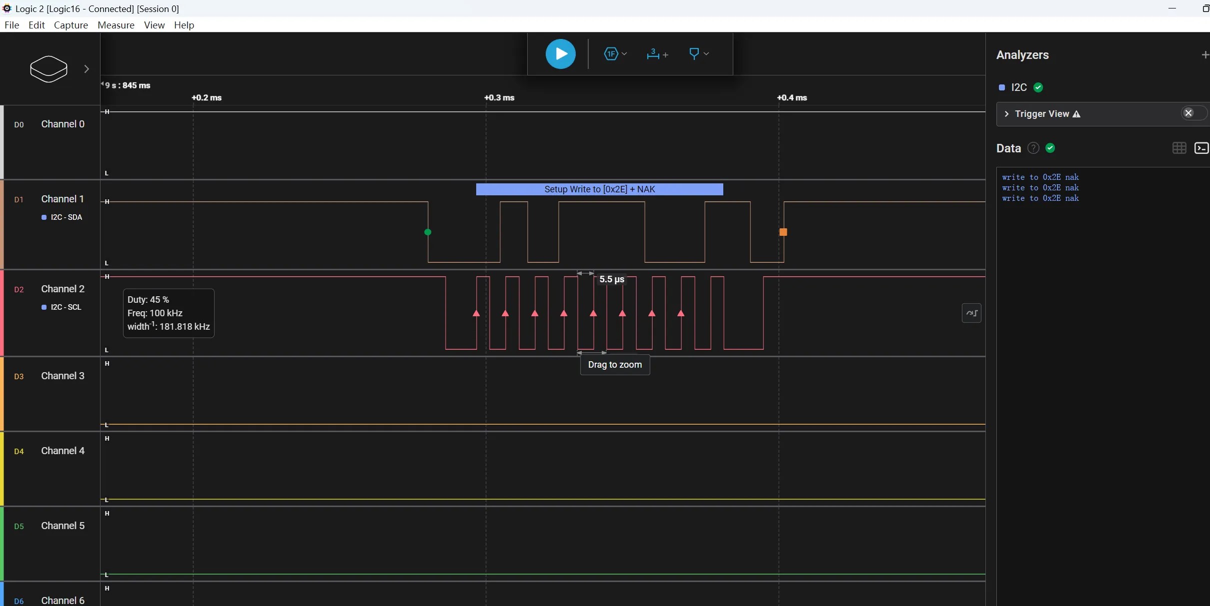

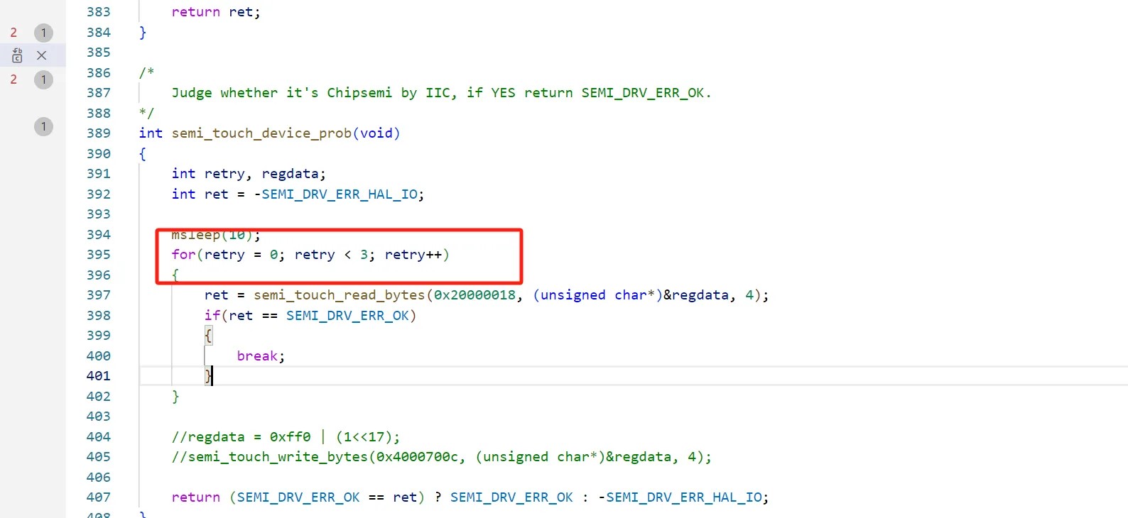

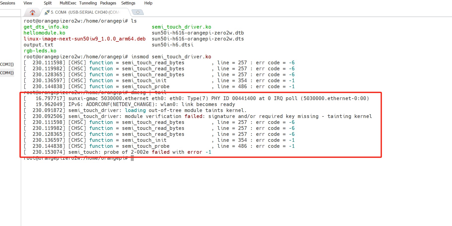

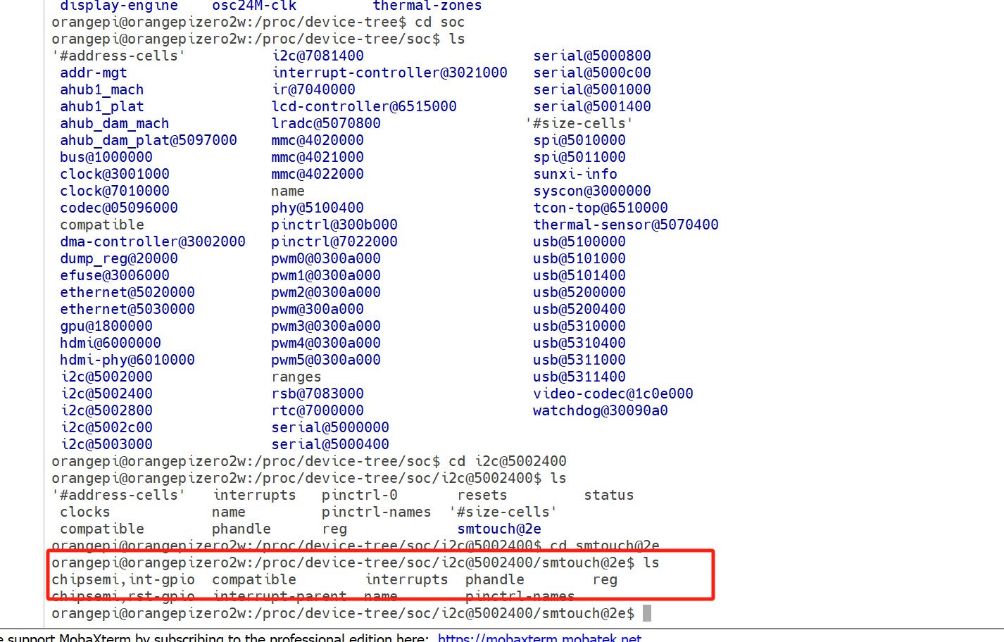

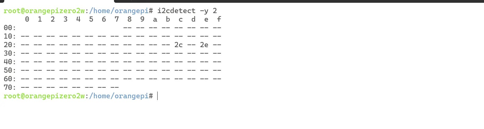

H616 orangepi zero 2w touch_driver 移植过程设备树设置问题请教
生成orangepi zero 2w 移植 touch_driver 移植过程问题:主要是对全志设备树的修改不熟悉
求指导全志的h616移植驱动设备树设置
[]linux 6.1内核版本链接[/]
https://github.com/orangepi-xunlong/linux-orangepi/tree/orange-pi-6.1-sun50iw9

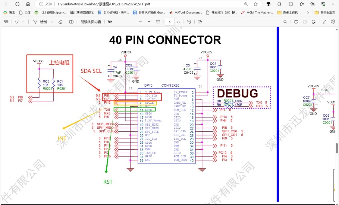

  • 硬件引脚选取
根据原理图选择引脚
SDA : PI8
SCL : PI7
INT : PI13
RST : TX5 -> B15->PH2

[    1.738356] sun50i-h616-pinctrl 300b000.pinctrl: supply vcc-pi not found, using dummy regulator
[    1.739038] sun50i-h616-pinctrl 300b000.pinctrl: unsupported function gpio-in on pin PI13
[    1.739049] semi_touch 2-002e: there is not valid maps for state pmx_ts_active
[    1.739059] sun50i-h616-pinctrl 300b000.pinctrl: missing function property in node ts_reset-active

[  230.091872] semi_touch_driver: loading out-of-tree module taints kernel.
[  230.092506] semi_touch_driver: module verification failed: signature and/or required key missing - tainting kernel
[  230.111598] [CHSC] function = semi_touch_read_bytes         , line = 257 : err code = -6
[  230.119982] [CHSC] function = semi_touch_read_bytes         , line = 257 : err code = -6
[  230.128365] [CHSC] function = semi_touch_read_bytes         , line = 257 : err code = -6
[  230.136597] [CHSC] function = semi_touch_init               , line = 354 : err code = -1
[  230.144838] [CHSC] function = semi_touch_probe              , line = 486 : err code = -1
[  230.153074] semi_touch: probe of 2-002e failed with error -1

硬件连接后使用 i2cdetect 来进行确认硬件连接是正常的
