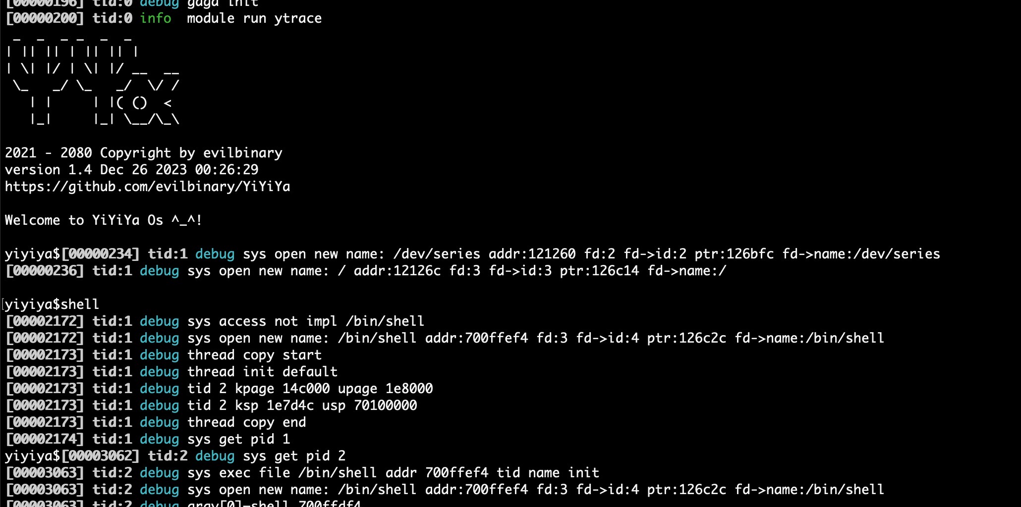

build success! cost 0:00:01.302443
run v3s fel build/v3s/armv7-a/debug/duck.fit
AWUSBFEX soc=00001681(V3s) 00000001 ver=0001 44 08 scratchpad=00007e00 00000000 00000000
串口中输入运行
infones mario.nes
boot
Hello,YiYiYa OS
display init
test display hello,YiYiYa
interrupt init cpu 0
mm init
phy dump
base:0 0 lenght:0 40000000 type:1
total memory 1024m 1048576k
alloc init
kernel base 100000 end 14b800
add block:0 type:1 size:1048552 start: 18 end:100000
add block:14b800 type:1 size:1072383976 start: 14b818 end:40000000
[00000000] tid:0 info  exception init
[00000000] tid:0 info  page init
map mem block start
map mem block addr range 14b800 - 285b800
map mem range
map mem kernel
map kernel start
map kernel 0 range 100000  - 1245da type 1
map kernel 1 range 125000  - 134228 type 1
map kernel end 2
[00000000] tid:0 info  page enable page: 14c000
enable page
paging success
[00000000] tid:0 info  page enable end
[00000000] tid:0 info  syscall init
[00000000] tid:0 info  schedule init
timer init
cntfrq 62500
val 59063
[00000000] tid:0 info  module init
[00000000] tid:0 info  memory init
[00000000] tid:0 info  vfs init
[00000000] tid:0 info  thread init
[00000000] tid:0 info  event init
[00000000] tid:0 info  kernel init end
[00000000] tid:0 debug tid 0 kpage 14c000 upage 14c000
[00000000] tid:0 debug tid 0 ksp 18c628 usp 90100000
[00000000] tid:0 debug tid 1 kpage 14c000 upage 194000
[00000000] tid:0 debug tid 1 ksp 19113c usp 70100000
[00000000] tid:0 info  kernel run start
[00000001] tid:0 info  module regist
[00000022] tid:0 info  module regist end
[00000024] tid:0 info  module run devfs
[00000026] tid:0 warn  not fond device 0
[00000027] tid:0 warn  not fond device 2
[00000028] tid:0 warn  not fond device 3
[00000029] tid:0 warn  not fond device 6
[00000031] tid:0 warn  not fond device 22
[00000033] tid:0 info  module run serial
[00000037] tid:0 info  module run i2c
[00000038] tid:0 info  i2c init
[00000039] tid:0 info  module run gpio
[00000040] tid:0 info  gpio init
[00000041] tid:0 info  module run spi
[00000063] tid:0 debug spi
[00000063] tid:0 info  module run vga
[00000065] tid:0 debug map box 3f00b000
[00000067] tid:0 debug fb addr:3c100000 end:3d0f0000 len:3fc000
[00000069] tid:0 debug map fb start 3c100000 3c100000
[00000071] tid:0 debug map fb end 3c4fc000 3c4fc000
[00000072] tid:0 info  gpu_init_device end
[00000074] tid:0 info  module run mouse
[00000075] tid:0 info  module run sdhci
[00000077] tid:0 info  sdhci_init
[00000104] tid:0 info  module run fat
[00000105] tid:0 info  fat init
[00000108] tid:0 debug empty partition entry
[00000109] tid:0 info  partition type:ff offset:0 length:0
[00000112] tid:0 info  fat init end
[00000113] tid:0 info  module run test
[00000114] tid:0 info  test hello
[00000116] tid:0 info  module run rtc
[00000117] tid:0 info  module run posix
[00000118] tid:0 info  posix init
[00000120] tid:0 info  module run pty
[00000121] tid:0 info  module run log
[00000142] tid:0 info  module run loader
[00000143] tid:0 debug loader init
[00000144] tid:0 info  module run musl
[00000145] tid:0 info  musl init
[00000146] tid:0 info  enable float
[00000147] tid:0 info  module run gaga
[00000150] tid:0 debug gaga init
[00000153] tid:0 info  module run ytrace
 _  _  _ _  _  _
| \| |/ | \| |/ __  __
 \_   _/ \_   _/  \/ /
   |_|     |_| \__/\_\
2021 - 2080 Copyright by evilbinary
version 1.4 Dec 26 2023 00:26:29
https://github.com/evilbinary/YiYiYa
Welcome to YiYiYa Os ^_^!
yiyiya$[00000164] tid:1 debug sys open new name: /dev/series addr:121260 fd:2 fd->id:2 ptr:126bfc fd->name:/dev/series
[00000165] tid:1 debug sys open new name: / addr:12126c fd:3 fd->id:3 ptr:126c14 fd->name:/
yiyiya$
yiyiya$infones mario.nes
[00007743] tid:1 debug sys access not impl /bin/infones
[00007743] tid:1 debug sys open new name: /bin/infones addr:700ffef4 fd:3 fd->id:4 ptr:126c2c fd->name:/bin/infones
[00007744] tid:1 debug thread copy start
[00007744] tid:1 debug thread init default
[00007744] tid:1 debug tid 2 kpage 14c000 upage 1e8000
[00007744] tid:1 debug tid 2 ksp 1e7d4c usp 70100000
[00007744] tid:1 debug thread copy end
[00007745] tid:1 debug sys get pid 1
yiyiya$[00007752] tid:2 debug sys get pid 2
[00007753] tid:2 debug sys exec file /bin/infones addr 700ffef4 tid name init
[00007753] tid:2 debug sys open new name: /bin/infones addr:700ffef4 fd:3 fd->id:4 ptr:126c2c fd->name:/bin/infones
[00007753] tid:2 debug argv[0]=infones 700ffdf4
[00007753] tid:2 debug argv[1]=mario.nes 700ffdf8
[00007753] tid:2 debug envp 0 argc 2
[00007754] tid:2 debug sys open new name: /bin/infones addr:700ffef4 fd:3 fd->id:4 ptr:126c2c fd->name:/bin/infones
[00007760] tid:2 debug sys fn faild f0005
[00007760] tid:2 debug sys set thread area not impl
[00007761] tid:2 debug sys set tid adress not impl
[00007782] tid:2 debug sys open new name: /dev/stdin addr:7106912c fd:4 fd->id:0 ptr:126bcc fd->name:/dev/stdin
[00007783] tid:2 debug sys open new name: /dev/fb addr:71069140 fd:5 fd->id:5 ptr:126c44 fd->name:/dev/fb
screen init fd:5
[00007787] tid:2 debug map box 3f00b000
[00007787] tid:2 debug fb addr:3c100000 end:3d0f0000 len:3fc000
[00007787] tid:2 debug map fb start 3c100000 3c100000
[00007787] tid:2 debug map fb end 3c4fc000 3c4fc000
[00007787] tid:2 info  gpu_init_device end
screen init 480x272 bpp:32 fb count:1 len:1880096768 buffer len:0
[00007789] tid:2 debug sys open name return : /dev/stdin fd: 4
[00007790] tid:2 debug sys open new name: /dev/mouse addr:71069270 fd:6 fd->id:6 ptr:126c5c fd->name:/dev/mouse
[00007795] tid:2 debug sys open new name: mario.nes addr:711202fc fd:7 fd->id:7 ptr:126c74 fd->name:mario.nes
InfoNES_SoundOpen: samples_per_sync=735, sample_rate=44100
运行效果图
最近编辑记录 evilbinary (2023-12-26 23:01:38)
