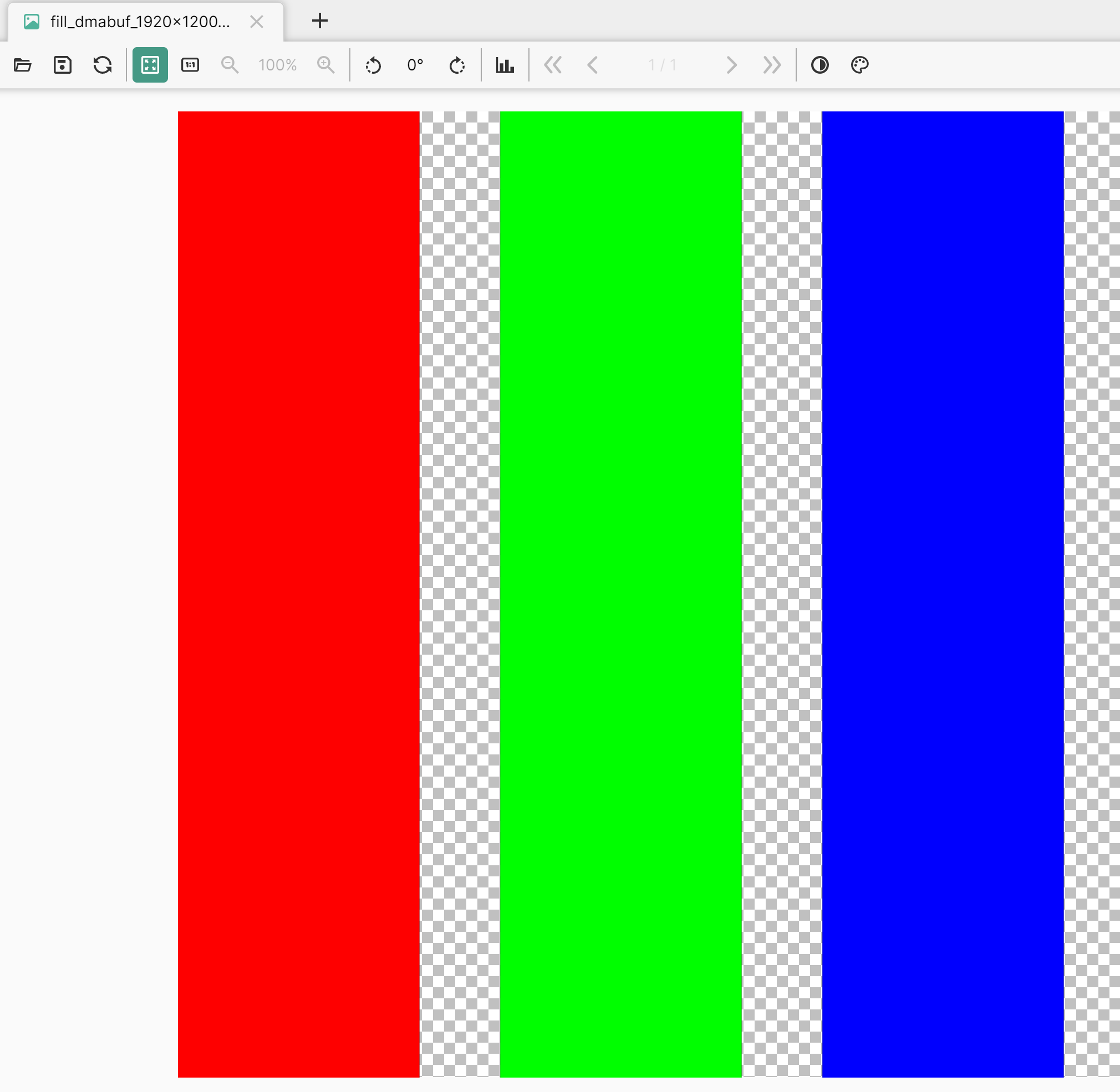

编译指令:
STAGING_DIR="" /opt/T113_Tina5.0/prebuilt/rootfsbuilt/arm/toolchain-sunxi-glibc-gcc-830/toolchain/bin/arm-openwrt-linux-gcc -o g2d_fill_dmabuf src/g2d_fill_dmabuf.c
运行指令:
chmod +x /tmp/g2d_fill_dmabuf && /tmp/g2d_fill_dmabuf -out_fb 2 1920 1200 -dst_rect 0 0 1920 1200 -out_file /tmp/fill_dmabuf_0_1920x1200_abgr8888_2.bin -color 570460160 -alpha_mode 2 -alpha 128
运行日志:
#chmod +x /tmp/g2d_fill_dmabuf && /tmp/g2d_fill_dmabuf -out_fb 2 1920 1
out_file=/tmp/fill_dmabuf_0_1920x1200_abgr8888_2.bin
out_size=9216000
ready to open dst file
[ion_open]: success fd = 4
ion_memory_request(197): ion_fd 4
---> is_iommu_enabled
ion_memory_request(214): ION_HEAP_TYPE 0x1
ion_memory_request(223): ION_IOC_ALLOC succes, dmabuf-fd = 0, size = -1097396703
dst:format=0x2,color=0x22008800
 img w=1920, h=1200,
 rect x=0, y=0, w=1920, h=1200, align=0
[309][g2d_fill_dmabuf.c][main]G2D_CMD_FILLRECT_H Successful!
save result data to file /tmp/fill_dmabuf_0_1920x1200_abgr8888_2.bin
open file /tmp/fill_dmabuf_0_1920x1200_abgr8888_2.bin ok.
==out_size=9216000, addr=0xb6549000==
fwrite,ret=1

    strcpy(test_info.out_filename, "/tmp/fill_dmabuf_1920x1200_bgra8888.bin"); //pixelviewer的解析格式和g2d format刚好反过来
	test_info.info.dst_image_h.width = 1920;
	test_info.info.dst_image_h.height = 1200;
	out_size = test_info.info.dst_image_h.width * test_info.info.dst_image_h.height * 4;
	printf("out_size=%d\n", out_size);
	dst_fd = ion_memory_request(&test_info.dst_ion, out_size);
	if(dst_fd <= 0)
		printf("request dst_mem failed! \n");
	test_info.info.dst_image_h.fd = dst_fd;
	fb_width = test_info.info.dst_image_h.width;
	fb_height = test_info.info.dst_image_h.height;
    //Red
    test_info.info.dst_image_h.format = G2D_FORMAT_ARGB8888;
    test_info.info.dst_image_h.clip_rect.x = 0;
    test_info.info.dst_image_h.clip_rect.y = 0;
    test_info.info.dst_image_h.clip_rect.w = 300;
    test_info.info.dst_image_h.clip_rect.h = 1200;
    test_info.info.dst_image_h.color = 0xFFFF0000; //A,R,G,B
    test_info.info.dst_image_h.mode = G2D_MIXER_ALPHA; //G2D_PIXEL_ALPHA,G2D_GLOBAL_ALPHA,G2D_MIXER_ALPHA
    test_info.info.dst_image_h.alpha = 0x30;
    if(ioctl(test_info.fd , G2D_CMD_FILLRECT_H ,(unsigned long)(&test_info.info)) < 0)
        printf("[%d][%s][%s]G2D_CMD_FILLRECT_H failure!\n",__LINE__, __FILE__,__FUNCTION__);
        ion_memory_release(dst_fd);
        close(test_info.fd);
        return -1;
        return -1;
    //Green
    test_info.info.dst_image_h.clip_rect.x = 400;
    test_info.info.dst_image_h.color = 0xFF00FF00;//A,R,G,B
    test_info.info.dst_image_h.mode = 1;
    test_info.info.dst_image_h.alpha = 0xFF;
        return -1;
    //Blue
	test_info.info.dst_image_h.clip_rect.x = 800;
	test_info.info.dst_image_h.color = 0xFF0000FF;//A,R,G,B
    /* fill color */
        return -1;

out_size=9216000
ion_memory_request(107): ion_fd 4
ion_memory_request(124): ION_HEAP_TYPE 0x1
ion_memory_request(133): ION_IOC_ALLOC succes, dmabuf-fd = 0, size = 9216000
save result data to file /tmp/fill_dmabuf_1920x1200_bgra8888.bin
open file /tmp/fill_dmabuf_1920x1200_bgra8888.bin ok.
==out_size=9216000, addr=0xb6500000==
fwrite,ret=1
adb pull /tmp/fill_dmabuf_1920x1200_bgra8888.bin

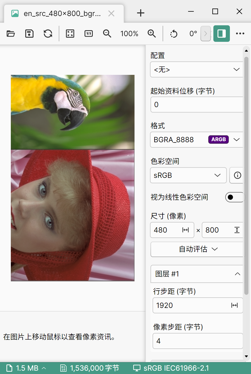

旋转测试:
chmod +x /tmp/g2d_lbc_rot && /tmp/g2d_lbc_rot -flag 256 -in_fb 0 800 480 -src_rect 0 0 800 480 -out_fb 0 480 800 -dst_rect 0 0 480 800 -src_file /tmp/src_800x480_rgb.bin -dst_file /tmp/en_src_480x800_bgra888_rotate_90.bin

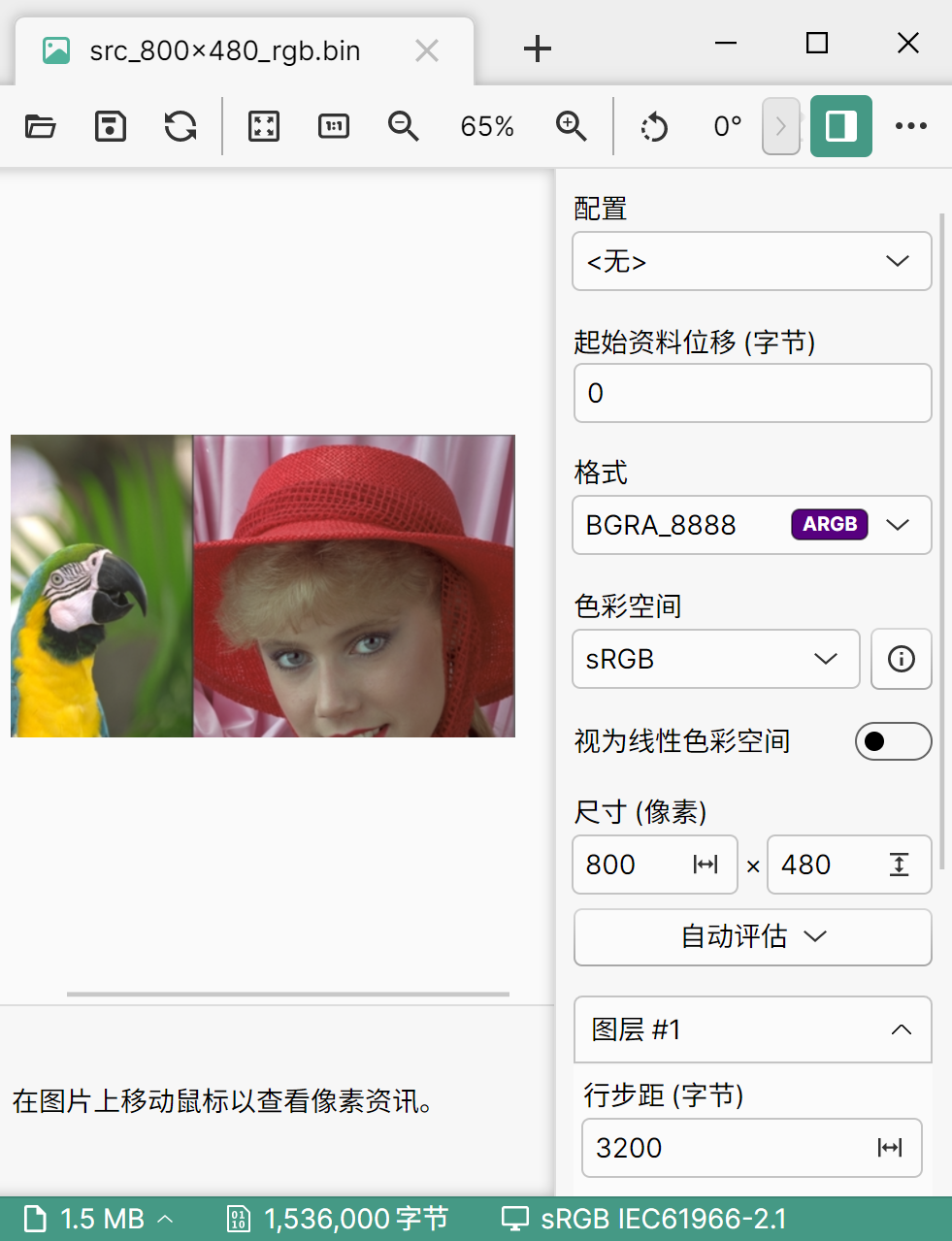

原图:
旋转90°:
楼主 #6 2024-07-01 15:53:43

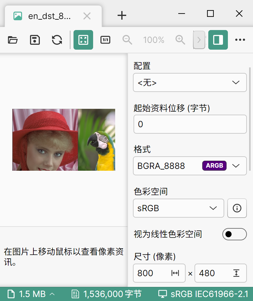

测试水平镜像:
chmod +x /tmp/g2d_lbc_rot && /tmp/g2d_lbc_rot -flag 4096 -in_fb 0 800 480 -src_rect 0 0 800 480 -out_fb 0 800 480 -dst_rect 0 0 800 480 -src_file /tmp/src_800x480_rgb.bin -dst_file /tmp/en_dst_800x480_bgra888_flip_h.bin
