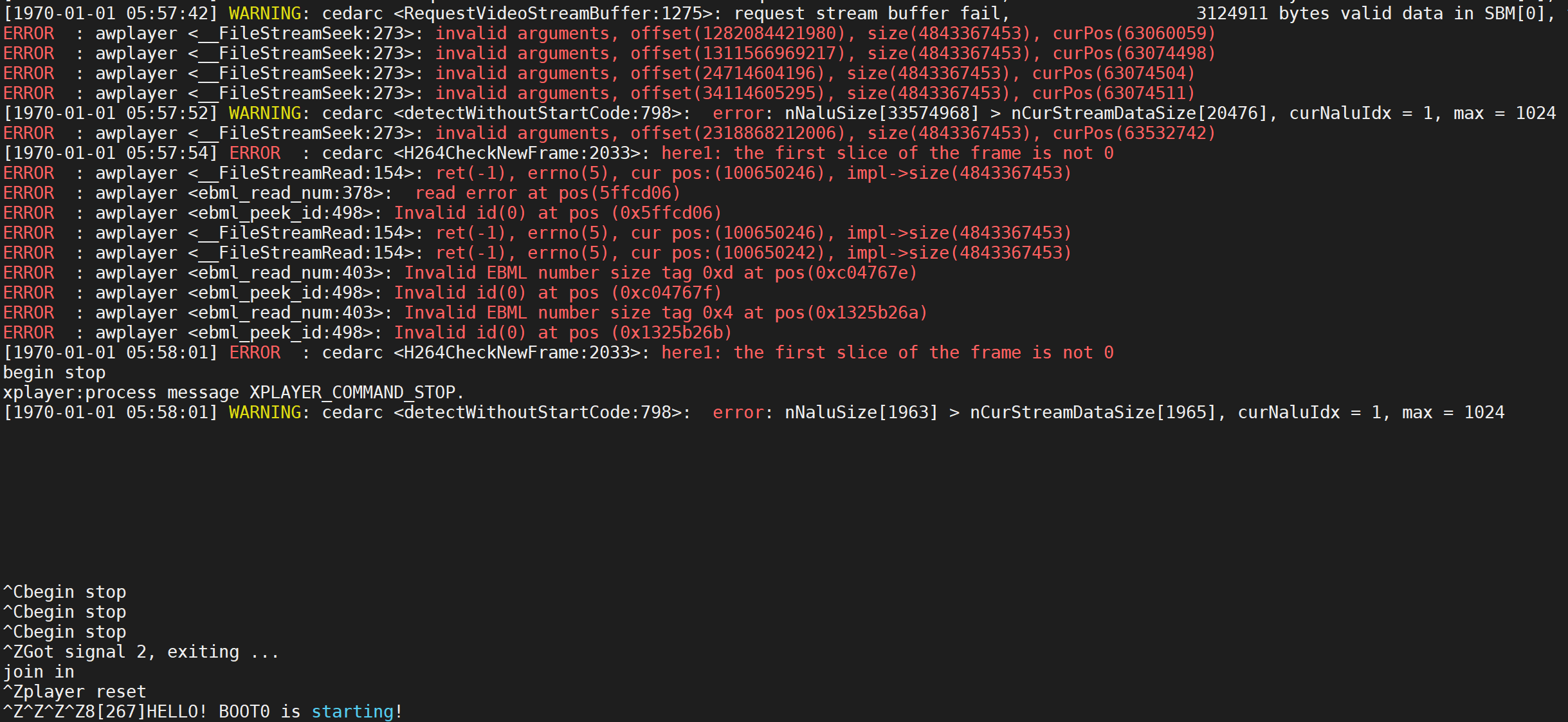

T113 tplayerdemo 播放视频,放着放着就挂了
Clicked item content: "/mnt/exUDISK/x.mp4"
xplayer:process message XPLAYER_COMMAND_STOP.
ERROR  : audioDecItf <handleStop:1109>: invalid stop operation, already in stopped status.
join in
xplayer:process message XPLAYER_COMMAND_RESET.
ERROR  : awplayer <PlayerStop:994>: invalid stop operation, player already in stopped status.
player reset
player destroy
>>>>>>>>>>>>>>>>>>>>>>>>>>>>>>> tina_multimedia <<<<<<<<<<<<<<<<<<<<<<<<<<<<<<<
tag   : tina3.5
branch: tina-dev
date  : Mon Jul 15 19:04:59 2019 +0800
Change-Id: I5f6c8a88d7b387a312b7744797a0d5f8ab07ee7a
xplayer:process message XPLAYER_COMMAND_SET_AUDIOSINK.
xplayer:process message XPLAYER_COMMAND_SET_SURFACE.
xplayer:process message XPLAYER_COMMAND_SET_SUBCTRL.
xplayer:process message XPLAYER_COMMAND_SET_DI.
xplayer:process message XPLAYER_COMMAND_SET_SOURCE.
xplayer:process message XPLAYER_COMMAND_PREPARE.
ERROR  : CdxFlvParser.c <__CdxFlvParserProbe:4030>: FlvProbe failed.
ERROR  : CdxAviParser <__CdxAviParserProbe:1251>: AviProbe failed.
warning: unknown callback from Tinaplayer.
[1970-01-01 03:47:30] ERROR  : cedarc <DebugCheckConfig:302>: now cedarc log level:5
setDataSource end
*****tplayer:video width = 3840,height = 1608
TPLAYER_NOTIFY_PREPARED,has prepared.
prepare
prepared ok
xplayer:process message XPLAYER_COMMAND_START.
(Allwinner Audio Middle Layer),line(971) : Create Decoder!!=====
(Allwinner Audio Middle Layer),line(603) : AudioDec_Installaudiolib ok
(Allwinner Audio Middle Layer),line(606) : audio decoder init start ...
(AllwinnerAlibs),line(50) :
>>>>>>>>>>>>>>>>>>>>>>>>>>>>>>> Audio <<<<<<<<<<<<<<<<<<<<<<<<<<<<<<<
tag   : audiocodec-v1.2
branch: new
commit: 3ba65962c01cbf1280ddda19d843009b6ef8ce85
date  : Tue Jan 8 16:25:27 2019 +0800
(AllwinnerAlibs),line(695) : ----Loading so fail
(Allwinner Audio Middle Layer),line(274) : audio decode InitializeAudioDecoder fail!
ERROR  : audioDecItf <handleStart:1073>: initialize audio decoder fail.
(Allwinner Audio Middle Layer),line(920) : destroy_ResampleInfo!!
(Allwinner Audio Resample),line(68) : Destroy_ResampleInfo...
==> duration = 6431463
ERROR  : awplayer <__LayerQueueBuffer:934>: *** picNode is full when queue buffer
*****tplayer:video decoded width = 1920,height = 804
****player(0x1fc61e0): first video pts = 0*****
[1970-01-01 03:47:30] WARNING: cedarc <HevcSetNewRef:905>:  hevc decoder drop one frame. poc: 3
[1970-01-01 03:47:31] ERROR  : fbm.c <FbmReturnPicture:1043>: invalid frame status, a picture being returned,                 but bUsedByRender=0, bInValidPictureQueue=1, bAlreadyDisplayed=0.
[1970-01-01 03:47:31] ERROR  : fbm.c <FbmReturnPicture:1044>: **picture[0xb160c8e8],id[8]
[1970-01-01 03:47:31] WARNING: cedarc <ReturnPicture:1700>: FbmReturnPicture return fail,            it means the picture being returned it not one of this FBM.
xplayer:process message XPLAYER_COMMAND_SEEK.
ERROR  : audioDecItf <handlePause:1147>: invalid pause operation, component not in started status.
newValue=1469235
branch: new
TPLAYER_NOTIFY_SEEK_COMPLETE>>>>info: seek ok.
[1970-01-01 03:49:54] WARNING: cedarc <HevcAddCandidateRef:179>: ******* drop the RASL nalu as miss ref_frame
[1970-01-01 03:49:54] WARNING: cedarc <HevcFrameStart:2036>:  construct reference picture set failed , ret = 35
****player(0x1fc61e0): first video pts = 1469417000*****
Clicked item content: "/mnt/exUDISK/Music/0799.ywsy.mp3"
join in
player reset
player destroy
tag   : tina3.5
branch: tina-dev
ERROR  : CdxOggParser <OggParserProbe:2441>: It is not ogg version 0.
ERROR  : _apepsr <CdxApeParserProbe:780>: pApe Probe Failed
ERROR  : awplayer <__FlacParserProbe:1390>: Flac probe failed.
ERROR  : awplayer <WavProbe:977>: audio probe fail!!!
ERROR  : awplayer <__WavParserProbe:992>: wav probe failed.
setDataSource end
prepare
prepared ok
branch: new
(AllwinnerAlibs),line(700) : ----Loading so success!
(AllwinnerAlibs),line(902) : *************pAudioStreamInfo start******************
(AllwinnerAlibs),line(903) : eCodecFormat         :id(3), name(mpeg layer-III)
(AllwinnerAlibs),line(904) : eSubCodecFormat      :0
(AllwinnerAlibs),line(905) : nChannelNum          :2
(AllwinnerAlibs),line(906) : nBitsPerSample       :16
(AllwinnerAlibs),line(907) : nSampleRate          :44100
(AllwinnerAlibs),line(908) : nAvgBitrate          :128000
(AllwinnerAlibs),line(909) : nMaxBitRate          :128000
(AllwinnerAlibs),line(910) : nFileSize            :0
(AllwinnerAlibs),line(911) : eAudioBitstreamSource:0
(AllwinnerAlibs),line(912) : eDataEncodeType      :0
(AllwinnerAlibs),line(913) : nCodecSpecificDataLen:0
(AllwinnerAlibs),line(914) : pCodecSpecificData   :(nil)
(AllwinnerAlibs),line(915) : nFlags               :0
(AllwinnerAlibs),line(916) : nBlockAlign          :0
(AllwinnerAlibs),line(917) : *************pAudioStreamInfo end  ******************
(AllwinnerAlibs),line(27) : init successs...
(Allwinner Audio Middle Layer),line(614) : AUDIO DECODE INIT OK...0
==> duration = 265012
****player(0x1fc7660): first audio pts = 0*****
Clicked item content: "/mnt/exUDISK/Music/haoaini.wav"
(AllwinnerAlibs),line(34) : exit successs...
(AllwinnerAlibs),line(750) : ----dlclose so success!
join in
player reset
player destroy
tag   : tina3.5
branch: tina-dev
setDataSource end
prepare
prepared ok
branch: new
(AllwinnerAlibs),line(903) : eCodecFormat         :id(10), name(linear pcm wav audio)
(AllwinnerAlibs),line(904) : eSubCodecFormat      :1
(AllwinnerAlibs),line(908) : nAvgBitrate          :176400
(AllwinnerAlibs),line(909) : nMaxBitRate          :0
(AllwinnerAlibs),line(916) : nBlockAlign          :4
(Wav Decoder),line(28) : init success...
==> duration = 267866
Clicked item content: "/mnt/exUDISK/Music/0846.djx.mp3"
(Wav Decoder),line(35) : exit successs...
join in
player reset
player destroy
tag   : tina3.5
branch: tina-dev
setDataSource end
prepare
prepared ok
branch: new
==> duration = 273867
join in
player reset
player destroy
tag   : tina3.5
branch: tina-dev
setDataSource end
prepare
prepared ok
branch: new
newValue=38921
(AllwinnerAlibs),line(1474) : ad_cedar seek sync ......nSeekTime:38921000
****player(0x1fc7660): first audio pts = 37999455*****
newValue=63293
(AllwinnerAlibs),line(1474) : ad_cedar seek sync ......nSeekTime:63293000
****player(0x1fc7660): first audio pts = 62989931*****
newValue=142815
(AllwinnerAlibs),line(1474) : ad_cedar seek sync ......nSeekTime:142815000
****player(0x1fc7660): first audio pts = 141984217*****
newValue=190359
(AllwinnerAlibs),line(1474) : ad_cedar seek sync ......nSeekTime:190359000
****player(0x1fc7660): first audio pts = 189997278*****
newValue=234542
(AllwinnerAlibs),line(1474) : ad_cedar seek sync ......nSeekTime:234542000
****player(0x1fc7660): first audio pts = 233987482*****
newValue=249190
(AllwinnerAlibs),line(1474) : ad_cedar seek sync ......nSeekTime:249190000
****player(0x1fc7660): first audio pts = 248999183*****
ERROR  : awplayer <StreamManagerReset:191>: memory leak,,,, the guy not return... '0xb1417728'
(AllwinnerAlibs),line(1474) : ad_cedar seek sync ......nSeekTime:0
^Cbegin stop
Got signal 2, exiting ...
join in
player reset
player destroy
^C# ^C
# chmod +x /usr/bin/player &&  modprobe gt9xxnew_ts && QT_QPA_EVDEV_TOUCHSCREEN_
PARAMETERS=/dev/input/event3 /usr/bin/player -platform linuxfb
WARNING: awplayer <cdx_log_set_level:30>: cdx Set log level to 6
[1970-01-01 04:03:23] INFO   : cedarc <CedarPluginVDInit:79>: register h264 decoder success!
[1970-01-01 04:03:23] INFO   : cedarc <CedarPluginVDInit:84>: register mjpeg decoder success!
[1970-01-01 04:03:23] INFO   : cedarc <CedarPluginVDInit:86>: register mpeg2 decoder success!
[1970-01-01 04:03:23] INFO   : cedarc <CedarPluginVDInit:92>: register mpeg4dx decoder success!
[1970-01-01 04:03:23] INFO   : cedarc <CedarPluginVDInit:79>: register mpeg4H263 decoder success!
[1970-01-01 04:03:23] INFO   : cedarc <CedarPluginVDInit:90>: register mpeg4Normal decoder success!
ERROR  : awplayer <DlOpenPlugin:105>: dlopen 'libawwmv3.so' fail: libawwmv3.so: cannot open shared object file: No such file or directory
[1970-01-01 04:03:23] INFO   : cedarc <CedarPluginVDInit:85>: register h265 decoder success!
player not init.
Clicked item content: "/mnt/exUDISK/film/5.Ice.mp4"
player not init.
tag   : tina3.5
branch: tina-dev
[1970-01-01 04:03:27] INFO   : cedarc <log_set_level:43>: Set log level to 5 from /vendor/etc/cedarc.conf
[1970-01-01 04:03:27] ERROR  : cedarc <DebugCheckConfig:302>: now cedarc log level:5
setDataSource end
*****tplayer:video width = 1920,height = 1080
prepare
prepared ok
branch: new
(AllwinnerAlibs),line(903) : eCodecFormat         :id(4), name(aac low-complexy)
(AllwinnerAlibs),line(905) : nChannelNum          :6
(AllwinnerAlibs),line(907) : nSampleRate          :48000
(AllwinnerAlibs),line(908) : nAvgBitrate          :0
(AllwinnerAlibs),line(912) : eDataEncodeType      :1
(AllwinnerAlibs),line(913) : nCodecSpecificDataLen:2
(AllwinnerAlibs),line(914) : pCodecSpecificData   :0xb14685b8
(AAC Decoder),line(36) : init successs...
==> duration = 5672768
****player(0x12b26b8): first audio pts = 0*****
*****tplayer:video decoded width = 1920,height = 1080
*****tplayer:video width = 3840,height = 2160
****player(0x12b26b8): first video pts = 0*****
ERROR  : awplayer <ProcessVideoSync:1317>: need to drop this frame
[1970-01-01 04:03:27] ERROR  : fbm.c <FbmReturnPicture:1043>: invalid frame status, a picture being returned,                 but bUsedByRender=0, bInValidPictureQueue=1, bAlreadyDisplayed=0.
[1970-01-01 04:03:27] ERROR  : fbm.c <FbmReturnPicture:1044>: **picture[0x12e7fd0],id[8]
[1970-01-01 04:03:27] WARNING: cedarc <ReturnPicture:1700>: FbmReturnPicture return fail,            it means the picture being returned it not one of this FBM.
[1970-01-01 04:08:17] WARNING: cedarc <RequestVideoStreamBuffer:1275>: request stream buffer fail,                  3996338 bytes valid data in SBM[0], total buffer size is 4194304 bytes.
[1970-01-01 04:08:47] WARNING: cedarc <RequestVideoStreamBuffer:1275>: request stream buffer fail,                  4145339 bytes valid data in SBM[0], total buffer size is 4194304 bytes.
[1970-01-01 04:08:47] WARNING: cedarc <RequestVideoStreamBuffer:1275>: request stream buffer fail,                  4069633 bytes valid data in SBM[0], total buffer size is 4194304 bytes.
[1970-01-01 04:08:47] WARNING: cedarc <RequestVideoStreamBuffer:1275>: request stream buffer fail,                  4071548 bytes valid data in SBM[0], total buffer size is 4194304 bytes.
[1970-01-01 04:08:47] WARNING: cedarc <RequestVideoStreamBuffer:1275>: request stream buffer fail,                  4169634 bytes valid data in SBM[0], total buffer size is 4194304 bytes.
[1970-01-01 04:08:47] WARNING: cedarc <RequestVideoStreamBuffer:1275>: request stream buffer fail,                  4148802 bytes valid data in SBM[0], total buffer size is 4194304 bytes.
[1970-01-01 04:08:48] WARNING: cedarc <RequestVideoStreamBuffer:1275>: request stream buffer fail,                  4103437 bytes valid data in SBM[0], total buffer size is 4194304 bytes.
[1970-01-01 04:08:48] WARNING: cedarc <RequestVideoStreamBuffer:1275>: request stream buffer fail,                  4136769 bytes valid data in SBM[0], total buffer size is 4194304 bytes.
[1970-01-01 04:08:48] WARNING: cedarc <RequestVideoStreamBuffer:1275>: request stream buffer fail,                  4126547 bytes valid data in SBM[0], total buffer size is 4194304 bytes.
[1970-01-01 04:08:48] WARNING: cedarc <RequestVideoStreamBuffer:1275>: request stream buffer fail,                  4164039 bytes valid data in SBM[0], total buffer size is 4194304 bytes.
[1970-01-01 04:08:48] WARNING: cedarc <RequestVideoStreamBuffer:1275>: request stream buffer fail,                  4155263 bytes valid data in SBM[0], total buffer size is 4194304 bytes.
[1970-01-01 04:08:49] WARNING: cedarc <RequestVideoStreamBuffer:1275>: request stream buffer fail,                  4165867 bytes valid data in SBM[0], total buffer size is 4194304 bytes.
[1970-01-01 04:08:49] WARNING: cedarc <RequestVideoStreamBuffer:1275>: request stream buffer fail,                  4172182 bytes valid data in SBM[0], total buffer size is 4194304 bytes.
[1970-01-01 04:08:49] WARNING: cedarc <RequestVideoStreamBuffer:1275>: request stream buffer fail,                  4137545 bytes valid data in SBM[0], total buffer size is 4194304 bytes.
[1970-01-01 04:13:49] WARNING: cedarc <RequestVideoStreamBuffer:1275>: request stream buffer fail,                  4184295 bytes valid data in SBM[0], total buffer size is 4194304 bytes.
[1970-01-01 04:18:06] WARNING: cedarc <RequestVideoStreamBuffer:1275>: request stream buffer fail,                  4141262 bytes valid data in SBM[0], total buffer size is 4194304 bytes.
[1970-01-01 04:18:06] WARNING: cedarc <RequestVideoStreamBuffer:1275>: request stream buffer fail,                  4153905 bytes valid data in SBM[0], total buffer size is 4194304 bytes.
[1970-01-01 04:18:06] WARNING: cedarc <RequestVideoStreamBuffer:1275>: request stream buffer fail,                  3893169 bytes valid data in SBM[0], total buffer size is 4194304 bytes.
[1970-01-01 04:18:08] WARNING: cedarc <RequestVideoStreamBuffer:1275>: request stream buffer fail,                  4136925 bytes valid data in SBM[0], total buffer size is 4194304 bytes.
[1970-01-01 04:18:08] WARNING: cedarc <RequestVideoStreamBuffer:1275>: request stream buffer fail,                  3972767 bytes valid data in SBM[0], total buffer size is 4194304 bytes.
[1970-01-01 04:18:08] WARNING: cedarc <RequestVideoStreamBuffer:1275>: request stream buffer fail,                  4031852 bytes valid data in SBM[0], total buffer size is 4194304 bytes.
[1970-01-01 04:18:09] WARNING: cedarc <RequestVideoStreamBuffer:1275>: request stream buffer fail,                  4015077 bytes valid data in SBM[0], total buffer size is 4194304 bytes.
[1970-01-01 04:18:09] WARNING: cedarc <RequestVideoStreamBuffer:1275>: request stream buffer fail,                  3979862 bytes valid data in SBM[0], total buffer size is 4194304 bytes.
[1970-01-01 04:18:09] WARNING: cedarc <RequestVideoStreamBuffer:1275>: request stream buffer fail,                  4143795 bytes valid data in SBM[0], total buffer size is 4194304 bytes.
[1970-01-01 04:18:09] WARNING: cedarc <RequestVideoStreamBuffer:1275>: request stream buffer fail,                  4095365 bytes valid data in SBM[0], total buffer size is 4194304 bytes.
[1970-01-01 04:18:09] WARNING: cedarc <RequestVideoStreamBuffer:1275>: request stream buffer fail,                  3997885 bytes valid data in SBM[0], total buffer size is 4194304 bytes.
[1970-01-01 04:18:10] WARNING: cedarc <RequestVideoStreamBuffer:1275>: request stream buffer fail,                  4164078 bytes valid data in SBM[0], total buffer size is 4194304 bytes.
[1970-01-01 04:18:10] WARNING: cedarc <RequestVideoStreamBuffer:1275>: request stream buffer fail,                  4084911 bytes valid data in SBM[0], total buffer size is 4194304 bytes.
[1970-01-01 04:18:10] WARNING: cedarc <RequestVideoStreamBuffer:1275>: request stream buffer fail,                  4043369 bytes valid data in SBM[0], total buffer size is 4194304 bytes.
[1970-01-01 04:18:10] WARNING: cedarc <RequestVideoStreamBuffer:1275>: request stream buffer fail,                  4172036 bytes valid data in SBM[0], total buffer size is 4194304 bytes.
[1970-01-01 04:18:10] WARNING: cedarc <RequestVideoStreamBuffer:1275>: request stream buffer fail,                  4110123 bytes valid data in SBM[0], total buffer size is 4194304 bytes.
[1970-01-01 04:18:11] WARNING: cedarc <RequestVideoStreamBuffer:1275>: request stream buffer fail,                  4105002 bytes valid data in SBM[0], total buffer size is 4194304 bytes.
[1970-01-01 04:18:35] WARNING: cedarc <RequestVideoStreamBuffer:1275>: request stream buffer fail,                  4177814 bytes valid data in SBM[0], total buffer size is 4194304 bytes.
[1970-01-01 04:18:35] WARNING: cedarc <RequestVideoStreamBuffer:1275>: request stream buffer fail,                  4072148 bytes valid data in SBM[0], total buffer size is 4194304 bytes.
[1970-01-01 04:18:35] WARNING: cedarc <RequestVideoStreamBuffer:1275>: request stream buffer fail,                  4117727 bytes valid data in SBM[0], total buffer size is 4194304 bytes.
[1970-01-01 04:18:35] WARNING: cedarc <RequestVideoStreamBuffer:1275>: request stream buffer fail,                  4076312 bytes valid data in SBM[0], total buffer size is 4194304 bytes.
[1970-01-01 04:18:35] WARNING: cedarc <RequestVideoStreamBuffer:1275>: request stream buffer fail,                  4182423 bytes valid data in SBM[0], total buffer size is 4194304 bytes.
[1970-01-01 04:18:36] WARNING: cedarc <RequestVideoStreamBuffer:1275>: request stream buffer fail,                  4123271 bytes valid data in SBM[0], total buffer size is 4194304 bytes.
[1970-01-01 04:18:36] WARNING: cedarc <RequestVideoStreamBuffer:1275>: request stream buffer fail,                  4024710 bytes valid data in SBM[0], total buffer size is 4194304 bytes.
[1970-01-01 04:18:36] WARNING: cedarc <RequestVideoStreamBuffer:1275>: request stream buffer fail,                  4116039 bytes valid data in SBM[0], total buffer size is 4194304 bytes.
[1970-01-01 04:18:36] WARNING: cedarc <RequestVideoStreamBuffer:1275>: request stream buffer fail,                  4063401 bytes valid data in SBM[0], total buffer size is 4194304 bytes.
[1970-01-01 04:18:36] WARNING: cedarc <RequestVideoStreamBuffer:1275>: request stream buffer fail,                  4030467 bytes valid data in SBM[0], total buffer size is 4194304 bytes.
[1970-01-01 04:18:37] WARNING: cedarc <RequestVideoStreamBuffer:1275>: request stream buffer fail,                  4184579 bytes valid data in SBM[0], total buffer size is 4194304 bytes.
[1970-01-01 04:18:37] WARNING: cedarc <RequestVideoStreamBuffer:1275>: request stream buffer fail,                  4121034 bytes valid data in SBM[0], total buffer size is 4194304 bytes.
[1970-01-01 04:18:37] WARNING: cedarc <RequestVideoStreamBuffer:1275>: request stream buffer fail,                  4082141 bytes valid data in SBM[0], total buffer size is 4194304 bytes.
[1970-01-01 04:18:37] WARNING: cedarc <RequestVideoStreamBuffer:1275>: request stream buffer fail,                  4070249 bytes valid data in SBM[0], total buffer size is 4194304 bytes.
[1970-01-01 04:18:38] WARNING: cedarc <RequestVideoStreamBuffer:1275>: request stream buffer fail,                  4158564 bytes valid data in SBM[0], total buffer size is 4194304 bytes.
[1970-01-01 04:18:38] WARNING: cedarc <RequestVideoStreamBuffer:1275>: request stream buffer fail,                  4182722 bytes valid data in SBM[0], total buffer size is 4194304 bytes.
[1970-01-01 04:18:38] WARNING: cedarc <RequestVideoStreamBuffer:1275>: request stream buffer fail,                  4182332 bytes valid data in SBM[0], total buffer size is 4194304 bytes.
[1970-01-01 04:18:38] WARNING: cedarc <RequestVideoStreamBuffer:1275>: request stream buffer fail,                  4180467 bytes valid data in SBM[0], total buffer size is 4194304 bytes.
[1970-01-01 04:19:25] WARNING: cedarc <RequestVideoStreamBuffer:1275>: request stream buffer fail,                  4069291 bytes valid data in SBM[0], total buffer size is 4194304 bytes.
[1970-01-01 04:19:35] WARNING: cedarc <RequestVideoStreamBuffer:1275>: request stream buffer fail,                  4168666 bytes valid data in SBM[0], total buffer size is 4194304 bytes.
[1970-01-01 04:19:35] WARNING: cedarc <RequestVideoStreamBuffer:1275>: request stream buffer fail,                  4036667 bytes valid data in SBM[0], total buffer size is 4194304 bytes.
[1970-01-01 04:19:36] WARNING: cedarc <RequestVideoStreamBuffer:1275>: request stream buffer fail,                  4151872 bytes valid data in SBM[0], total buffer size is 4194304 bytes.
[1970-01-01 04:19:36] WARNING: cedarc <RequestVideoStreamBuffer:1275>: request stream buffer fail,                  4183623 bytes valid data in SBM[0], total buffer size is 4194304 bytes.
[1970-01-01 04:19:36] WARNING: cedarc <RequestVideoStreamBuffer:1275>: request stream buffer fail,                  4180548 bytes valid data in SBM[0], total buffer size is 4194304 bytes.
[1970-01-01 04:19:36] WARNING: cedarc <RequestVideoStreamBuffer:1275>: request stream buffer fail,                  4150417 bytes valid data in SBM[0], total buffer size is 4194304 bytes.
[1970-01-01 04:19:36] WARNING: cedarc <RequestVideoStreamBuffer:1275>: request stream buffer fail,                  4176078 bytes valid data in SBM[0], total buffer size is 4194304 bytes.
[1970-01-01 04:19:37] WARNING: cedarc <RequestVideoStreamBuffer:1275>: request stream buffer fail,                  4163902 bytes valid data in SBM[0], total buffer size is 4194304 bytes.
[1970-01-01 04:19:37] WARNING: cedarc <RequestVideoStreamBuffer:1275>: request stream buffer fail,                  4180308 bytes valid data in SBM[0], total buffer size is 4194304 bytes.
[1970-01-01 04:19:37] WARNING: cedarc <RequestVideoStreamBuffer:1275>: request stream buffer fail,                  4073603 bytes valid data in SBM[0], total buffer size is 4194304 bytes.
[1970-01-01 04:23:12] WARNING: cedarc <RequestVideoStreamBuffer:1275>: request stream buffer fail,                  4139320 bytes valid data in SBM[0], total buffer size is 4194304 bytes.
[1970-01-01 04:23:12] WARNING: cedarc <RequestVideoStreamBuffer:1275>: request stream buffer fail,                  4120620 bytes valid data in SBM[0], total buffer size is 4194304 bytes.
[1970-01-01 04:23:12] WARNING: cedarc <RequestVideoStreamBuffer:1275>: request stream buffer fail,                  4160342 bytes valid data in SBM[0], total buffer size is 4194304 bytes.
[1970-01-01 04:23:12] WARNING: cedarc <RequestVideoStreamBuffer:1275>: request stream buffer fail,                  4150360 bytes valid data in SBM[0], total buffer size is 4194304 bytes.
[1970-01-01 04:23:12] WARNING: cedarc <RequestVideoStreamBuffer:1275>: request stream buffer fail,                  4123361 bytes valid data in SBM[0], total buffer size is 4194304 bytes.
[1970-01-01 04:23:13] WARNING: cedarc <RequestVideoStreamBuffer:1275>: request stream buffer fail,                  4126479 bytes valid data in SBM[0], total buffer size is 4194304 bytes.
[1970-01-01 04:23:13] WARNING: cedarc <RequestVideoStreamBuffer:1275>: request stream buffer fail,                  4175936 bytes valid data in SBM[0], total buffer size is 4194304 bytes.
[1970-01-01 04:23:13] WARNING: cedarc <RequestVideoStreamBuffer:1275>: request stream buffer fail,                  4151131 bytes valid data in SBM[0], total buffer size is 4194304 bytes.
[1970-01-01 04:23:13] WARNING: cedarc <RequestVideoStreamBuffer:1275>: request stream buffer fail,                  4161345 bytes valid data in SBM[0], total buffer size is 4194304 bytes.
[1970-01-01 04:23:13] WARNING: cedarc <RequestVideoStreamBuffer:1275>: request stream buffer fail,                  4185877 bytes valid data in SBM[0], total buffer size is 4194304 bytes.
[1970-01-01 04:23:14] WARNING: cedarc <RequestVideoStreamBuffer:1275>: request stream buffer fail,                  4179553 bytes valid data in SBM[0], total buffer size is 4194304 bytes.
[1970-01-01 04:23:16] WARNING: cedarc <RequestVideoStreamBuffer:1275>: request stream buffer fail,                  4172125 bytes valid data in SBM[0], total buffer size is 4194304 bytes.
[1970-01-01 04:23:16] WARNING: cedarc <RequestVideoStreamBuffer:1275>: request stream buffer fail,                  4174694 bytes valid data in SBM[0], total buffer size is 4194304 bytes.
[1970-01-01 04:23:17] WARNING: cedarc <RequestVideoStreamBuffer:1275>: request stream buffer fail,                  4144040 bytes valid data in SBM[0], total buffer size is 4194304 bytes.
[1970-01-01 04:23:17] WARNING: cedarc <RequestVideoStreamBuffer:1275>: request stream buffer fail,                  4116278 bytes valid data in SBM[0], total buffer size is 4194304 bytes.
[1970-01-01 04:23:17] WARNING: cedarc <RequestVideoStreamBuffer:1275>: request stream buffer fail,                  4159306 bytes valid data in SBM[0], total buffer size is 4194304 bytes.
[1970-01-01 04:23:17] WARNING: cedarc <RequestVideoStreamBuffer:1275>: request stream buffer fail,                  4178812 bytes valid data in SBM[0], total buffer size is 4194304 bytes.
[1970-01-01 04:23:18] WARNING: cedarc <RequestVideoStreamBuffer:1275>: request stream buffer fail,                  4116375 bytes valid data in SBM[0], total buffer size is 4194304 bytes.
[1970-01-01 04:23:18] WARNING: cedarc <RequestVideoStreamBuffer:1275>: request stream buffer fail,                  4154515 bytes valid data in SBM[0], total buffer size is 4194304 bytes.
[1970-01-01 04:23:18] WARNING: cedarc <RequestVideoStreamBuffer:1275>: request stream buffer fail,                  4123733 bytes valid data in SBM[0], total buffer size is 4194304 bytes.
[1970-01-01 04:23:18] WARNING: cedarc <RequestVideoStreamBuffer:1275>: request stream buffer fail,                  4168041 bytes valid data in SBM[0], total buffer size is 4194304 bytes.
[1970-01-01 04:23:18] WARNING: cedarc <RequestVideoStreamBuffer:1275>: request stream buffer fail,                  4143166 bytes valid data in SBM[0], total buffer size is 4194304 bytes.
[1970-01-01 04:23:19] WARNING: cedarc <RequestVideoStreamBuffer:1275>: request stream buffer fail,                  4160647 bytes valid data in SBM[0], total buffer size is 4194304 bytes.
[1970-01-01 04:23:19] WARNING: cedarc <RequestVideoStreamBuffer:1275>: request stream buffer fail,                  4163891 bytes valid data in SBM[0], total buffer size is 4194304 bytes.
[1970-01-01 04:23:19] WARNING: cedarc <RequestVideoStreamBuffer:1275>: request stream buffer fail,                  4145820 bytes valid data in SBM[0], total buffer size is 4194304 bytes.
[1970-01-01 04:23:19] WARNING: cedarc <RequestVideoStreamBuffer:1275>: request stream buffer fail,                  4173372 bytes valid data in SBM[0], total buffer size is 4194304 bytes.
[1970-01-01 04:23:19] WARNING: cedarc <RequestVideoStreamBuffer:1275>: request stream buffer fail,                  4181735 bytes valid data in SBM[0], total buffer size is 4194304 bytes.
[1970-01-01 04:23:20] WARNING: cedarc <RequestVideoStreamBuffer:1275>: request stream buffer fail,                  4120385 bytes valid data in SBM[0], total buffer size is 4194304 bytes.
[1970-01-01 04:24:20] WARNING: cedarc <RequestVideoStreamBuffer:1275>: request stream buffer fail,                  4185324 bytes valid data in SBM[0], total buffer size is 4194304 bytes.
[1970-01-01 04:24:20] WARNING: cedarc <RequestVideoStreamBuffer:1275>: request stream buffer fail,                  4135893 bytes valid data in SBM[0], total buffer size is 4194304 bytes.
[1970-01-01 04:24:20] WARNING: cedarc <RequestVideoStreamBuffer:1275>: request stream buffer fail,                  4144512 bytes valid data in SBM[0], total buffer size is 4194304 bytes.
[1970-01-01 04:24:20] WARNING: cedarc <RequestVideoStreamBuffer:1275>: request stream buffer fail,                  4105365 bytes valid data in SBM[0], total buffer size is 4194304 bytes.
[1970-01-01 04:24:20] WARNING: cedarc <RequestVideoStreamBuffer:1275>: request stream buffer fail,                  4148214 bytes valid data in SBM[0], total buffer size is 4194304 bytes.
[1970-01-01 04:24:21] WARNING: cedarc <RequestVideoStreamBuffer:1275>: request stream buffer fail,                  4160956 bytes valid data in SBM[0], total buffer size is 4194304 bytes.
[1970-01-01 04:24:21] WARNING: cedarc <RequestVideoStreamBuffer:1275>: request stream buffer fail,                  4147841 bytes valid data in SBM[0], total buffer size is 4194304 bytes.
[1970-01-01 04:24:21] WARNING: cedarc <RequestVideoStreamBuffer:1275>: request stream buffer fail,                  4160612 bytes valid data in SBM[0], total buffer size is 4194304 bytes.
[1970-01-01 04:24:21] WARNING: cedarc <RequestVideoStreamBuffer:1275>: request stream buffer fail,                  4179447 bytes valid data in SBM[0], total buffer size is 4194304 bytes.
[1970-01-01 04:24:22] WARNING: cedarc <RequestVideoStreamBuffer:1275>: request stream buffer fail,                  4147463 bytes valid data in SBM[0], total buffer size is 4194304 bytes.
[1970-01-01 04:24:22] WARNING: cedarc <RequestVideoStreamBuffer:1275>: request stream buffer fail,                  4154625 bytes valid data in SBM[0], total buffer size is 4194304 bytes.
[1970-01-01 04:24:22] WARNING: cedarc <RequestVideoStreamBuffer:1275>: request stream buffer fail,                  4133210 bytes valid data in SBM[0], total buffer size is 4194304 bytes.
[1970-01-01 04:24:22] WARNING: cedarc <RequestVideoStreamBuffer:1275>: request stream buffer fail,                  4124449 bytes valid data in SBM[0], total buffer size is 4194304 bytes.
[1970-01-01 04:24:22] WARNING: cedarc <RequestVideoStreamBuffer:1275>: request stream buffer fail,                  4132555 bytes valid data in SBM[0], total buffer size is 4194304 bytes.
[1970-01-01 04:24:23] WARNING: cedarc <RequestVideoStreamBuffer:1275>: request stream buffer fail,                  4143987 bytes valid data in SBM[0], total buffer size is 4194304 bytes.
[1970-01-01 04:24:23] WARNING: cedarc <RequestVideoStreamBuffer:1275>: request stream buffer fail,                  4169446 bytes valid data in SBM[0], total buffer size is 4194304 bytes.
[1970-01-01 04:24:23] WARNING: cedarc <RequestVideoStreamBuffer:1275>: request stream buffer fail,                  4165256 bytes valid data in SBM[0], total buffer size is 4194304 bytes.

[1970-01-01 04:43:41] WARNING: cedarc <RequestVideoStreamBuffer:1275>: request stream buffer fail,                  4125770 bytes valid data in SBM[0], total buffer size is 4194304 bytes.
[1970-01-01 04:43:41] WARNING: cedarc <RequestVideoStreamBuffer:1275>: request stream buffer fail,                  4170425 bytes valid data in SBM[0], total buffer size is 4194304 bytes.
[1970-01-01 04:43:41] WARNING: cedarc <RequestVideoStreamBuffer:1275>: request stream buffer fail,                  4123717 bytes valid data in SBM[0], total buffer size is 4194304 bytes.
[1970-01-01 04:43:42] WARNING: cedarc <RequestVideoStreamBuffer:1275>: request stream buffer fail,                  4078874 bytes valid data in SBM[0], total buffer size is 4194304 bytes.
[1970-01-01 04:43:42] WARNING: cedarc <RequestVideoStreamBuffer:1275>: request stream buffer fail,                  4182297 bytes valid data in SBM[0], total buffer size is 4194304 bytes.
[1970-01-01 04:43:42] WARNING: cedarc <RequestVideoStreamBuffer:1275>: request stream buffer fail,                  4182283 bytes valid data in SBM[0], total buffer size is 4194304 bytes.
[1970-01-01 04:43:42] WARNING: cedarc <RequestVideoStreamBuffer:1275>: request stream buffer fail,                  4162478 bytes valid data in SBM[0], total buffer size is 4194304 bytes.
[1970-01-01 04:43:42] WARNING: cedarc <RequestVideoStreamBuffer:1275>: request stream buffer fail,                  4145612 bytes valid data in SBM[0], total buffer size is 4194304 bytes.
[1970-01-01 04:43:43] WARNING: cedarc <RequestVideoStreamBuffer:1275>: request stream buffer fail,                  4161430 bytes valid data in SBM[0], total buffer size is 4194304 bytes.
[1970-01-01 04:43:43] WARNING: cedarc <RequestVideoStreamBuffer:1275>: request stream buffer fail,                  3766309 bytes valid data in SBM[0], total buffer size is 4194304 bytes.
[1970-01-01 04:43:51] WARNING: cedarc <RequestVideoStreamBuffer:1275>: request stream buffer fail,                  4153332 bytes valid data in SBM[0], total buffer size is 4194304 bytes.
[1970-01-01 04:43:51] WARNING: cedarc <RequestVideoStreamBuffer:1275>: request stream buffer fail,                  4135346 bytes valid data in SBM[0], total buffer size is 4194304 bytes.
[1970-01-01 04:43:51] WARNING: cedarc <RequestVideoStreamBuffer:1275>: request stream buffer fail,                  4172772 bytes valid data in SBM[0], total buffer size is 4194304 bytes.
[1970-01-01 04:43:52] WARNING: cedarc <RequestVideoStreamBuffer:1275>: request stream buffer fail,                  4185038 bytes valid data in SBM[0], total buffer size is 4194304 bytes.
[1970-01-01 04:43:52] WARNING: cedarc <RequestVideoStreamBuffer:1275>: request stream buffer fail,                  4087153 bytes valid data in SBM[0], total buffer size is 4194304 bytes.
[1970-01-01 04:43:52] WARNING: cedarc <RequestVideoStreamBuffer:1275>: request stream buffer fail,                  4174140 bytes valid data in SBM[0], total buffer size is 4194304 bytes.
[1970-01-01 04:43:52] WARNING: cedarc <RequestVideoStreamBuffer:1275>: request stream buffer fail,                  4163271 bytes valid data in SBM[0], total buffer size is 4194304 bytes.
[1970-01-01 04:43:53] WARNING: cedarc <RequestVideoStreamBuffer:1275>: request stream buffer fail,                  4180342 bytes valid data in SBM[0], total buffer size is 4194304 bytes.
[1970-01-01 04:43:53] WARNING: cedarc <RequestVideoStreamBuffer:1275>: request stream buffer fail,                  4172100 bytes valid data in SBM[0], total buffer size is 4194304 bytes.
[1970-01-01 04:43:53] WARNING: cedarc <RequestVideoStreamBuffer:1275>: request stream buffer fail,                  4161984 bytes valid data in SBM[0], total buffer size is 4194304 bytes.
[1970-01-01 04:43:53] WARNING: cedarc <RequestVideoStreamBuffer:1275>: request stream buffer fail,                  4177340 bytes valid data in SBM[0], total buffer size is 4194304 bytes.
[1970-01-01 04:43:53] WARNING: cedarc <RequestVideoStreamBuffer:1275>: request stream buffer fail,                  4178150 bytes valid data in SBM[0], total buffer size is 4194304 bytes.
[1970-01-01 04:43:54] WARNING: cedarc <RequestVideoStreamBuffer:1275>: request stream buffer fail,                  4123400 bytes valid data in SBM[0], total buffer size is 4194304 bytes.
[1970-01-01 04:43:54] WARNING: cedarc <RequestVideoStreamBuffer:1275>: request stream buffer fail,                  4184372 bytes valid data in SBM[0], total buffer size is 4194304 bytes.
[1970-01-01 04:43:54] WARNING: cedarc <RequestVideoStreamBuffer:1275>: request stream buffer fail,                  4083925 bytes valid data in SBM[0], total buffer size is 4194304 bytes.
[1970-01-01 04:43:54] WARNING: cedarc <RequestVideoStreamBuffer:1275>: request stream buffer fail,                  4122961 bytes valid data in SBM[0], total buffer size is 4194304 bytes.
[1970-01-01 04:43:54] WARNING: cedarc <RequestVideoStreamBuffer:1275>: request stream buffer fail,                  4090499 bytes valid data in SBM[0], total buffer size is 4194304 bytes.
[1970-01-01 04:43:55] WARNING: cedarc <RequestVideoStreamBuffer:1275>: request stream buffer fail,                  4109478 bytes valid data in SBM[0], total buffer size is 4194304 bytes.
[1970-01-01 04:43:55] WARNING: cedarc <RequestVideoStreamBuffer:1275>: request stream buffer fail,                  4125668 bytes valid data in SBM[0], total buffer size is 4194304 bytes.
[1970-01-01 04:43:55] WARNING: cedarc <RequestVideoStreamBuffer:1275>: request stream buffer fail,                  4112401 bytes valid data in SBM[0], total buffer size is 4194304 bytes.
[1970-01-01 04:43:55] WARNING: cedarc <RequestVideoStreamBuffer:1275>: request stream buffer fail,                  4143932 bytes valid data in SBM[0], total buffer size is 4194304 bytes.
[1970-01-01 04:43:55] WARNING: cedarc <RequestVideoStreamBuffer:1275>: request stream buffer fail,                  4047935 bytes valid data in SBM[0], total buffer size is 4194304 bytes.
[1970-01-01 04:43:56] WARNING: cedarc <RequestVideoStreamBuffer:1275>: request stream buffer fail,                  4014139 bytes valid data in SBM[0], total buffer size is 4194304 bytes.
[1970-01-01 04:43:56] WARNING: cedarc <RequestVideoStreamBuffer:1275>: request stream buffer fail,                  4125596 bytes valid data in SBM[0], total buffer size is 4194304 bytes.
[1970-01-01 04:43:56] WARNING: cedarc <RequestVideoStreamBuffer:1275>: request stream buffer fail,                  4183397 bytes valid data in SBM[0], total buffer size is 4194304 bytes.
[1970-01-01 04:43:56] WARNING: cedarc <RequestVideoStreamBuffer:1275>: request stream buffer fail,                  4136959 bytes valid data in SBM[0], total buffer size is 4194304 bytes.
[1970-01-01 04:43:56] WARNING: cedarc <RequestVideoStreamBuffer:1275>: request stream buffer fail,                  4023992 bytes valid data in SBM[0], total buffer size is 4194304 bytes.
[1970-01-01 04:43:57] WARNING: cedarc <RequestVideoStreamBuffer:1275>: request stream buffer fail,                  4011670 bytes valid data in SBM[0], total buffer size is 4194304 bytes.
[1970-01-01 04:43:57] WARNING: cedarc <RequestVideoStreamBuffer:1275>: request stream buffer fail,                  4011117 bytes valid data in SBM[0], total buffer size is 4194304 bytes.
[1970-01-01 04:43:57] WARNING: cedarc <RequestVideoStreamBuffer:1275>: request stream buffer fail,                  4184166 bytes valid data in SBM[0], total buffer size is 4194304 bytes.
[1970-01-01 04:43:57] WARNING: cedarc <RequestVideoStreamBuffer:1275>: request stream buffer fail,                  4071890 bytes valid data in SBM[0], total buffer size is 4194304 bytes.
[1970-01-01 04:43:58] WARNING: cedarc <RequestVideoStreamBuffer:1275>: request stream buffer fail,                  4114676 bytes valid data in SBM[0], total buffer size is 4194304 bytes.
[1970-01-01 04:43:58] WARNING: cedarc <RequestVideoStreamBuffer:1275>: request stream buffer fail,                  3997974 bytes valid data in SBM[0], total buffer size is 4194304 bytes.
[1970-01-01 04:43:58] WARNING: cedarc <RequestVideoStreamBuffer:1275>: request stream buffer fail,                  4021485 bytes valid data in SBM[0], total buffer size is 4194304 bytes.
[1970-01-01 04:43:58] WARNING: cedarc <RequestVideoStreamBuffer:1275>: request stream buffer fail,                  4084850 bytes valid data in SBM[0], total buffer size is 4194304 bytes.
[1970-01-01 04:43:58] WARNING: cedarc <RequestVideoStreamBuffer:1275>: request stream buffer fail,                  4113033 bytes valid data in SBM[0], total buffer size is 4194304 bytes.
[1970-01-01 04:44:32] WARNING: cedarc <RequestVideoStreamBuffer:1275>: request stream buffer fail,                  4172367 bytes valid data in SBM[0], total buffer size is 4194304 bytes.
[1970-01-01 04:44:32] WARNING: cedarc <RequestVideoStreamBuffer:1275>: request stream buffer fail,                  4128373 bytes valid data in SBM[0], total buffer size is 4194304 bytes.
[1970-01-01 04:44:32] WARNING: cedarc <RequestVideoStreamBuffer:1275>: request stream buffer fail,                  4120614 bytes valid data in SBM[0], total buffer size is 4194304 bytes.
[1970-01-01 04:44:32] WARNING: cedarc <RequestVideoStreamBuffer:1275>: request stream buffer fail,                  4135939 bytes valid data in SBM[0], total buffer size is 4194304 bytes.
[1970-01-01 04:44:33] WARNING: cedarc <RequestVideoStreamBuffer:1275>: request stream buffer fail,                  4137469 bytes valid data in SBM[0], total buffer size is 4194304 bytes.
[1970-01-01 04:44:33] WARNING: cedarc <RequestVideoStreamBuffer:1275>: request stream buffer fail,                  4141570 bytes valid data in SBM[0], total buffer size is 4194304 bytes.
[1970-01-01 04:44:33] WARNING: cedarc <RequestVideoStreamBuffer:1275>: request stream buffer fail,                  4178447 bytes valid data in SBM[0], total buffer size is 4194304 bytes.
[1970-01-01 04:44:33] WARNING: cedarc <RequestVideoStreamBuffer:1275>: request stream buffer fail,                  4182402 bytes valid data in SBM[0], total buffer size is 4194304 bytes.
[1970-01-01 04:44:33] WARNING: cedarc <RequestVideoStreamBuffer:1275>: request stream buffer fail,                  4154846 bytes valid data in SBM[0], total buffer size is 4194304 bytes.
[1970-01-01 04:44:45] WARNING: cedarc <RequestVideoStreamBuffer:1275>: request stream buffer fail,                  4112946 bytes valid data in SBM[0], total buffer size is 4194304 bytes.
[1970-01-01 04:44:45] WARNING: cedarc <RequestVideoStreamBuffer:1275>: request stream buffer fail,                  4157484 bytes valid data in SBM[0], total buffer size is 4194304 bytes.
[1970-01-01 04:44:46] WARNING: cedarc <RequestVideoStreamBuffer:1275>: request stream buffer fail,                  4138989 bytes valid data in SBM[0], total buffer size is 4194304 bytes.
[1970-01-01 04:44:46] WARNING: cedarc <RequestVideoStreamBuffer:1275>: request stream buffer fail,                  4134710 bytes valid data in SBM[0], total buffer size is 4194304 bytes.
[1970-01-01 04:44:46] WARNING: cedarc <RequestVideoStreamBuffer:1275>: request stream buffer fail,                  4157387 bytes valid data in SBM[0], total buffer size is 4194304 bytes.
[1970-01-01 04:44:46] WARNING: cedarc <RequestVideoStreamBuffer:1275>: request stream buffer fail,                  4153139 bytes valid data in SBM[0], total buffer size is 4194304 bytes.
[1970-01-01 04:44:46] WARNING: cedarc <RequestVideoStreamBuffer:1275>: request stream buffer fail,                  4130436 bytes valid data in SBM[0], total buffer size is 4194304 bytes.
[1970-01-01 04:44:47] WARNING: cedarc <RequestVideoStreamBuffer:1275>: request stream buffer fail,                  4126704 bytes valid data in SBM[0], total buffer size is 4194304 bytes.
[1970-01-01 04:44:47] WARNING: cedarc <RequestVideoStreamBuffer:1275>: request stream buffer fail,                  4173631 bytes valid data in SBM[0], total buffer size is 4194304 bytes.
[1970-01-01 04:44:47] WARNING: cedarc <RequestVideoStreamBuffer:1275>: request stream buffer fail,                  4126636 bytes valid data in SBM[0], total buffer size is 4194304 bytes.
[1970-01-01 04:44:47] WARNING: cedarc <RequestVideoStreamBuffer:1275>: request stream buffer fail,                  3945573 bytes valid data in SBM[0], total buffer size is 4194304 bytes.
newValue=3935526
(AllwinnerAlibs),line(1474) : ad_cedar seek sync ......nSeekTime:3935526000
****player(0x12b26b8): first audio pts = 3943531000*****
****player(0x12b26b8): first video pts = 3943523000*****
newValue=4529393
(AllwinnerAlibs),line(1474) : ad_cedar seek sync ......nSeekTime:4529393000
****player(0x12b26b8): first audio pts = 4530624000*****
****player(0x12b26b8): first video pts = 4530609000*****
newValue=5211897
(AllwinnerAlibs),line(1474) : ad_cedar seek sync ......nSeekTime:5211897000
****player(0x12b26b8): first audio pts = 5221099000*****
****player(0x12b26b8): first video pts = 5221091000*****
newValue=5310177
(AllwinnerAlibs),line(1474) : ad_cedar seek sync ......nSeekTime:5310177000
****player(0x12b26b8): first audio pts = 5312320000*****
****player(0x12b26b8): first video pts = 5312307000*****
newValue=3475392
(AllwinnerAlibs),line(1474) : ad_cedar seek sync ......nSeekTime:3475392000
****player(0x12b26b8): first audio pts = 3478144000*****
****player(0x12b26b8): first video pts = 3478141000*****
newValue=1746971
(AllwinnerAlibs),line(1474) : ad_cedar seek sync ......nSeekTime:1746971000
****player(0x12b26b8): first video pts = 1754294000*****
****player(0x12b26b8): first audio pts = 1754304000*****
newValue=407103
(AllwinnerAlibs),line(1474) : ad_cedar seek sync ......nSeekTime:407103000
****player(0x12b26b8): first video pts = 414164000*****
****player(0x12b26b8): first audio pts = 414165000*****
newValue=105738
(AllwinnerAlibs),line(1474) : ad_cedar seek sync ......nSeekTime:105738000
****player(0x12b26b8): first audio pts = 110656000*****
****player(0x12b26b8): first video pts = 110652000*****
newValue=690742
(AllwinnerAlibs),line(1474) : ad_cedar seek sync ......nSeekTime:690742000
****player(0x12b26b8): first video pts = 694360000*****
****player(0x12b26b8): first audio pts = 694379000*****
newValue=1598749
(AllwinnerAlibs),line(1474) : ad_cedar seek sync ......nSeekTime:1598749000
****player(0x12b26b8): first video pts = 1600641000*****
****player(0x12b26b8): first audio pts = 1600661000*****
newValue=2742166
(AllwinnerAlibs),line(1474) : ad_cedar seek sync ......nSeekTime:2742166000
****player(0x12b26b8): first audio pts = 2743872000*****
****player(0x12b26b8): first video pts = 2743866000*****
newValue=4098312
(AllwinnerAlibs),line(1474) : ad_cedar seek sync ......nSeekTime:4098312000
****player(0x12b26b8): first video pts = 4099929000*****
****player(0x12b26b8): first audio pts = 4099947000*****
newValue=5144228
(AllwinnerAlibs),line(1474) : ad_cedar seek sync ......nSeekTime:5144228000
****player(0x12b26b8): first video pts = 5145015000*****
****player(0x12b26b8): first audio pts = 5145024000*****
ERROR  : awplayer <ebml_read_num:378>:  read error at pos(10fb5fcae)
ERROR  : awplayer <ebml_peek_id:498>: Invalid id(0) at pos (0x10fb5fcae)
Clicked item content: "/mnt/exUDISK/film/3.Ice.Age.Dawn.of.the.Dinosaurs.2009.BD1080P.X264.AAC.Mandarin&English.CHS-ENG.mp4"
(AAC Decoder),line(44) : exit successs...
join in
player reset
player destroy
tag   : tina3.5
branch: tina-dev
[1970-01-01 05:04:08] ERROR  : cedarc <DebugCheckConfig:302>: now cedarc log level:5
setDataSource end
*****tplayer:video width = 1920,height = 1036
prepare
prepared ok
branch: new
(AllwinnerAlibs),line(914) : pCodecSpecificData   :0xb16688d0
==> duration = 5643349
****player(0x12e6088): first audio pts = 0*****
*****tplayer:video decoded width = 1920,height = 1036
*****tplayer:video width = 3840,height = 2072
****player(0x12e6088): first video pts = 0*****
[1970-01-01 05:04:08] ERROR  : fbm.c <FbmReturnPicture:1043>: invalid frame status, a picture being returned,                 but bUsedByRender=0, bInValidPictureQueue=1, bAlreadyDisplayed=0.
[1970-01-01 05:04:08] ERROR  : fbm.c <FbmReturnPicture:1044>: **picture[0x12b45f8],id[8]
[1970-01-01 05:04:08] WARNING: cedarc <ReturnPicture:1700>: FbmReturnPicture return fail,            it means the picture being returned it not one of this FBM.
newValue=593231
(AllwinnerAlibs),line(1474) : ad_cedar seek sync ......nSeekTime:593231000
****player(0x12e6088): first audio pts = 597440000*****
****player(0x12e6088): first video pts = 597430000*****
newValue=2503197
(AllwinnerAlibs),line(1474) : ad_cedar seek sync ......nSeekTime:2503197000
****player(0x12e6088): first audio pts = 2504341000*****
****player(0x12e6088): first video pts = 2504335000*****
[1970-01-01 05:04:13] WARNING: cedarc <RequestVideoStreamBuffer:1275>: request stream buffer fail,                  3121946 bytes valid data in SBM[0], total buffer size is 3145728 bytes.
[1970-01-01 05:04:14] WARNING: cedarc <RequestVideoStreamBuffer:1275>: request stream buffer fail,                  3079803 bytes valid data in SBM[0], total buffer size is 3145728 bytes.
[1970-01-01 05:04:14] WARNING: cedarc <RequestVideoStreamBuffer:1275>: request stream buffer fail,                  3086001 bytes valid data in SBM[0], total buffer size is 3145728 bytes.
[1970-01-01 05:04:14] WARNING: cedarc <RequestVideoStreamBuffer:1275>: request stream buffer fail,                  3089731 bytes valid data in SBM[0], total buffer size is 3145728 bytes.
[1970-01-01 05:04:14] WARNING: cedarc <RequestVideoStreamBuffer:1275>: request stream buffer fail,                  3072850 bytes valid data in SBM[0], total buffer size is 3145728 bytes.
[1970-01-01 05:04:14] WARNING: cedarc <RequestVideoStreamBuffer:1275>: request stream buffer fail,                  3085072 bytes valid data in SBM[0], total buffer size is 3145728 bytes.
[1970-01-01 05:04:15] WARNING: cedarc <RequestVideoStreamBuffer:1275>: request stream buffer fail,                  3064529 bytes valid data in SBM[0], total buffer size is 3145728 bytes.
[1970-01-01 05:04:27] WARNING: cedarc <RequestVideoStreamBuffer:1275>: request stream buffer fail,                  3047704 bytes valid data in SBM[0], total buffer size is 3145728 bytes.
[1970-01-01 05:04:28] WARNING: cedarc <RequestVideoStreamBuffer:1275>: request stream buffer fail,                  3135383 bytes valid data in SBM[0], total buffer size is 3145728 bytes.
[1970-01-01 05:04:34] WARNING: cedarc <RequestVideoStreamBuffer:1275>: request stream buffer fail,                  3133327 bytes valid data in SBM[0], total buffer size is 3145728 bytes.
[1970-01-01 05:04:35] WARNING: cedarc <RequestVideoStreamBuffer:1275>: request stream buffer fail,                  3078262 bytes valid data in SBM[0], total buffer size is 3145728 bytes.
[1970-01-01 05:04:35] WARNING: cedarc <RequestVideoStreamBuffer:1275>: request stream buffer fail,                  3090352 bytes valid data in SBM[0], total buffer size is 3145728 bytes.
[1970-01-01 05:04:35] WARNING: cedarc <RequestVideoStreamBuffer:1275>: request stream buffer fail,                  3119475 bytes valid data in SBM[0], total buffer size is 3145728 bytes.
[1970-01-01 05:04:35] WARNING: cedarc <RequestVideoStreamBuffer:1275>: request stream buffer fail,                  3129451 bytes valid data in SBM[0], total buffer size is 3145728 bytes.
[1970-01-01 05:04:35] WARNING: cedarc <RequestVideoStreamBuffer:1275>: request stream buffer fail,                  3108982 bytes valid data in SBM[0], total buffer size is 3145728 bytes.
[1970-01-01 05:04:36] WARNING: cedarc <RequestVideoStreamBuffer:1275>: request stream buffer fail,                  3100662 bytes valid data in SBM[0], total buffer size is 3145728 bytes.
[1970-01-01 05:04:36] WARNING: cedarc <RequestVideoStreamBuffer:1275>: request stream buffer fail,                  3064256 bytes valid data in SBM[0], total buffer size is 3145728 bytes.
[1970-01-01 05:04:36] WARNING: cedarc <RequestVideoStreamBuffer:1275>: request stream buffer fail,                  3126669 bytes valid data in SBM[0], total buffer size is 3145728 bytes.
[1970-01-01 05:04:36] WARNING: cedarc <RequestVideoStreamBuffer:1275>: request stream buffer fail,                  3102140 bytes valid data in SBM[0], total buffer size is 3145728 bytes.
[1970-01-01 05:04:36] WARNING: cedarc <RequestVideoStreamBuffer:1275>: request stream buffer fail,                  3069117 bytes valid data in SBM[0], total buffer size is 3145728 bytes.
[1970-01-01 05:04:37] WARNING: cedarc <RequestVideoStreamBuffer:1275>: request stream buffer fail,                  3134355 bytes valid data in SBM[0], total buffer size is 3145728 bytes.
[1970-01-01 05:04:37] WARNING: cedarc <RequestVideoStreamBuffer:1275>: request stream buffer fail,                  3092595 bytes valid data in SBM[0], total buffer size is 3145728 bytes.
[1970-01-01 05:04:37] WARNING: cedarc <RequestVideoStreamBuffer:1275>: request stream buffer fail,                  3094555 bytes valid data in SBM[0], total buffer size is 3145728 bytes.
[1970-01-01 05:04:37] WARNING: cedarc <RequestVideoStreamBuffer:1275>: request stream buffer fail,                  3133312 bytes valid data in SBM[0], total buffer size is 3145728 bytes.
[1970-01-01 05:04:37] WARNING: cedarc <RequestVideoStreamBuffer:1275>: request stream buffer fail,                  3098621 bytes valid data in SBM[0], total buffer size is 3145728 bytes.
[1970-01-01 05:04:38] WARNING: cedarc <RequestVideoStreamBuffer:1275>: request stream buffer fail,                  3092318 bytes valid data in SBM[0], total buffer size is 3145728 bytes.
[1970-01-01 05:04:38] WARNING: cedarc <RequestVideoStreamBuffer:1275>: request stream buffer fail,                  3120709 bytes valid data in SBM[0], total buffer size is 3145728 bytes.
[1970-01-01 05:04:38] WARNING: cedarc <RequestVideoStreamBuffer:1275>: request stream buffer fail,                  3097486 bytes valid data in SBM[0], total buffer size is 3145728 bytes.
[1970-01-01 05:04:38] WARNING: cedarc <RequestVideoStreamBuffer:1275>: request stream buffer fail,                  3093894 bytes valid data in SBM[0], total buffer size is 3145728 bytes.
[1970-01-01 05:04:39] WARNING: cedarc <RequestVideoStreamBuffer:1275>: request stream buffer fail,                  3065992 bytes valid data in SBM[0], total buffer size is 3145728 bytes.
[1970-01-01 05:04:39] WARNING: cedarc <RequestVideoStreamBuffer:1275>: request stream buffer fail,                  3117338 bytes valid data in SBM[0], total buffer size is 3145728 bytes.
[1970-01-01 05:04:39] WARNING: cedarc <RequestVideoStreamBuffer:1275>: request stream buffer fail,                  3102721 bytes valid data in SBM[0], total buffer size is 3145728 bytes.
[1970-01-01 05:04:39] WARNING: cedarc <RequestVideoStreamBuffer:1275>: request stream buffer fail,                  3100359 bytes valid data in SBM[0], total buffer size is 3145728 bytes.
[1970-01-01 05:04:39] WARNING: cedarc <RequestVideoStreamBuffer:1275>: request stream buffer fail,                  3112854 bytes valid data in SBM[0], total buffer size is 3145728 bytes.
[1970-01-01 05:04:40] WARNING: cedarc <RequestVideoStreamBuffer:1275>: request stream buffer fail,                  3127818 bytes valid data in SBM[0], total buffer size is 3145728 bytes.
[1970-01-01 05:04:40] WARNING: cedarc <RequestVideoStreamBuffer:1275>: request stream buffer fail,                  3124154 bytes valid data in SBM[0], total buffer size is 3145728 bytes.
[1970-01-01 05:04:40] WARNING: cedarc <RequestVideoStreamBuffer:1275>: request stream buffer fail,                  3125267 bytes valid data in SBM[0], total buffer size is 3145728 bytes.
[1970-01-01 05:04:40] WARNING: cedarc <RequestVideoStreamBuffer:1275>: request stream buffer fail,                  3090123 bytes valid data in SBM[0], total buffer size is 3145728 bytes.
[1970-01-01 05:04:40] WARNING: cedarc <RequestVideoStreamBuffer:1275>: request stream buffer fail,                  3107908 bytes valid data in SBM[0], total buffer size is 3145728 bytes.
[1970-01-01 05:04:41] WARNING: cedarc <RequestVideoStreamBuffer:1275>: request stream buffer fail,                  3075456 bytes valid data in SBM[0], total buffer size is 3145728 bytes.
[1970-01-01 05:04:41] WARNING: cedarc <RequestVideoStreamBuffer:1275>: request stream buffer fail,                  3072661 bytes valid data in SBM[0], total buffer size is 3145728 bytes.
[1970-01-01 05:04:41] WARNING: cedarc <RequestVideoStreamBuffer:1275>: request stream buffer fail,                  3054415 bytes valid data in SBM[0], total buffer size is 3145728 bytes.
[1970-01-01 05:04:41] WARNING: cedarc <RequestVideoStreamBuffer:1275>: request stream buffer fail,                  3092550 bytes valid data in SBM[0], total buffer size is 3145728 bytes.
[1970-01-01 05:04:41] WARNING: cedarc <RequestVideoStreamBuffer:1275>: request stream buffer fail,                  3123944 bytes valid data in SBM[0], total buffer size is 3145728 bytes.
[1970-01-01 05:04:42] WARNING: cedarc <RequestVideoStreamBuffer:1275>: request stream buffer fail,                  3107919 bytes valid data in SBM[0], total buffer size is 3145728 bytes.
[1970-01-01 05:04:42] WARNING: cedarc <RequestVideoStreamBuffer:1275>: request stream buffer fail,                  3122495 bytes valid data in SBM[0], total buffer size is 3145728 bytes.
[1970-01-01 05:04:42] WARNING: cedarc <RequestVideoStreamBuffer:1275>: request stream buffer fail,                  3094906 bytes valid data in SBM[0], total buffer size is 3145728 bytes.
[1970-01-01 05:04:42] WARNING: cedarc <RequestVideoStreamBuffer:1275>: request stream buffer fail,                  3094796 bytes valid data in SBM[0], total buffer size is 3145728 bytes.
[1970-01-01 05:04:42] WARNING: cedarc <RequestVideoStreamBuffer:1275>: request stream buffer fail,                  3074590 bytes valid data in SBM[0], total buffer size is 3145728 bytes.
[1970-01-01 05:04:43] WARNING: cedarc <RequestVideoStreamBuffer:1275>: request stream buffer fail,                  3119781 bytes valid data in SBM[0], total buffer size is 3145728 bytes.
[1970-01-01 05:04:43] WARNING: cedarc <RequestVideoStreamBuffer:1275>: request stream buffer fail,                  3121361 bytes valid data in SBM[0], total buffer size is 3145728 bytes.
[1970-01-01 05:04:43] WARNING: cedarc <RequestVideoStreamBuffer:1275>: request stream buffer fail,                  3105333 bytes valid data in SBM[0], total buffer size is 3145728 bytes.
[1970-01-01 05:04:43] WARNING: cedarc <RequestVideoStreamBuffer:1275>: request stream buffer fail,                  3130367 bytes valid data in SBM[0], total buffer size is 3145728 bytes.
[1970-01-01 05:04:44] WARNING: cedarc <RequestVideoStreamBuffer:1275>: request stream buffer fail,                  3123934 bytes valid data in SBM[0], total buffer size is 3145728 bytes.
[1970-01-01 05:04:44] WARNING: cedarc <RequestVideoStreamBuffer:1275>: request stream buffer fail,                  3117797 bytes valid data in SBM[0], total buffer size is 3145728 bytes.
[1970-01-01 05:04:44] WARNING: cedarc <RequestVideoStreamBuffer:1275>: request stream buffer fail,                  3118515 bytes valid data in SBM[0], total buffer size is 3145728 bytes.
[1970-01-01 05:04:44] WARNING: cedarc <RequestVideoStreamBuffer:1275>: request stream buffer fail,                  2881025 bytes valid data in SBM[0], total buffer size is 3145728 bytes.
[1970-01-01 05:04:45] WARNING: cedarc <RequestVideoStreamBuffer:1275>: request stream buffer fail,                  3088530 bytes valid data in SBM[0], total buffer size is 3145728 bytes.
[1970-01-01 05:04:45] WARNING: cedarc <RequestVideoStreamBuffer:1275>: request stream buffer fail,                  3058868 bytes valid data in SBM[0], total buffer size is 3145728 bytes.
[1970-01-01 05:04:45] WARNING: cedarc <RequestVideoStreamBuffer:1275>: request stream buffer fail,                  2949134 bytes valid data in SBM[0], total buffer size is 3145728 bytes.
[1970-01-01 05:04:45] WARNING: cedarc <RequestVideoStreamBuffer:1275>: request stream buffer fail,                  3108838 bytes valid data in SBM[0], total buffer size is 3145728 bytes.
[1970-01-01 05:04:45] WARNING: cedarc <RequestVideoStreamBuffer:1275>: request stream buffer fail,                  3090025 bytes valid data in SBM[0], total buffer size is 3145728 bytes.
[1970-01-01 05:04:46] WARNING: cedarc <RequestVideoStreamBuffer:1275>: request stream buffer fail,                  3099099 bytes valid data in SBM[0], total buffer size is 3145728 bytes.
[1970-01-01 05:04:46] WARNING: cedarc <RequestVideoStreamBuffer:1275>: request stream buffer fail,                  3095095 bytes valid data in SBM[0], total buffer size is 3145728 bytes.
[1970-01-01 05:04:46] WARNING: cedarc <RequestVideoStreamBuffer:1275>: request stream buffer fail,                  3129062 bytes valid data in SBM[0], total buffer size is 3145728 bytes.
[1970-01-01 05:04:46] WARNING: cedarc <RequestVideoStreamBuffer:1275>: request stream buffer fail,                  3120565 bytes valid data in SBM[0], total buffer size is 3145728 bytes.
[1970-01-01 05:04:46] WARNING: cedarc <RequestVideoStreamBuffer:1275>: request stream buffer fail,                  3093565 bytes valid data in SBM[0], total buffer size is 3145728 bytes.
[1970-01-01 05:04:47] WARNING: cedarc <RequestVideoStreamBuffer:1275>: request stream buffer fail,                  3119433 bytes valid data in SBM[0], total buffer size is 3145728 bytes.
[1970-01-01 05:04:47] WARNING: cedarc <RequestVideoStreamBuffer:1275>: request stream buffer fail,                  3049744 bytes valid data in SBM[0], total buffer size is 3145728 bytes.
[1970-01-01 05:04:47] WARNING: cedarc <RequestVideoStreamBuffer:1275>: request stream buffer fail,                  3092451 bytes valid data in SBM[0], total buffer size is 3145728 bytes.
[1970-01-01 05:04:47] WARNING: cedarc <RequestVideoStreamBuffer:1275>: request stream buffer fail,                  3045772 bytes valid data in SBM[0], total buffer size is 3145728 bytes.
[1970-01-01 05:04:47] WARNING: cedarc <RequestVideoStreamBuffer:1275>: request stream buffer fail,                  3125180 bytes valid data in SBM[0], total buffer size is 3145728 bytes.

[1970-01-01 05:14:29] WARNING: cedarc <RequestVideoStreamBuffer:1275>: request stream buffer fail,                  3118342 bytes valid data in SBM[0], total buffer size is 3145728 bytes.
[1970-01-01 05:14:29] WARNING: cedarc <RequestVideoStreamBuffer:1275>: request stream buffer fail,                  3120315 bytes valid data in SBM[0], total buffer size is 3145728 bytes.
[1970-01-01 05:14:29] WARNING: cedarc <RequestVideoStreamBuffer:1275>: request stream buffer fail,                  3091271 bytes valid data in SBM[0], total buffer size is 3145728 bytes.
[1970-01-01 05:14:29] WARNING: cedarc <RequestVideoStreamBuffer:1275>: request stream buffer fail,                  3129702 bytes valid data in SBM[0], total buffer size is 3145728 bytes.
[1970-01-01 05:14:30] WARNING: cedarc <RequestVideoStreamBuffer:1275>: request stream buffer fail,                  3097652 bytes valid data in SBM[0], total buffer size is 3145728 bytes.
[1970-01-01 05:14:30] WARNING: cedarc <RequestVideoStreamBuffer:1275>: request stream buffer fail,                  3126872 bytes valid data in SBM[0], total buffer size is 3145728 bytes.
[1970-01-01 05:14:31] WARNING: cedarc <RequestVideoStreamBuffer:1275>: request stream buffer fail,                  3122965 bytes valid data in SBM[0], total buffer size is 3145728 bytes.
[1970-01-01 05:14:31] WARNING: cedarc <RequestVideoStreamBuffer:1275>: request stream buffer fail,                  3116195 bytes valid data in SBM[0], total buffer size is 3145728 bytes.
[1970-01-01 05:14:32] WARNING: cedarc <RequestVideoStreamBuffer:1275>: request stream buffer fail,                  3083800 bytes valid data in SBM[0], total buffer size is 3145728 bytes.
[1970-01-01 05:14:32] WARNING: cedarc <RequestVideoStreamBuffer:1275>: request stream buffer fail,                  3097213 bytes valid data in SBM[0], total buffer size is 3145728 bytes.
[1970-01-01 05:14:32] WARNING: cedarc <RequestVideoStreamBuffer:1275>: request stream buffer fail,                  3116636 bytes valid data in SBM[0], total buffer size is 3145728 bytes.
[1970-01-01 05:14:32] WARNING: cedarc <RequestVideoStreamBuffer:1275>: request stream buffer fail,                  3094000 bytes valid data in SBM[0], total buffer size is 3145728 bytes.
[1970-01-01 05:14:32] WARNING: cedarc <RequestVideoStreamBuffer:1275>: request stream buffer fail,                  3110727 bytes valid data in SBM[0], total buffer size is 3145728 bytes.
[1970-01-01 05:14:33] WARNING: cedarc <RequestVideoStreamBuffer:1275>: request stream buffer fail,                  3130205 bytes valid data in SBM[0], total buffer size is 3145728 bytes.
[1970-01-01 05:14:33] WARNING: cedarc <RequestVideoStreamBuffer:1275>: request stream buffer fail,                  3111979 bytes valid data in SBM[0], total buffer size is 3145728 bytes.
[1970-01-01 05:14:33] WARNING: cedarc <RequestVideoStreamBuffer:1275>: request stream buffer fail,                  3107757 bytes valid data in SBM[0], total buffer size is 3145728 bytes.
[1970-01-01 05:14:41] WARNING: cedarc <RequestVideoStreamBuffer:1275>: request stream buffer fail,                  3100809 bytes valid data in SBM[0], total buffer size is 3145728 bytes.
[1970-01-01 05:14:41] WARNING: cedarc <RequestVideoStreamBuffer:1275>: request stream buffer fail,                  3117200 bytes valid data in SBM[0], total buffer size is 3145728 bytes.
[1970-01-01 05:14:41] WARNING: cedarc <RequestVideoStreamBuffer:1275>: request stream buffer fail,                  3136521 bytes valid data in SBM[0], total buffer size is 3145728 bytes.
[1970-01-01 05:14:42] WARNING: cedarc <RequestVideoStreamBuffer:1275>: request stream buffer fail,                  3020790 bytes valid data in SBM[0], total buffer size is 3145728 bytes.
[1970-01-01 05:14:42] WARNING: cedarc <RequestVideoStreamBuffer:1275>: request stream buffer fail,                  3110864 bytes valid data in SBM[0], total buffer size is 3145728 bytes.
[1970-01-01 05:14:42] WARNING: cedarc <RequestVideoStreamBuffer:1275>: request stream buffer fail,                  3121891 bytes valid data in SBM[0], total buffer size is 3145728 bytes.
[1970-01-01 05:14:42] WARNING: cedarc <RequestVideoStreamBuffer:1275>: request stream buffer fail,                  3119691 bytes valid data in SBM[0], total buffer size is 3145728 bytes.
[1970-01-01 05:14:42] WARNING: cedarc <RequestVideoStreamBuffer:1275>: request stream buffer fail,                  3085858 bytes valid data in SBM[0], total buffer size is 3145728 bytes.
[1970-01-01 05:14:43] WARNING: cedarc <RequestVideoStreamBuffer:1275>: request stream buffer fail,                  3021191 bytes valid data in SBM[0], total buffer size is 3145728 bytes.
[1970-01-01 05:14:43] WARNING: cedarc <RequestVideoStreamBuffer:1275>: request stream buffer fail,                  3093387 bytes valid data in SBM[0], total buffer size is 3145728 bytes.
[1970-01-01 05:14:43] WARNING: cedarc <RequestVideoStreamBuffer:1275>: request stream buffer fail,                  3118991 bytes valid data in SBM[0], total buffer size is 3145728 bytes.
[1970-01-01 05:14:43] WARNING: cedarc <RequestVideoStreamBuffer:1275>: request stream buffer fail,                  3109061 bytes valid data in SBM[0], total buffer size is 3145728 bytes.
[1970-01-01 05:14:43] WARNING: cedarc <RequestVideoStreamBuffer:1275>: request stream buffer fail,                  3106276 bytes valid data in SBM[0], total buffer size is 3145728 bytes.
[1970-01-01 05:14:44] WARNING: cedarc <RequestVideoStreamBuffer:1275>: request stream buffer fail,                  3101188 bytes valid data in SBM[0], total buffer size is 3145728 bytes.
[1970-01-01 05:14:44] WARNING: cedarc <RequestVideoStreamBuffer:1275>: request stream buffer fail,                  3082963 bytes valid data in SBM[0], total buffer size is 3145728 bytes.
[1970-01-01 05:14:44] WARNING: cedarc <RequestVideoStreamBuffer:1275>: request stream buffer fail,                  3085269 bytes valid data in SBM[0], total buffer size is 3145728 bytes.
[1970-01-01 05:14:44] WARNING: cedarc <RequestVideoStreamBuffer:1275>: request stream buffer fail,                  3134129 bytes valid data in SBM[0], total buffer size is 3145728 bytes.
[1970-01-01 05:14:44] WARNING: cedarc <RequestVideoStreamBuffer:1275>: request stream buffer fail,                  3125807 bytes valid data in SBM[0], total buffer size is 3145728 bytes.
[1970-01-01 05:14:45] WARNING: cedarc <RequestVideoStreamBuffer:1275>: request stream buffer fail,                  3133071 bytes valid data in SBM[0], total buffer size is 3145728 bytes.
[1970-01-01 05:15:04] WARNING: cedarc <RequestVideoStreamBuffer:1275>: request stream buffer fail,                  3092125 bytes valid data in SBM[0], total buffer size is 3145728 bytes.
[1970-01-01 05:15:04] WARNING: cedarc <RequestVideoStreamBuffer:1275>: request stream buffer fail,                  3124012 bytes valid data in SBM[0], total buffer size is 3145728 bytes.
[1970-01-01 05:15:04] WARNING: cedarc <RequestVideoStreamBuffer:1275>: request stream buffer fail,                  3121565 bytes valid data in SBM[0], total buffer size is 3145728 bytes.
[1970-01-01 05:15:04] WARNING: cedarc <RequestVideoStreamBuffer:1275>: request stream buffer fail,                  3111216 bytes valid data in SBM[0], total buffer size is 3145728 bytes.
[1970-01-01 05:15:05] WARNING: cedarc <RequestVideoStreamBuffer:1275>: request stream buffer fail,                  3131958 bytes valid data in SBM[0], total buffer size is 3145728 bytes.
[1970-01-01 05:15:05] WARNING: cedarc <RequestVideoStreamBuffer:1275>: request stream buffer fail,                  3074766 bytes valid data in SBM[0], total buffer size is 3145728 bytes.
[1970-01-01 05:15:05] WARNING: cedarc <RequestVideoStreamBuffer:1275>: request stream buffer fail,                  3095344 bytes valid data in SBM[0], total buffer size is 3145728 bytes.
[1970-01-01 05:15:05] WARNING: cedarc <RequestVideoStreamBuffer:1275>: request stream buffer fail,                  3017448 bytes valid data in SBM[0], total buffer size is 3145728 bytes.
[1970-01-01 05:15:06] WARNING: cedarc <RequestVideoStreamBuffer:1275>: request stream buffer fail,                  3055952 bytes valid data in SBM[0], total buffer size is 3145728 bytes.
[1970-01-01 05:15:06] WARNING: cedarc <RequestVideoStreamBuffer:1275>: request stream buffer fail,                  3116683 bytes valid data in SBM[0], total buffer size is 3145728 bytes.
[1970-01-01 05:15:06] WARNING: cedarc <RequestVideoStreamBuffer:1275>: request stream buffer fail,                  3115940 bytes valid data in SBM[0], total buffer size is 3145728 bytes.
[1970-01-01 05:15:06] WARNING: cedarc <RequestVideoStreamBuffer:1275>: request stream buffer fail,                  3094925 bytes valid data in SBM[0], total buffer size is 3145728 bytes.
[1970-01-01 05:15:06] WARNING: cedarc <RequestVideoStreamBuffer:1275>: request stream buffer fail,                  3131267 bytes valid data in SBM[0], total buffer size is 3145728 bytes.
[1970-01-01 05:15:07] WARNING: cedarc <RequestVideoStreamBuffer:1275>: request stream buffer fail,                  3114810 bytes valid data in SBM[0], total buffer size is 3145728 bytes.
[1970-01-01 05:15:07] WARNING: cedarc <RequestVideoStreamBuffer:1275>: request stream buffer fail,                  3129908 bytes valid data in SBM[0], total buffer size is 3145728 bytes.
[1970-01-01 05:15:07] WARNING: cedarc <RequestVideoStreamBuffer:1275>: request stream buffer fail,                  3132552 bytes valid data in SBM[0], total buffer size is 3145728 bytes.
[1970-01-01 05:15:07] WARNING: cedarc <RequestVideoStreamBuffer:1275>: request stream buffer fail,                  3104680 bytes valid data in SBM[0], total buffer size is 3145728 bytes.
[1970-01-01 05:15:07] WARNING: cedarc <RequestVideoStreamBuffer:1275>: request stream buffer fail,                  3114617 bytes valid data in SBM[0], total buffer size is 3145728 bytes.
[1970-01-01 05:15:31] WARNING: cedarc <RequestVideoStreamBuffer:1275>: request stream buffer fail,                  3127711 bytes valid data in SBM[0], total buffer size is 3145728 bytes.
[1970-01-01 05:15:31] WARNING: cedarc <RequestVideoStreamBuffer:1275>: request stream buffer fail,                  3043394 bytes valid data in SBM[0], total buffer size is 3145728 bytes.
[1970-01-01 05:15:32] WARNING: cedarc <RequestVideoStreamBuffer:1275>: request stream buffer fail,                  3109918 bytes valid data in SBM[0], total buffer size is 3145728 bytes.
[1970-01-01 05:15:32] WARNING: cedarc <RequestVideoStreamBuffer:1275>: request stream buffer fail,                  3112686 bytes valid data in SBM[0], total buffer size is 3145728 bytes.
[1970-01-01 05:15:32] WARNING: cedarc <RequestVideoStreamBuffer:1275>: request stream buffer fail,                  3128816 bytes valid data in SBM[0], total buffer size is 3145728 bytes.
[1970-01-01 05:15:33] WARNING: cedarc <RequestVideoStreamBuffer:1275>: request stream buffer fail,                  3059249 bytes valid data in SBM[0], total buffer size is 3145728 bytes.
[1970-01-01 05:15:46] WARNING: cedarc <RequestVideoStreamBuffer:1275>: request stream buffer fail,                  3078402 bytes valid data in SBM[0], total buffer size is 3145728 bytes.
[1970-01-01 05:15:47] WARNING: cedarc <RequestVideoStreamBuffer:1275>: request stream buffer fail,                  3119137 bytes valid data in SBM[0], total buffer size is 3145728 bytes.
[1970-01-01 05:15:47] WARNING: cedarc <RequestVideoStreamBuffer:1275>: request stream buffer fail,                  3125606 bytes valid data in SBM[0], total buffer size is 3145728 bytes.
[1970-01-01 05:15:47] WARNING: cedarc <RequestVideoStreamBuffer:1275>: request stream buffer fail,                  3095871 bytes valid data in SBM[0], total buffer size is 3145728 bytes.
[1970-01-01 05:15:47] WARNING: cedarc <RequestVideoStreamBuffer:1275>: request stream buffer fail,                  3101892 bytes valid data in SBM[0], total buffer size is 3145728 bytes.
[1970-01-01 05:15:47] WARNING: cedarc <RequestVideoStreamBuffer:1275>: request stream buffer fail,                  3115870 bytes valid data in SBM[0], total buffer size is 3145728 bytes.
[1970-01-01 05:15:48] WARNING: cedarc <RequestVideoStreamBuffer:1275>: request stream buffer fail,                  3122106 bytes valid data in SBM[0], total buffer size is 3145728 bytes.
[1970-01-01 05:15:48] WARNING: cedarc <RequestVideoStreamBuffer:1275>: request stream buffer fail,                  3098299 bytes valid data in SBM[0], total buffer size is 3145728 bytes.
[1970-01-01 05:20:08] WARNING: cedarc <RequestVideoStreamBuffer:1275>: request stream buffer fail,                  3110515 bytes valid data in SBM[0], total buffer size is 3145728 bytes.
[1970-01-01 05:20:08] WARNING: cedarc <RequestVideoStreamBuffer:1275>: request stream buffer fail,                  3130859 bytes valid data in SBM[0], total buffer size is 3145728 bytes.
[1970-01-01 05:20:08] WARNING: cedarc <RequestVideoStreamBuffer:1275>: request stream buffer fail,                  3123617 bytes valid data in SBM[0], total buffer size is 3145728 bytes.
[1970-01-01 05:20:09] WARNING: cedarc <RequestVideoStreamBuffer:1275>: request stream buffer fail,                  3104764 bytes valid data in SBM[0], total buffer size is 3145728 bytes.
[1970-01-01 05:20:09] WARNING: cedarc <RequestVideoStreamBuffer:1275>: request stream buffer fail,                  3077458 bytes valid data in SBM[0], total buffer size is 3145728 bytes.
[1970-01-01 05:20:09] WARNING: cedarc <RequestVideoStreamBuffer:1275>: request stream buffer fail,                  3117306 bytes valid data in SBM[0], total buffer size is 3145728 bytes.
[1970-01-01 05:20:09] WARNING: cedarc <RequestVideoStreamBuffer:1275>: request stream buffer fail,                  3108318 bytes valid data in SBM[0], total buffer size is 3145728 bytes.
[1970-01-01 05:20:10] WARNING: cedarc <RequestVideoStreamBuffer:1275>: request stream buffer fail,                  3125154 bytes valid data in SBM[0], total buffer size is 3145728 bytes.
[1970-01-01 05:20:10] WARNING: cedarc <RequestVideoStreamBuffer:1275>: request stream buffer fail,                  3094809 bytes valid data in SBM[0], total buffer size is 3145728 bytes.
[1970-01-01 05:20:10] WARNING: cedarc <RequestVideoStreamBuffer:1275>: request stream buffer fail,                  3110018 bytes valid data in SBM[0], total buffer size is 3145728 bytes.
[1970-01-01 05:20:10] WARNING: cedarc <RequestVideoStreamBuffer:1275>: request stream buffer fail,                  3104253 bytes valid data in SBM[0], total buffer size is 3145728 bytes.
[1970-01-01 05:20:10] WARNING: cedarc <RequestVideoStreamBuffer:1275>: request stream buffer fail,                  3122880 bytes valid data in SBM[0], total buffer size is 3145728 bytes.
[1970-01-01 05:20:11] WARNING: cedarc <RequestVideoStreamBuffer:1275>: request stream buffer fail,                  3127360 bytes valid data in SBM[0], total buffer size is 3145728 bytes.
[1970-01-01 05:20:11] WARNING: cedarc <RequestVideoStreamBuffer:1275>: request stream buffer fail,                  3116827 bytes valid data in SBM[0], total buffer size is 3145728 bytes.
[1970-01-01 05:20:21] WARNING: cedarc <RequestVideoStreamBuffer:1275>: request stream buffer fail,                  3136819 bytes valid data in SBM[0], total buffer size is 3145728 bytes.
[1970-01-01 05:20:21] WARNING: cedarc <RequestVideoStreamBuffer:1275>: request stream buffer fail,                  3089028 bytes valid data in SBM[0], total buffer size is 3145728 bytes.
[1970-01-01 05:20:21] WARNING: cedarc <RequestVideoStreamBuffer:1275>: request stream buffer fail,                  3094408 bytes valid data in SBM[0], total buffer size is 3145728 bytes.
[1970-01-01 05:20:21] WARNING: cedarc <RequestVideoStreamBuffer:1275>: request stream buffer fail,                  3045154 bytes valid data in SBM[0], total buffer size is 3145728 bytes.
[1970-01-01 05:20:21] WARNING: cedarc <RequestVideoStreamBuffer:1275>: request stream buffer fail,                  3121863 bytes valid data in SBM[0], total buffer size is 3145728 bytes.
[1970-01-01 05:20:22] WARNING: cedarc <RequestVideoStreamBuffer:1275>: request stream buffer fail,                  3092399 bytes valid data in SBM[0], total buffer size is 3145728 bytes.
[1970-01-01 05:20:22] WARNING: cedarc <RequestVideoStreamBuffer:1275>: request stream buffer fail,                  3125171 bytes valid data in SBM[0], total buffer size is 3145728 bytes.
[1970-01-01 05:20:22] WARNING: cedarc <RequestVideoStreamBuffer:1275>: request stream buffer fail,                  3119047 bytes valid data in SBM[0], total buffer size is 3145728 bytes.
[1970-01-01 05:20:22] WARNING: cedarc <RequestVideoStreamBuffer:1275>: request stream buffer fail,                  3111752 bytes valid data in SBM[0], total buffer size is 3145728 bytes.
[1970-01-01 05:20:40] WARNING: cedarc <RequestVideoStreamBuffer:1275>: request stream buffer fail,                  3112270 bytes valid data in SBM[0], total buffer size is 3145728 bytes.
[1970-01-01 05:20:40] WARNING: cedarc <RequestVideoStreamBuffer:1275>: request stream buffer fail,                  3111143 bytes valid data in SBM[0], total buffer size is 3145728 bytes.
[1970-01-01 05:20:40] WARNING: cedarc <RequestVideoStreamBuffer:1275>: request stream buffer fail,                  3079860 bytes valid data in SBM[0], total buffer size is 3145728 bytes.
[1970-01-01 05:20:40] WARNING: cedarc <RequestVideoStreamBuffer:1275>: request stream buffer fail,                  3122724 bytes valid data in SBM[0], total buffer size is 3145728 bytes.
[1970-01-01 05:20:41] WARNING: cedarc <RequestVideoStreamBuffer:1275>: request stream buffer fail,                  3126145 bytes valid data in SBM[0], total buffer size is 3145728 bytes.
[1970-01-01 05:21:09] WARNING: cedarc <RequestVideoStreamBuffer:1275>: request stream buffer fail,                  3043488 bytes valid data in SBM[0], total buffer size is 3145728 bytes.
[1970-01-01 05:21:09] WARNING: cedarc <RequestVideoStreamBuffer:1275>: request stream buffer fail,                  3130910 bytes valid data in SBM[0], total buffer size is 3145728 bytes.
[1970-01-01 05:21:09] WARNING: cedarc <RequestVideoStreamBuffer:1275>: request stream buffer fail,                  3129418 bytes valid data in SBM[0], total buffer size is 3145728 bytes.
[1970-01-01 05:21:09] WARNING: cedarc <RequestVideoStreamBuffer:1275>: request stream buffer fail,                  3113355 bytes valid data in SBM[0], total buffer size is 3145728 bytes.
[1970-01-01 05:21:10] WARNING: cedarc <RequestVideoStreamBuffer:1275>: request stream buffer fail,                  3082393 bytes valid data in SBM[0], total buffer size is 3145728 bytes.
[1970-01-01 05:21:10] WARNING: cedarc <RequestVideoStreamBuffer:1275>: request stream buffer fail,                  3055467 bytes valid data in SBM[0], total buffer size is 3145728 bytes.
[1970-01-01 05:21:10] WARNING: cedarc <RequestVideoStreamBuffer:1275>: request stream buffer fail,                  3045108 bytes valid data in SBM[0], total buffer size is 3145728 bytes.
[1970-01-01 05:21:10] WARNING: cedarc <RequestVideoStreamBuffer:1275>: request stream buffer fail,                  2991854 bytes valid data in SBM[0], total buffer size is 3145728 bytes.
[1970-01-01 05:21:10] WARNING: cedarc <RequestVideoStreamBuffer:1275>: request stream buffer fail,                  3034873 bytes valid data in SBM[0], total buffer size is 3145728 bytes.
[1970-01-01 05:21:11] WARNING: cedarc <RequestVideoStreamBuffer:1275>: request stream buffer fail,                  3136897 bytes valid data in SBM[0], total buffer size is 3145728 bytes.
[1970-01-01 05:21:11] WARNING: cedarc <RequestVideoStreamBuffer:1275>: request stream buffer fail,                  3123671 bytes valid data in SBM[0], total buffer size is 3145728 bytes.
[1970-01-01 05:21:11] WARNING: cedarc <RequestVideoStreamBuffer:1275>: request stream buffer fail,                  3081248 bytes valid data in SBM[0], total buffer size is 3145728 bytes.
[1970-01-01 05:21:11] WARNING: cedarc <RequestVideoStreamBuffer:1275>: request stream buffer fail,                  3120613 bytes valid data in SBM[0], total buffer size is 3145728 bytes.
[1970-01-01 05:21:16] WARNING: cedarc <RequestVideoStreamBuffer:1275>: request stream buffer fail,                  2969734 bytes valid data in SBM[0], total buffer size is 3145728 bytes.
[1970-01-01 05:21:16] WARNING: cedarc <RequestVideoStreamBuffer:1275>: request stream buffer fail,                  3119935 bytes valid data in SBM[0], total buffer size is 3145728 bytes.
[1970-01-01 05:21:16] WARNING: cedarc <RequestVideoStreamBuffer:1275>: request stream buffer fail,                  3109784 bytes valid data in SBM[0], total buffer size is 3145728 bytes.
[1970-01-01 05:21:16] WARNING: cedarc <RequestVideoStreamBuffer:1275>: request stream buffer fail,                  2983739 bytes valid data in SBM[0], total buffer size is 3145728 bytes.
[1970-01-01 05:21:16] WARNING: cedarc <RequestVideoStreamBuffer:1275>: request stream buffer fail,                  3132165 bytes valid data in SBM[0], total buffer size is 3145728 bytes.
[1970-01-01 05:21:17] WARNING: cedarc <RequestVideoStreamBuffer:1275>: request stream buffer fail,                  3057114 bytes valid data in SBM[0], total buffer size is 3145728 bytes.
[1970-01-01 05:21:17] WARNING: cedarc <RequestVideoStreamBuffer:1275>: request stream buffer fail,                  3009517 bytes valid data in SBM[0], total buffer size is 3145728 bytes.
[1970-01-01 05:21:17] WARNING: cedarc <RequestVideoStreamBuffer:1275>: request stream buffer fail,                  3135036 bytes valid data in SBM[0], total buffer size is 3145728 bytes.
[1970-01-01 05:21:17] WARNING: cedarc <RequestVideoStreamBuffer:1275>: request stream buffer fail,                  3096043 bytes valid data in SBM[0], total buffer size is 3145728 bytes.
[1970-01-01 05:21:17] WARNING: cedarc <RequestVideoStreamBuffer:1275>: request stream buffer fail,                  3079711 bytes valid data in SBM[0], total buffer size is 3145728 bytes.
[1970-01-01 05:21:18] WARNING: cedarc <RequestVideoStreamBuffer:1275>: request stream buffer fail,                  3108642 bytes valid data in SBM[0], total buffer size is 3145728 bytes.
[1970-01-01 05:21:18] WARNING: cedarc <RequestVideoStreamBuffer:1275>: request stream buffer fail,                  3069490 bytes valid data in SBM[0], total buffer size is 3145728 bytes.
[1970-01-01 05:21:18] WARNING: cedarc <RequestVideoStreamBuffer:1275>: request stream buffer fail,                  3002122 bytes valid data in SBM[0], total buffer size is 3145728 bytes.
[1970-01-01 05:21:18] WARNING: cedarc <RequestVideoStreamBuffer:1275>: request stream buffer fail,                  3109723 bytes valid data in SBM[0], total buffer size is 3145728 bytes.
[1970-01-01 05:21:19] WARNING: cedarc <RequestVideoStreamBuffer:1275>: request stream buffer fail,                  3082068 bytes valid data in SBM[0], total buffer size is 3145728 bytes.
[1970-01-01 05:21:19] WARNING: cedarc <RequestVideoStreamBuffer:1275>: request stream buffer fail,                  3126492 bytes valid data in SBM[0], total buffer size is 3145728 bytes.
[1970-01-01 05:21:19] WARNING: cedarc <RequestVideoStreamBuffer:1275>: request stream buffer fail,                  3024162 bytes valid data in SBM[0], total buffer size is 3145728 bytes.
[1970-01-01 05:21:19] WARNING: cedarc <RequestVideoStreamBuffer:1275>: request stream buffer fail,                  3091312 bytes valid data in SBM[0], total buffer size is 3145728 bytes.
[1970-01-01 05:21:19] WARNING: cedarc <RequestVideoStreamBuffer:1275>: request stream buffer fail,                  3091820 bytes valid data in SBM[0], total buffer size is 3145728 bytes.
[1970-01-01 05:21:20] WARNING: cedarc <RequestVideoStreamBuffer:1275>: request stream buffer fail,                  3087720 bytes valid data in SBM[0], total buffer size is 3145728 bytes.
[1970-01-01 05:21:20] WARNING: cedarc <RequestVideoStreamBuffer:1275>: request stream buffer fail,                  3124488 bytes valid data in SBM[0], total buffer size is 3145728 bytes.
[1970-01-01 05:21:20] WARNING: cedarc <RequestVideoStreamBuffer:1275>: request stream buffer fail,                  3088530 bytes valid data in SBM[0], total buffer size is 3145728 bytes.
[1970-01-01 05:21:20] WARNING: cedarc <RequestVideoStreamBuffer:1275>: request stream buffer fail,                  3115236 bytes valid data in SBM[0], total buffer size is 3145728 bytes.
[1970-01-01 05:21:21] WARNING: cedarc <RequestVideoStreamBuffer:1275>: request stream buffer fail,                  3122512 bytes valid data in SBM[0], total buffer size is 3145728 bytes.
[1970-01-01 05:21:21] WARNING: cedarc <RequestVideoStreamBuffer:1275>: request stream buffer fail,                  3023873 bytes valid data in SBM[0], total buffer size is 3145728 bytes.
[1970-01-01 05:21:21] WARNING: cedarc <RequestVideoStreamBuffer:1275>: request stream buffer fail,                  3101983 bytes valid data in SBM[0], total buffer size is 3145728 bytes.
[1970-01-01 05:21:21] WARNING: cedarc <RequestVideoStreamBuffer:1275>: request stream buffer fail,                  2998385 bytes valid data in SBM[0], total buffer size is 3145728 bytes.
[1970-01-01 05:21:21] WARNING: cedarc <RequestVideoStreamBuffer:1275>: request stream buffer fail,                  3135947 bytes valid data in SBM[0], total buffer size is 3145728 bytes.
[1970-01-01 05:21:22] WARNING: cedarc <RequestVideoStreamBuffer:1275>: request stream buffer fail,                  3042703 bytes valid data in SBM[0], total buffer size is 3145728 bytes.
[1970-01-01 05:21:22] WARNING: cedarc <RequestVideoStreamBuffer:1275>: request stream buffer fail,                  3030066 bytes valid data in SBM[0], total buffer size is 3145728 bytes.
[1970-01-01 05:21:22] WARNING: cedarc <RequestVideoStreamBuffer:1275>: request stream buffer fail,                  3083226 bytes valid data in SBM[0], total buffer size is 3145728 bytes.
[1970-01-01 05:21:22] WARNING: cedarc <RequestVideoStreamBuffer:1275>: request stream buffer fail,                  3093550 bytes valid data in SBM[0], total buffer size is 3145728 bytes.
[1970-01-01 05:21:23] WARNING: cedarc <RequestVideoStreamBuffer:1275>: request stream buffer fail,                  2962976 bytes valid data in SBM[0], total buffer size is 3145728 bytes.
[1970-01-01 05:21:32] WARNING: cedarc <RequestVideoStreamBuffer:1275>: request stream buffer fail,                  3078438 bytes valid data in SBM[0], total buffer size is 3145728 bytes.
[1970-01-01 05:21:33] WARNING: cedarc <RequestVideoStreamBuffer:1275>: request stream buffer fail,                  3015762 bytes valid data in SBM[0], total buffer size is 3145728 bytes.
[1970-01-01 05:21:33] WARNING: cedarc <RequestVideoStreamBuffer:1275>: request stream buffer fail,                  3073034 bytes valid data in SBM[0], total buffer size is 3145728 bytes.
[1970-01-01 05:21:33] WARNING: cedarc <RequestVideoStreamBuffer:1275>: request stream buffer fail,                  3120105 bytes valid data in SBM[0], total buffer size is 3145728 bytes.
[1970-01-01 05:21:33] WARNING: cedarc <RequestVideoStreamBuffer:1275>: request stream buffer fail,                  3133328 bytes valid data in SBM[0], total buffer size is 3145728 bytes.
