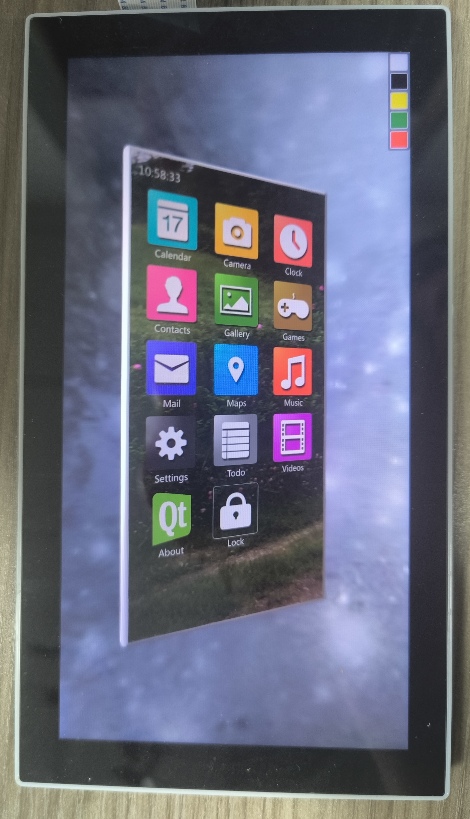

全志 A133 查看Qt 3D 程序 cellphone 运行时 GPU的占用率
QT_QPA_FONTDIR=/usr/share/fonts/ QT_QPA_EVDEV_TOUCHSCREEN_PARAMETERS=/dev/input/event4 QT_QPA_EGLFS_INTEGRATION=none /usr/share/qt5/examples/canvas3d/threejs/cellphone/cellphone
cat /sys/kernel/debug/pvr/status
root@TinaLinux:/# cat /sys/kernel/debug/pvr/status
Driver Status:   OK
Firmware Status: OK
HWR Event Count: 0
CRR Event Count: 0
FWF Event Count: 0
APM Event Count: 77
SLR Event Count: 0
GPU Utilisation: 56%
