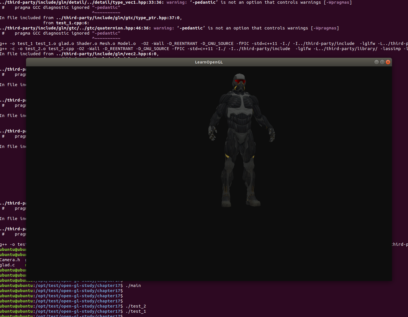

源码地址: https://gitee.com/pengrui2009/open-gl-study
ubuntu编译先安装glfw3: sudo apt-get install libglfw3-dev
Makefile 里面的 third-party/library/libglfw3.a 改成 -lglfw 即可。
