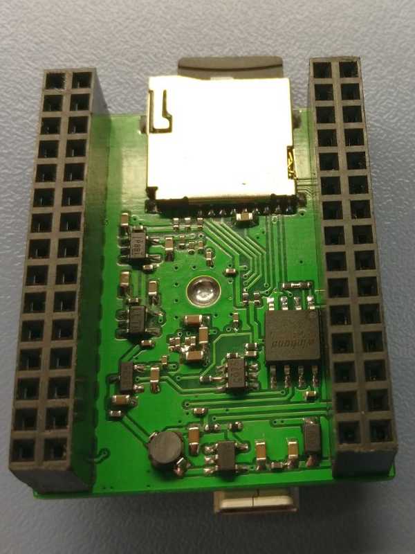

#10 Re: 全志 SOC » Simple F1C100S module » 2023-06-28 16:44:49
sokou wrote:
这是最小系统板?
I used this board to check the power consumption of the processor. This board has two layers. I am currently using f1c_dbc board

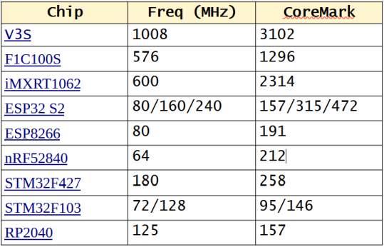

#12 Re: 全志 SOC » CoreMark Benchmark » 2023-06-15 15:02:42
F1C100S CoreMark @ 768MHz: 1729
But do not forget that in addition to processor performance, memory performance is also important.
Allwinner F1C100S Coremark
2K performance run parameters for coremark.
CoreMark Size    : 666
Total ticks      : 14457
Total time (secs): 14.457000
Iterations/Sec   : 1729.266099
Iterations       : 25000
Compiler version : GCC10.3.1 20210824 (release)
Compiler flags   : -O3
Memory location  : STACK
seedcrc          : 0xe9f5
[0]crclist       : 0xe714
[0]crcmatrix     : 0x1fd7
[0]crcstate      : 0x8e3a
[0]crcfinal      : 0xcc42
Correct operation validated. See README.md for run and reporting rules.
CoreMark 1.0 : 1729.266099 / GCC10.3.1 20210824 (release) -O3 / STACK
#13 全志 SOC » CoreMark Benchmark » 2023-06-14 18:54:15
Ozelot
回复: 7
I tested performance of Allwinner's F1C100S and V3S processors on bare metal: F1C100S CoreMark & V3S CoreMark.
Results and comparison with other popular chips:

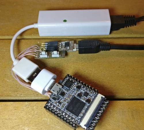

Example of using USB-Ethernet adapter and lwIP-library.
Adapters based on the RTL8152B chip are supported. The driver from u-boot was taken as the base. This program runs on bare metal and depends on the lwIP TCP/IP stack. In this example, the available services are ping, iperf, and http server. At the same time, iperf demonstrated the use of a bandwidth of more than 90Mbits/sec.
Link: GitHub

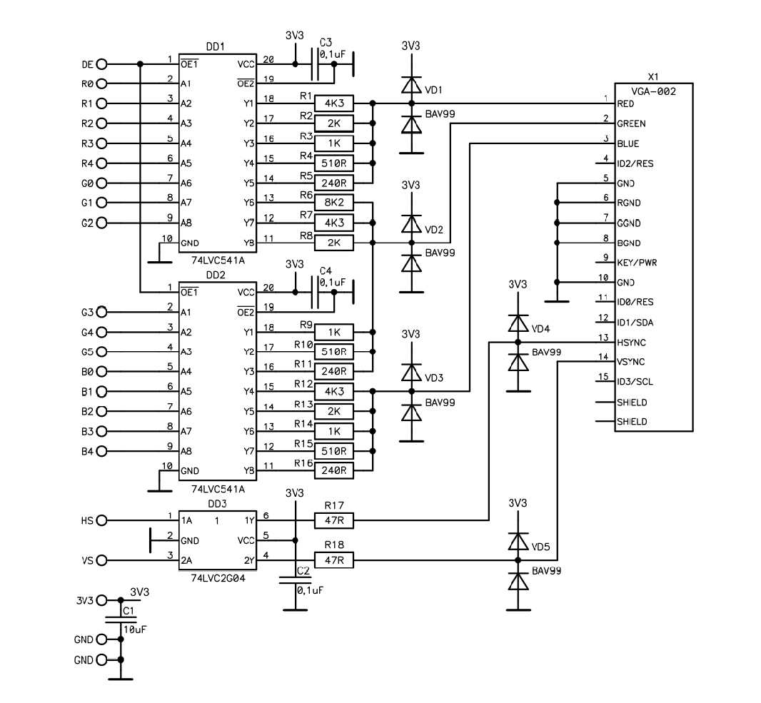

#18 Re: 全志 SOC » VGA module & baremetal programming » 2022-09-27 12:44:08
lottefang wrote:
如果那个DE脚是表示LCD_DE那个脚的话,ARM控制器的LCD_DE是高电平有效。而这个74LVC541A的~OE是低电平有效。我认为这个正好反了吧?
Register TCON->T0_IO_CTRL[0] allows you to set the polarity of the signals.

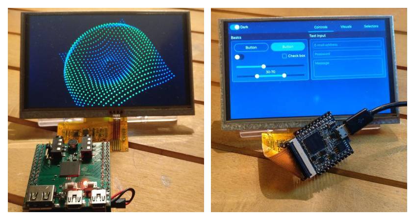

#42 Re: 全志 SOC » VGA module & baremetal programming » 2021-05-20 17:47:38
Demo_2: vga_demo2.7z
Source code supports the following resolutions: lcd_800x480, vga_1366x768, vga_1024x768, vga_800x600, vga_640x480
#43 全志 SOC » VGA module & baremetal programming » 2021-05-14 18:05:44
Ozelot
回复: 12
This is a simple VGA-module: f1c_vga-sch.pdf
Example of baremetal programming: vga_demo.7z
Example of working with VGA and LCD:

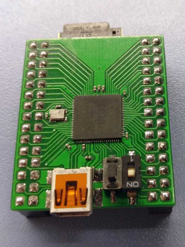

#44 全志 SOC » Simple F1C100S module » 2021-05-11 17:18:35
Ozelot
回复: 4
This is a simple module based on the F1C100S (archive: f1c_cpu.zip)
TOP
BOT
