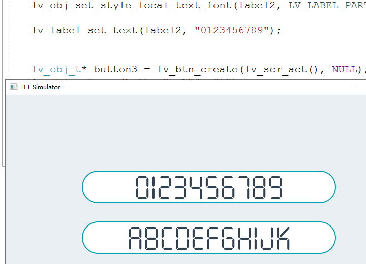

楼主 #6 2020-08-05 09:03:34
明月照我沟渠
注册时间: 2020-07-09
已发帖子: 121
积分: 115
Re: 这种数码管字体 littlevgl / lvgl 计时器/倒计时器 界面如何?
又找到一个段码字体: https://fontmeme.com/fonts/seven-segment-font/
ttf段码字体本站下载: seven-segment.zip
littlevgl 字体生成:
lv_font_conv --no-compress --format lvgl --font "D:\8899\7 Segment.ttf" -o font_segment_64.c --bpp 4 --size 64 --symbols "0123456789abcdefghijklmnopqrstuvwxyzABCDEFGHIJKLMNOPQRSTUVWXYZ " -r 0x20-0x7F
	lv_obj_t* label2 = lv_label_create(button2, NULL);
	lv_obj_set_style_local_text_font(label2, LV_LABEL_PART_MAIN, LV_STATE_DEFAULT, &font_segment_64);
	lv_label_set_text(label2, "0123456789");
	lv_obj_t* button3 = lv_btn_create(lv_scr_act(), NULL);
	lv_obj_set_pos(button3, 150, 250);
	lv_obj_set_size(button3, 500, 64);
	lv_obj_t* label3 = lv_label_create(button3, NULL);
	lv_obj_set_style_local_text_font(label3, LV_LABEL_PART_MAIN, LV_STATE_DEFAULT, &font_segment_64);
	lv_label_set_text(label3, "ABCDEFGHIJK");

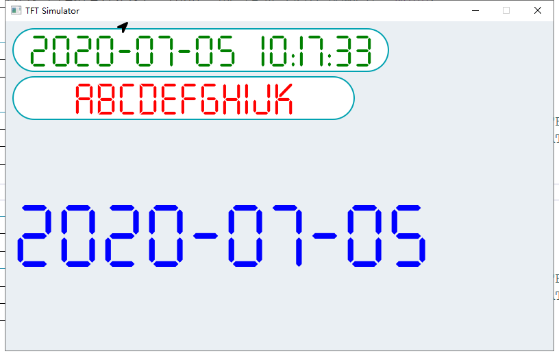

楼主 #7 2020-08-05 10:39:36
明月照我沟渠
注册时间: 2020-07-09
已发帖子: 121
积分: 115
代码:
void lv_test2()
	lv_task_create(task2, 1000, LV_TASK_PRIO_LOWEST, NULL);
	lv_obj_t* button2 = lv_btn_create(lv_scr_act(), NULL);
	lv_obj_set_pos(button2, 10, 10);
	lv_obj_set_size(button2, 550, 64);
	lv_obj_set_style_local_text_color(label2, LV_LABEL_PART_MAIN, LV_STATE_DEFAULT, LV_COLOR_GREEN);
	lv_label_set_text(label2, "2020-07-05 10:17:33");
	lv_obj_set_pos(button3, 10, 80);
	lv_obj_set_style_local_text_color(label3, LV_LABEL_PART_MAIN, LV_STATE_DEFAULT, LV_COLOR_RED);
	lv_obj_t* label4 = lv_label_create(lv_scr_act(), NULL);
	lv_obj_set_pos(label4, 10, 250);
	lv_obj_set_size(label4, 650, 128);
	lv_obj_set_style_local_text_font(label4, LV_LABEL_PART_MAIN, LV_STATE_DEFAULT, &font_segment_128);
	lv_obj_set_style_local_text_color(label4, LV_LABEL_PART_MAIN, LV_STATE_DEFAULT, LV_COLOR_BLUE);
	lv_label_set_text(label4, "2020-07-05");
字体生成:
lv_font_conv --no-compress --format lvgl --font "D:\8899\7 Segment.ttf" -o font_segment_128.c --bpp 4 --size 128 --symbols "0123456789abcdefghijklmnopqrstuvwxyzABCDEFGHIJKLMNOPQRSTUVWXYZ: " -r 0x20-0x7F

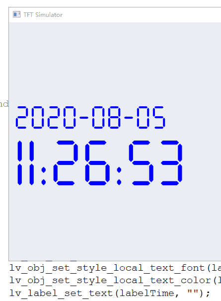

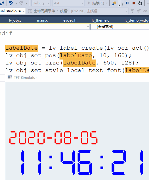

楼主 #8 2020-08-05 11:29:18
明月照我沟渠
注册时间: 2020-07-09
已发帖子: 121
积分: 115
void task2(lv_task_t* task)
	char strdate[16];
	char strtime[16];
	time_t t = time(NULL);
	struct tm tm = *localtime(&t);
	snprintf(strdate, sizeof(strdate) - 1, "%04d-%02d-%02d", tm.tm_year + 1900, tm.tm_mon + 1, tm.tm_mday);
	snprintf(strtime, sizeof(strtime) - 1, "%02d:%02d:%02d", tm.tm_hour, tm.tm_min, tm.tm_sec);
	lv_label_set_text(labelDate, strdate);
	lv_label_set_text(labelTime, strtime);
void lv_test2()
	labelDate = lv_label_create(lv_scr_act(), NULL);
	lv_obj_set_pos(labelDate, 10, 160);
	lv_obj_set_size(labelDate, 650, 128);
	lv_obj_set_style_local_text_font(labelDate, LV_LABEL_PART_MAIN, LV_STATE_DEFAULT, &font_segment_64);
	lv_obj_set_style_local_text_color(labelDate, LV_LABEL_PART_MAIN, LV_STATE_DEFAULT, LV_COLOR_BLUE);
	lv_label_set_text(labelDate, "");
	labelTime = lv_label_create(lv_scr_act(), NULL);
	lv_obj_set_pos(labelTime, 10, 220);
	lv_obj_set_size(labelTime, 650, 128);
	lv_obj_set_style_local_text_font(labelTime, LV_LABEL_PART_MAIN, LV_STATE_DEFAULT, &font_segment_128);
	lv_obj_set_style_local_text_color(labelTime, LV_LABEL_PART_MAIN, LV_STATE_DEFAULT, LV_COLOR_BLUE);
	lv_label_set_text(labelTime, "");
	lv_task_create(task2, 900, LV_TASK_PRIO_LOWEST, NULL);
	//lv_task_ready(task2);

楼主 #10 2020-08-05 11:33:00
明月照我沟渠
注册时间: 2020-07-09
已发帖子: 121
积分: 115
达克罗德 wrote:
这字体真好看
不完美, 因为不等宽.
我去找一个等宽字体看看.

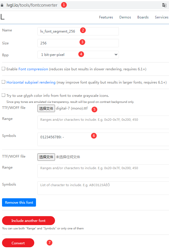

LvglFontTool字体工具更新V0.4版本
https://whycan.com/t_5106.html
也可以用阿里兄这个软件转换。
#21 2022-01-10 20:03:06
memory
注册时间: 2021-08-11
已发帖子: 716
积分: 696
也可以用阿里兄这个软件转换。
LVGL 字库在线生成: https://debugdump.com/topic/935
