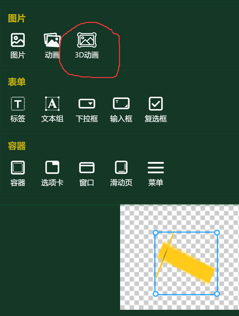

GUI Guider 的 3D 动画是这个软件一帧帧生成的,
widgets_init.c
const lv_img_dsc_t * screen2_image3D_1_imgs[30] = {
    &screen2_image3D_1second_needle_2000,
    &screen2_image3D_1second_needle_2001,
    &screen2_image3D_1second_needle_2002,
    &screen2_image3D_1second_needle_2003,
    &screen2_image3D_1second_needle_2004,
    &screen2_image3D_1second_needle_2005,
    &screen2_image3D_1second_needle_2006,
    &screen2_image3D_1second_needle_2007,
    &screen2_image3D_1second_needle_2008,
    &screen2_image3D_1second_needle_2009,
    &screen2_image3D_1second_needle_2010,
    &screen2_image3D_1second_needle_2011,
    &screen2_image3D_1second_needle_2012,
    &screen2_image3D_1second_needle_2013,
    &screen2_image3D_1second_needle_2014,
    &screen2_image3D_1second_needle_2015,
    &screen2_image3D_1second_needle_2016,
    &screen2_image3D_1second_needle_2017,
    &screen2_image3D_1second_needle_2018,
    &screen2_image3D_1second_needle_2019,
    &screen2_image3D_1second_needle_2020,
    &screen2_image3D_1second_needle_2021,
    &screen2_image3D_1second_needle_2022,
    &screen2_image3D_1second_needle_2023,
    &screen2_image3D_1second_needle_2024,
    &screen2_image3D_1second_needle_2025,
    &screen2_image3D_1second_needle_2026,
    &screen2_image3D_1second_needle_2027,
    &screen2_image3D_1second_needle_2028,
    &screen2_image3D_1second_needle_2029,

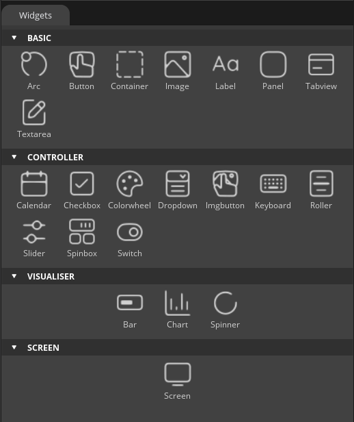

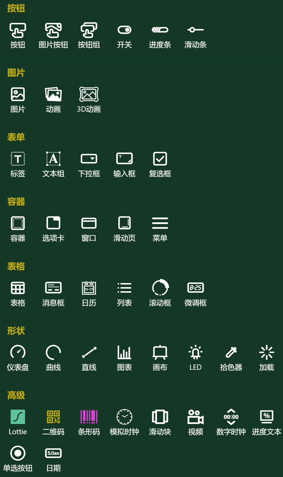

NXP GUI Guider 控件比 squareline 丰富多了!!!
但是 GUI Guider 不能弹性布局,也不能设置对齐方式。
