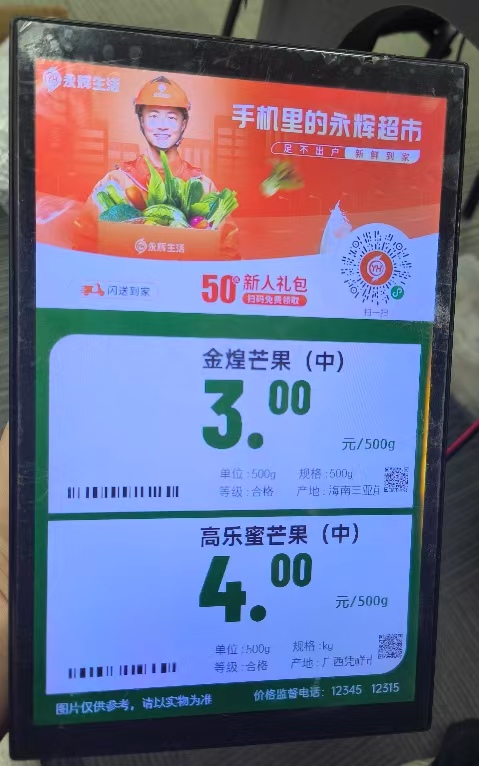

上电(12V)↓:

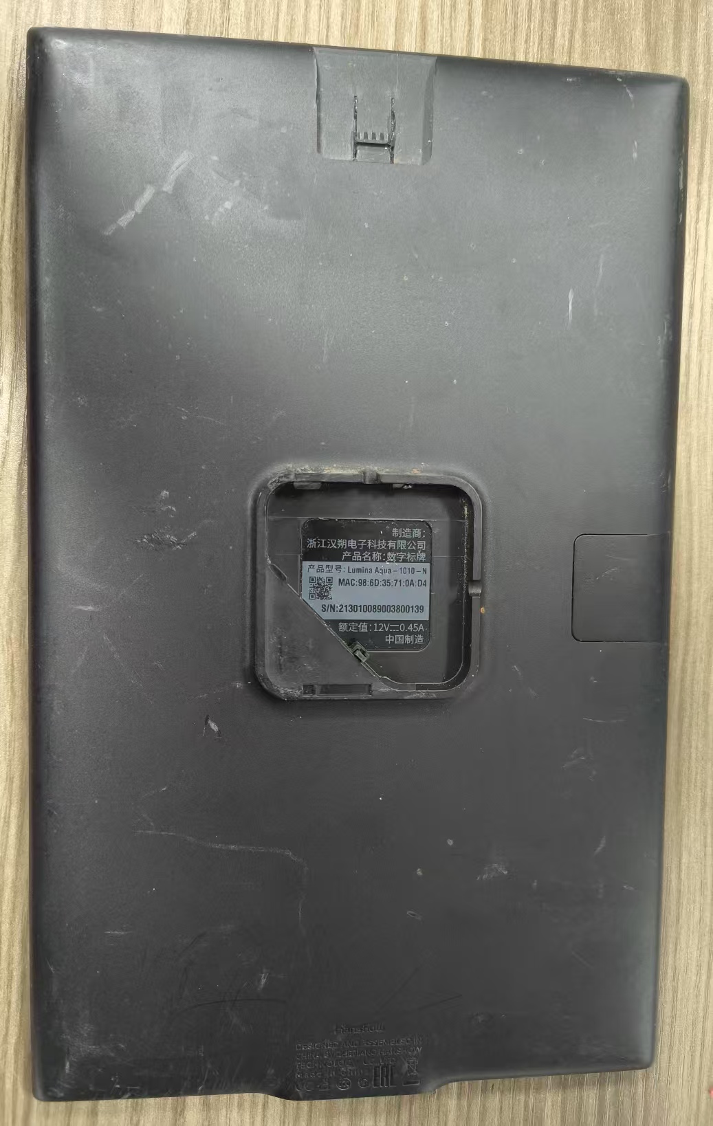

背面↓:

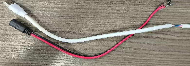

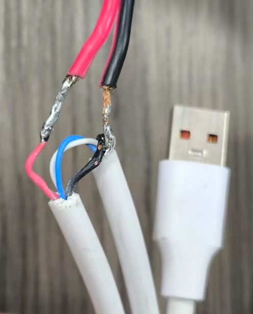

开始自己DIY 12V电源线↓:
DIY线已成↓:

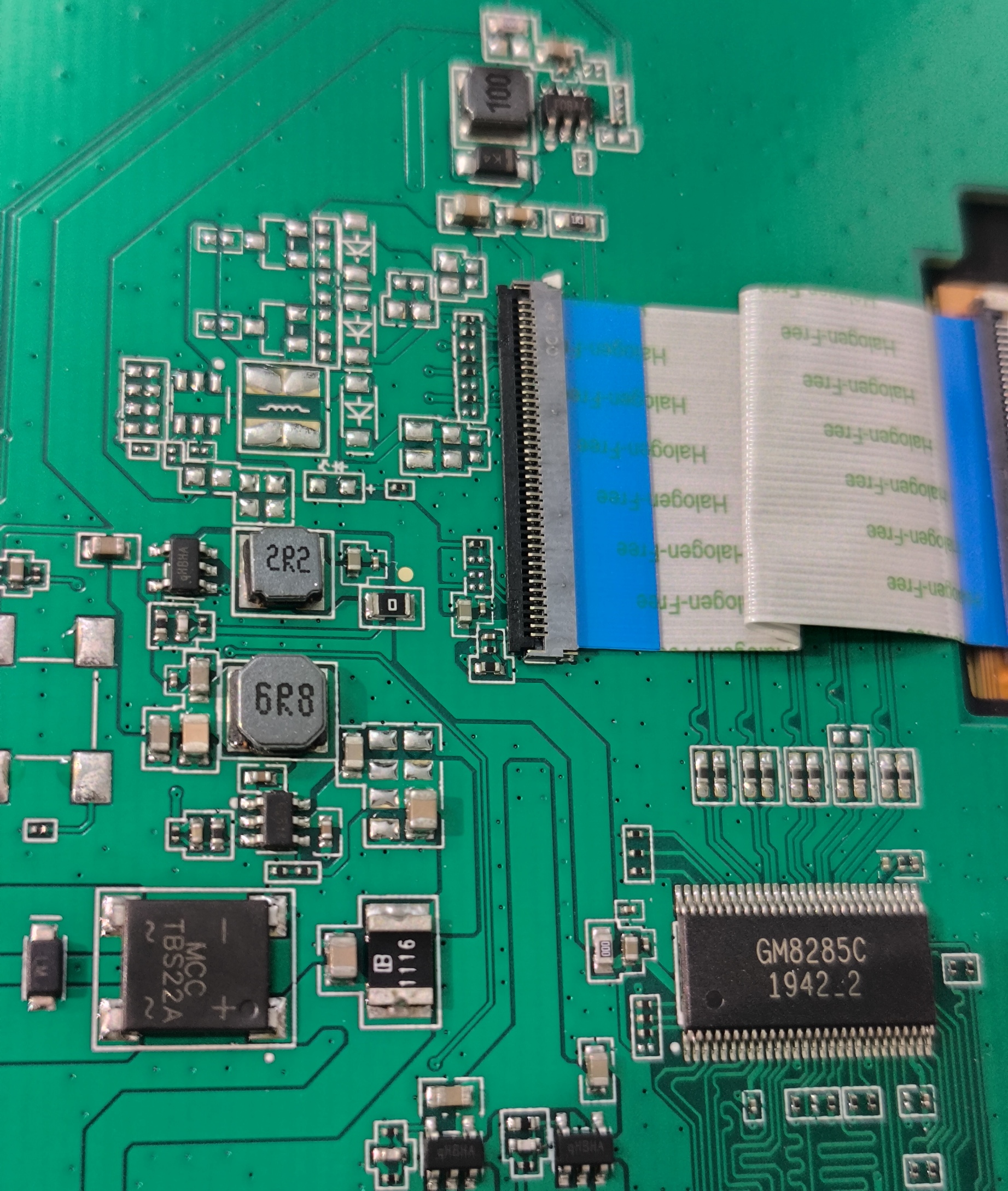

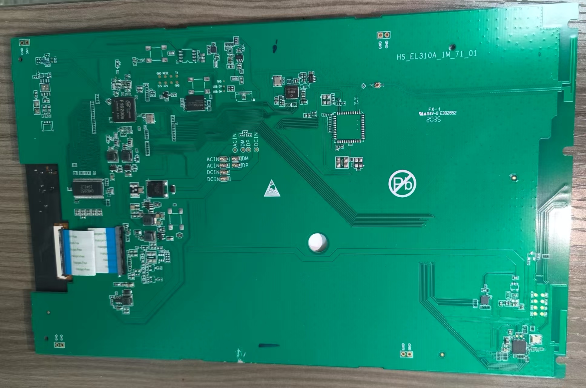

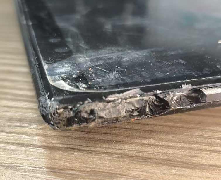

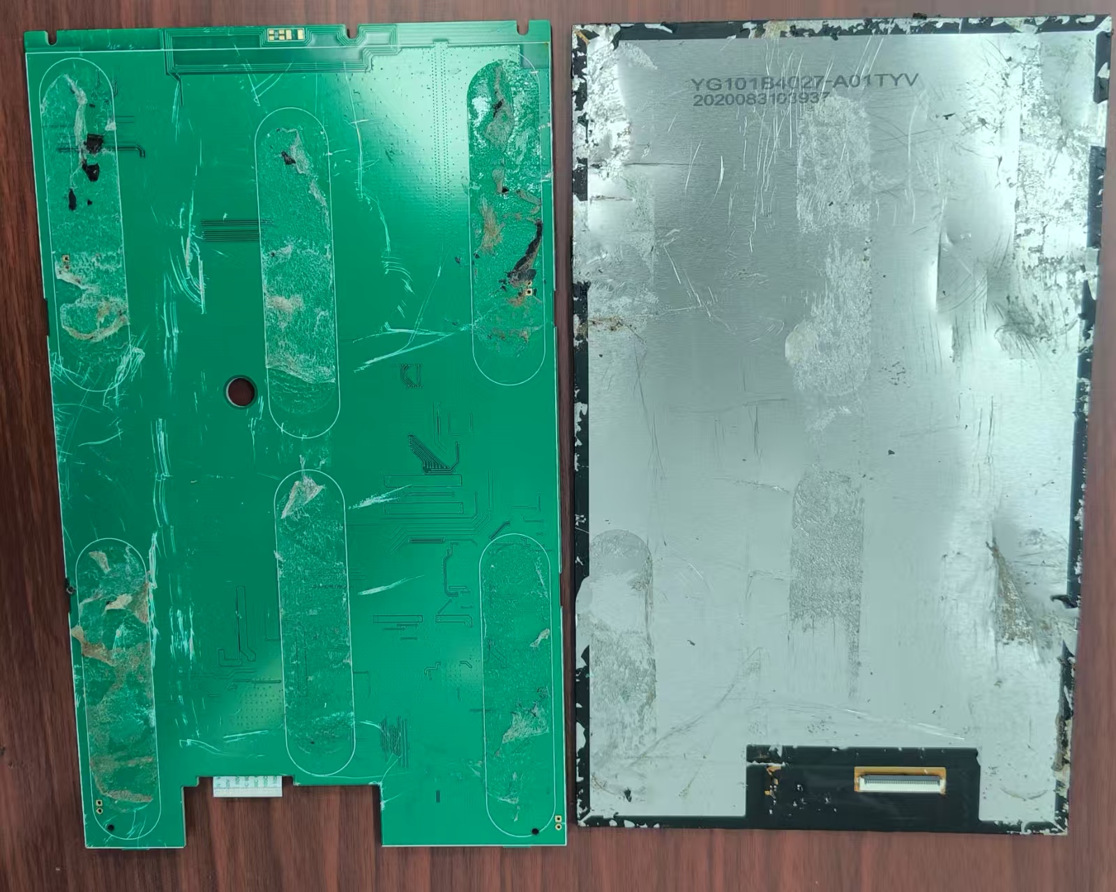

第一次拆,没有经验,应该用热风枪+真空吸盘的↓:
太难拆了↓:

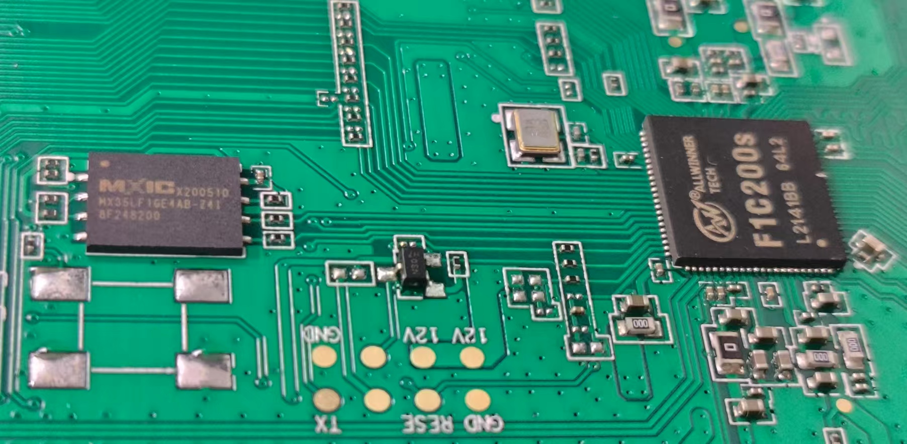

全部启动日志:
[0]HELLO! BOOT0 is starting!
[2]boot0 commit : 80628dcde5dc4ecdc757a9e782c58d7cf1abf959
[60]dram size =64
[62](GPIO_BASE_ADDR + 0x48): 0x00002222
[65](GPIO_BASE_ADDR + 0x5c): 0x00000055
[69](GPIO_BASE_ADDR + 0x64): 0x00000004
[72]CCMU_BASE_ADDR + 0x2c0 0x00104040
[76]CCMU_BASE_ADDR + 0x60 0x00104040
[79]SPIC0_BASE_ADDR+0x24: 0x00001004
[82]spinand UBOOT_START_BLK_NUM 8 UBOOT_LAST_BLK_NUM 58
[87]block from 8 to 58
[568]Check is correct.
[579]Ready to disable icache.
[582]Jump to secend Boot.
U-Boot 2014.07 (Feb 21 2020 - 18:27:46) Allwinner Technology
uboot commit : 8
i2c_init: by cpux
[I2C-DEBUG]:i2c_set_clock() 354
[I2C-ERROR]:twi_send_clk_9pulse() 136 SDA is still Stuck Low, failed.
i2c_init ok
[0.627]pmbus:   ready
axp: get node[/soc/pmu0] error
axp_probe error
[0.633]PMU: cpux 408 Mhz,AXI=408 Mhz
PLL6=600 Mhz,AHB1=200 Mhz, APB1=100Mhz
key value = 4294967295, fel_key = [256,426]
DRAM:  64 MiB

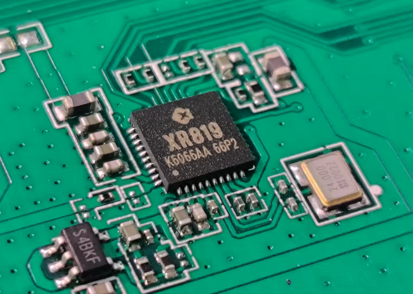

-- run hanshow config --
copy mac.txt to /tmp/xr_wifi.conf success!
copy SN.txt to /usr/product_id success!
-- end --

楼主 #3 2025-01-01 21:07:19
memory
注册时间: 2021-08-11
已发帖子: 716
积分: 696
Re: 45块买到的10.1寸汉朔hanshow价签F1C200S (三)
mac地址来源:
root@TinaLinux:/#
root@TinaLinux:/# ifconfig wlan0
wlan0     Link encap:Ethernet  HWaddr 98:6D:35:71:0A:D4
          collisions:0 txqueuelen:1000
root@TinaLinux:/#
root@TinaLinux:/#
root@TinaLinux:/# cat /mnt/private/ULI/factory/SN.txt
213010089003800139root@TinaLinux:/#
root@TinaLinux:/#
root@TinaLinux:/#
root@TinaLinux:/# cat /mnt/private/ULI/factory/mac.txt
98:6D:35:71:0A:D4root@TinaLinux:/#
root@TinaLinux:/#
root@TinaLinux:/#
