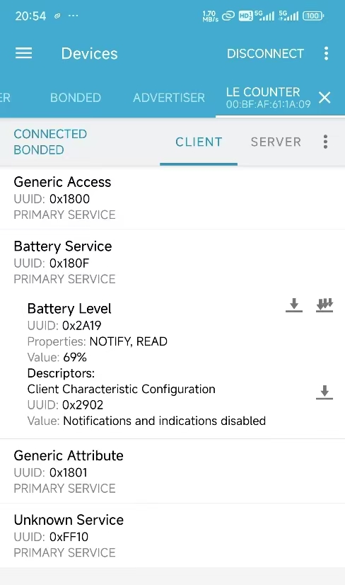

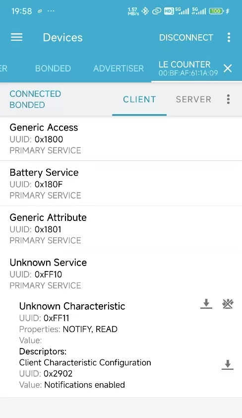

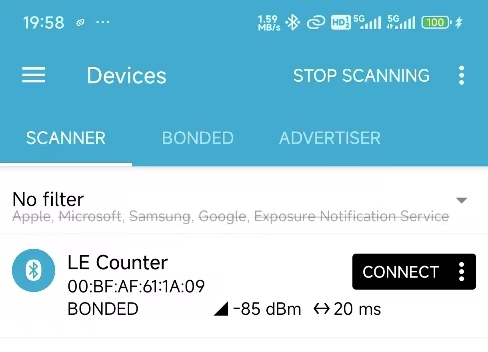

root@TinaLinux:/# /tmp/le_counter
Packet Log: /tmp/hci_dump.pklg
BTstack counter 0001
Local name: RTK_BT_4.1
BTstack up and running at 00:BF:AF:61:1A:09
battery = 63
battery = 62
battery = 61
battery = 60
battery = 5f
battery = 5e
battery = 5d
battery = 5c
battery = 5b
battery = 5a
battery = 59
battery = 58

BTstack up and running on 00:BF:AF:61:1A:09.
连手机测试 gatt_counter :
