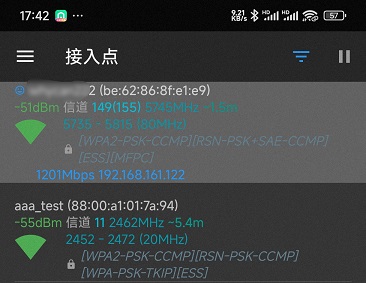

楼主 # 2025-04-26 17:44:35
memory
注册时间: 2021-08-11
已发帖子: 716
积分: 696
发现 rtl8188eu 不支持 acs 自动信道设置,用aic8800dc 试一试
楼主 #1 2025-04-26 17:44:46
memory
注册时间: 2021-08-11
已发帖子: 716
积分: 696
Re: 发现 rtl8188eu 不支持 acs 自动信道设置,用aic8800dc 试一试
$ lsusb
Bus 001 Device 003: ID a69c:88dc
hostapd.conf
interface=wlx8800a1017a94
driver=nl80211
ssid=aaa_test
channel=0
hw_mode=g
macaddr_acl=0
ignore_broadcast_ssid=0
auth_algs=1
wpa=3
wpa_passphrase=12345678
wpa_key_mgmt=WPA-PSK
wpa_pairwise=TKIP
rsn_pairwise=CCMP
固件复制到:/lib/firmware/aic8800DC/
sudo insmod ./aic_load_fw/aic_load_fw.ko
sudo insmod ./aic8800_fdrv/aic8800_fdrv.ko
ubuntu@ubuntu:/opt/hostapd$  sudo ifconfig wlx8800a1017a94 192.168.88.1
ubuntu@ubuntu:/opt/hostapd$ sudo killall wpa_supplicant
ubuntu@ubuntu:/opt/hostapd$ sudo hostapd -d hostapd.conf

ACS: Automatic channel selection started, this may take a bit
ACS: Scanning 1 / 5
wlx8800a1017a94: nl80211: scan request
Scan requested (ret=0) - scan timeout 10 seconds
wlx8800a1017a94: interface state UNINITIALIZED->ACS
wlx8800a1017a94: ACS-STARTED
Interface initialization will be completed in a callback (ACS)

ACS: Ideal channel is 11 (2462 MHz) with total interference factor of 0.113853
wlx8800a1017a94: ACS-COMPLETED freq=2462 channel=11
Completing interface initialization
Mode: IEEE 802.11g  Channel: 11  Frequency: 2462 MHz
DFS 0 channels required radar detection
选中了11信道
