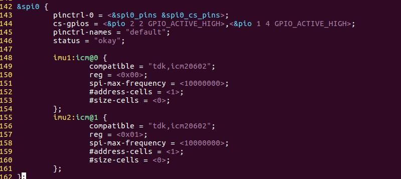

Re: H5的spi控制器驱动, 可以通过 gpio 控制 spi 片选 (转载)

在板级主要的设备树文件 arch/arm64/boot/dts/allwinner/sun50i-h5-nanopi-neo2.dts:
&pio {
    spi0_cs_pins: spi0_cs_pins {
        pins = "PC3", "PA6";
        function = "gpio_out";
&spi0 {
    /* needed to avoid dtc warning */
    #address-cells = <1>;
    #size-cells = <0>;
    pinctrl-names = "default";
    pinctrl-0 = <&spi0_pins &spi0_cs_pins>;
    cs-gpios = <&pio 2 3 GPIO_ACTIVE_HIGH>, <&pio 0 6 GPIO_ACTIVE_HIGH>;

也就说,理论上V3s也 可以通过配置设备树, 使用 gpio 完成片选, 实现 SPI 复用。

感谢QQ群的 @龙涎香 网友, ta 在 2019/07/09 18:27:40
验证过了,是可以的,多路复用.

也就是说,我现在用SPI FLASH作为S3/V3s的存储器, 还能挂一个ST7789这种SPI LCD吗?
#9 2020-07-02 16:46:05
已发帖子: 3,409
积分: 1907
可以, 亲测可用。
https://whycan.cn/t_4774.html#p48764
&pio {
                pins = "PC3", "PH6";
&spi0 {
        status ="okay";
        cs-gpios = <&pio 2 3 GPIO_ACTIVE_HIGH>, <&pio 7 6 GPIO_ACTIVE_HIGH>;
        mx25l25635e:mx25l25635e@0 {
                compatible = "jedec,spi-nor";
                reg = <0x0>;
                #size-cells = <1>;
    panel@0 {
            reg = <1>;
            reset-gpios = <&pio 2 4 GPIO_ACTIVE_HIGH>;//PC4
            dc-gpios = <&pio 2 7 GPIO_ACTIVE_LOW>;//PC7
            /*backlight = <&pwm_bl>;*/
            led-gpios = <&pio 7 0 GPIO_ACTIVE_LOW>;//PH0
            spi-cpol;
            spi-cpha;
            buswidth = <8>;
            rotate = <270>;
            rgb;
            fps = <30>;
            debug = <1>;
