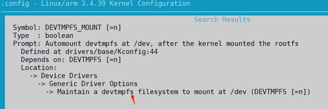

求助,overlayfs 应该在什么地方进行切换根目录
请教下,切换根目录应该在哪一步切换,povit_root /merged /merged/rom。我尝试了在inittab中,执行rcS之前,执行是对的,但就是一直报 can't open /dev/console: No such file or directory和can't open /dev/ttyGS0: No such file or directory

::sysinit:/sbin/modprobe r8723bs
# now run any rc scripts
::sysinit:mount -n -t overlay overlayfs:/overlay -o lowerdir=/,upperdir=/overlay/upper,workdir=/overlay/workdir /merged/
::sysinit:pivot_root /merged /merged/rom
::sysinit:/etc/init.d/rcS

[    1.133930] VFS: Mounted root (squashfs filesystem) readonly on device 31:3.
[    1.145509] devtmpfs: mounted
[    1.153006] Freeing unused kernel memory: 1024K
[    1.396362] random: crng init done
[    2.253216] overlayfs: upper fs does not support tmpfile.
[    2.258645] overlayfs: upper fs does not support xattr.
[    2.263967] overlayfs: upper fs does not support file handles, falling back to index=off.

貌似切换后,/dev目录中的各个设备没有自动复制底层的/dev/,因此没有console之类的,也没有ttyS*,查了很多文章,需要把/dev中的加载到新的/dev中
mount -n /proc -o noatime,--move /merged/proc
mount -n /rom/dev -o noatime,--move /dev
mount -n /rom/tmp -o noatime,--move /tmp
mount -n /rom/sys -o noatime,--move /sys
mount -n /rom/overlay -o noatime,--move /overlay
我再试试看

@阿黄
https://www.jianshu.com/p/e24f9fc39008
最后到也不了登录界面,一直为:can't open /dev/console: No such file or directory,解决方法是配置CONFIG_DEVTMPFS_MOUNT
