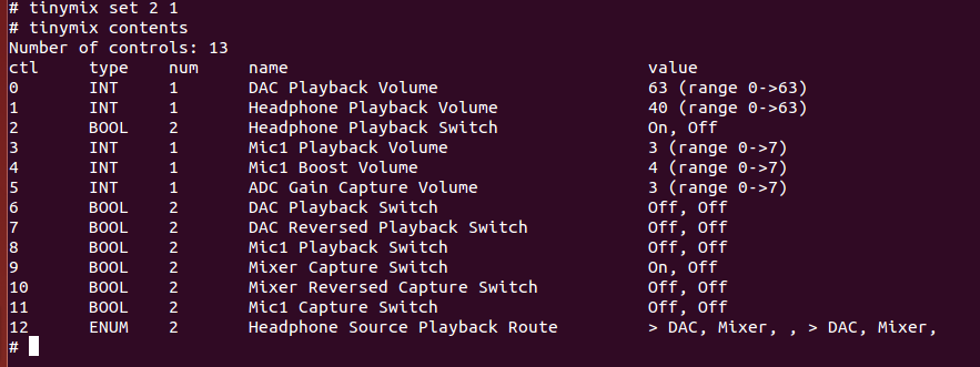

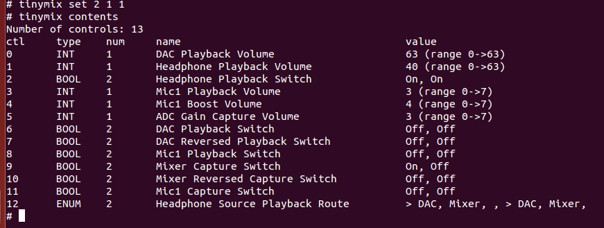

./tinymix set 1 63
./tinymix set 2 1
./tinymix contents
Number of controls: 13
ctl type num name value
0 INT 1 DAC Playback Volume 63 (range 0->63)
1 INT 1 Headphone Playback Volume 63 (range 0->63)
2 BOOL 2 Headphone Playback Switch On, On
3 INT 1 Mic1 Playback Volume 3 (range 0->7)
4 INT 1 Mic1 Boost Volume 4 (range 0->7)
5 INT 1 ADC Gain Capture Volume 3 (range 0->7)
6 BOOL 2 DAC Playback Switch Off, Off
7 BOOL 2 DAC Reversed Playback Switch Off, Off
8 BOOL 2 Mic1 Playback Switch Off, Off
9 BOOL 2 Mixer Capture Switch Off, Off
10 BOOL 2 Mixer Reversed Capture Switch Off, Off
11 BOOL 2 Mic1 Capture Switch Off, Off
12 ENUM 2 Headphone Source Playback Route , DACMixer, , DACMixer
./tinyplay 14_00.wav
failed to open for pcm 0,0

我看了一下源码utils/tinyplay.c
在这里出错 pcm_is_ready,
看来是驱动问题,
你的内核是不是 4.13-y ?

为什么我的用mplayer播放mp3只有一边耳机响?你们的也是这样的吗?我内核是4.13-y
自己解决了,原来./tinymix set 2 1只打开了单声道,./tinymix set 2 1 1这样才是打开双声道。
