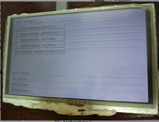

#15 2018-04-26 14:28:40
已发帖子: 9,513
Re: AllWinner全志V3s荔枝派zero板子用W25Q256,发现我烧文件系统之后,串口无输出, 直接进入芯片内部的fel
正好有个W25Q256开发板,我来试一试:
hexing@ubuntu:/tmp/ccc$ sudo sunxi-fel spiflash-info
Manufacturer: Winbond (EFh), model: 40h, size: 33554432 bytes.
hexing@ubuntu:/tmp/ccc$ sudo sunxi-fel -p spiflash-write 0 /mnt/hgfs/E/V3s_W25Q256_Qt5.9.1.bin
2% [ ] 49.8 kB/s, ETA 11:03
#16 2018-04-26 14:50:07
已发帖子: 9,513
一切正常!
