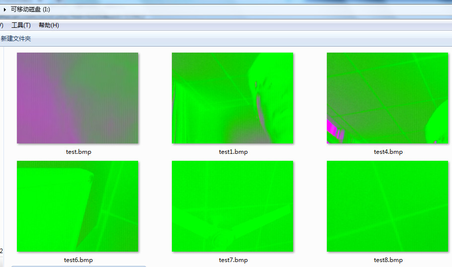

哇酷小二 wrote:
楼主今天有重大更新,可以关注一下。
fswebcam -d /dev/video0 -S 3 test1.bmp
发现颜色有点不对劲 : (
#14 2020-09-25 09:28:55
已发帖子: 3,409
积分: 1907
Re: buildroot-tiny200 (F1C100/200s) 开发包近期更新内容 * 已支持DVP摄像头 *,支持SPI NAND
only_you wrote:
哇酷小二 wrote:
楼主今天有重大更新,可以关注一下。
/files/members/5231/2020-09-25_091849.jpg
发现颜色有点不对劲 : (
我记得fswebcam要加一个-p UYVY参数
#15 2020-09-25 09:43:30
only_you
注册时间: 2020-09-25
哇酷小二 wrote:
发现颜色有点不对劲 : (
fswebcam -d /dev/video0 -S 3 -p UYVY test19.bmp
谢谢大佬, 搞定, 非常好用。

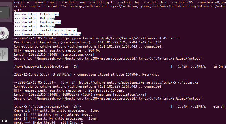

我直接使用晕哥网站的离线包 buildroot-tiny200-20200924.tgz,检出git资源,然后执行了以下操作:
(1)make widora_mangopi_r3_defconfig
(2)make
最终,出现以下错误信息,请问是我这里环境出现问题,还是作者的buildroot资源问题呢?
YACC    scripts/dtc/dtc-parser.tab.[ch]
  HOSTCC  scripts/dtc/dtc-lexer.lex.o
  HOSTCC  scripts/dtc/dtc-parser.tab.o
  HOSTLD  scripts/dtc/dtc
  HOSTCC  scripts/kallsyms
  UPD     include/generated/utsrelease.h
  HOSTCC  scripts/conmakehash
  HOSTCC  scripts/sortextable
  DTC     arch/arm/boot/dts/suniv-f1c100s-licheepi-nano.dtb
arch/arm/boot/dts/suniv-f1c100s.dtsi:501.21-512.5: ERROR (phandle_references): /soc/i2c@1c27000: Reference to non-existent node or label "i2c0_pins"
ERROR: Input tree has errors, aborting (use -f to force output)
scripts/Makefile.lib:285: recipe for target 'arch/arm/boot/dts/suniv-f1c100s-licheepi-nano.dtb' failed
make[3]: *** [arch/arm/boot/dts/suniv-f1c100s-licheepi-nano.dtb] Error 2
Makefile:1269: recipe for target 'dtbs' failed
make[2]: *** [dtbs] Error 2
make[2]: *** 正在等待未完成的任务....
  HOSTCC  scripts/asn1_compiler
  HOSTCC  scripts/extract-cert
package/pkg-generic.mk:266: recipe for target '/home/book/HDD/Disk0/Document/StudyData/F1C100s/tiny200s-buildroot/output/build/linux-5.4.66/.stamp_built' failed
make[1]: *** [/home/book/HDD/Disk0/Document/StudyData/F1C100s/tiny200s-buildroot/output/build/linux-5.4.66/.stamp_built] Error 2
Makefile:84: recipe for target '_all' failed
make: *** [_all] Error 2
亲,这边建议直接拉取一个新鲜的呢
aodzip wrote:
亲,这边建议直接拉取一个新鲜的呢
拉取了新鲜的buildroot,果然ok了,准备下载进去看看。

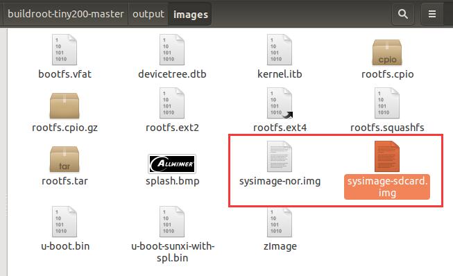

从./output/image/文件夹里看到了很多个img/bin文件:
output/images$ ls
bootfs.vfat        rootfs.ext2           sysimage-nor.img
devicetree.dtb     rootfs.ext4           sysimage-sdcard.img
flasher.vfat       rootfs.squashfs       u-boot.bin
rootfs.cpio        rootfs.tar            u-boot-sunxi-with-nand-spl.bin
rootfs.cpio.gz     sysimage-flasher.img  u-boot-sunxi-with-spl.bin
rootfs.cpio.uboot  sysimage-nand.img     zImage
请问可以描述一下各个文件是何作用吗?我应该如何烧写spi nand呢?应该不用上编程烧录器吧!/手动笑!

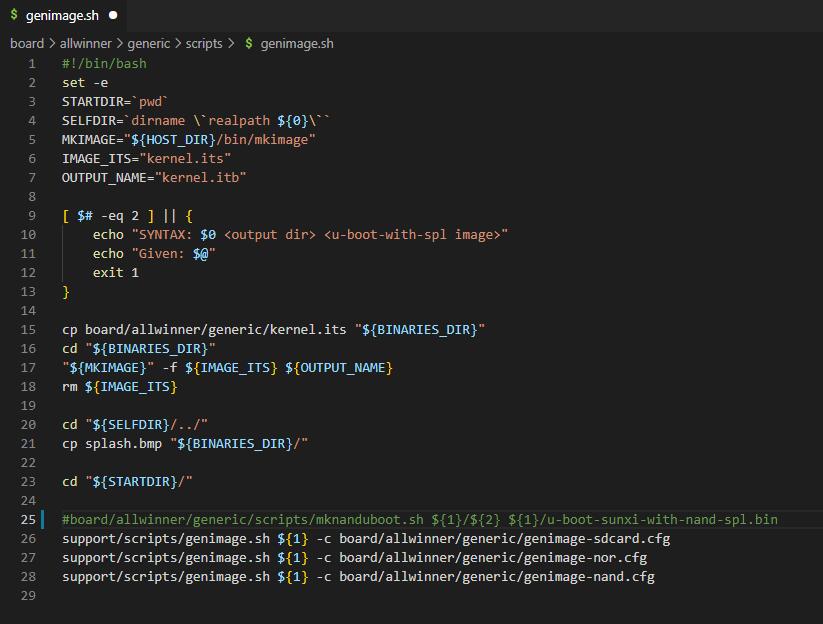

请问如果我添加了一个开机画面文件: board/widora/mangopi/r3/splash.png
应该如何拷贝到 output/images 呢?
修改 board/allwinner/suniv-f1c100s/scripts/genimage.sh 这个文件吗?
#34 2020-10-19 14:18:04
路人甲
注册时间: 2017-09-07
已发帖子: 202
积分: 199.5
可以的, 我就是这么干的
修改 board/allwinner/suniv-f1c100s/scripts/genimage.sh:
#!/bin/bash
set -e
SELFDIR=`dirname \`realpath ${0}\``
[ $# -eq 2 ] || {
    echo "SYNTAX: $0 <u-boot-with-spl image> <genimage.cfg>"
    echo "Given: $@"
    exit 1
cp ${SELFDIR}/../splash/splash.bmp ${1}/ -rf
${SELFDIR}/mknanduboot.sh ${1}/${2} ${1}/u-boot-sunxi-with-nand-spl.bin
support/scripts/genimage.sh ${1} -c board/allwinner/sun8i-v3s/genimage-sdcard.cfg
support/scripts/genimage.sh ${1} -c board/allwinner/sun8i-v3s/genimage-nor.cfg
support/scripts/genimage.sh ${1} -c board/allwinner/sun8i-v3s/genimage-nand.cfg
support/scripts/genimage.sh ${1} -c board/allwinner/sun8i-v3s/genimage-flasher.cfg
添加这一行: cp ${SELFDIR}/../splash/splash.bmp ${1}/ -rf
然后 board/allwinner/sun8i-v3s/genimage-sdcard.cfg 添加一行 splash.bmp 就可以了。

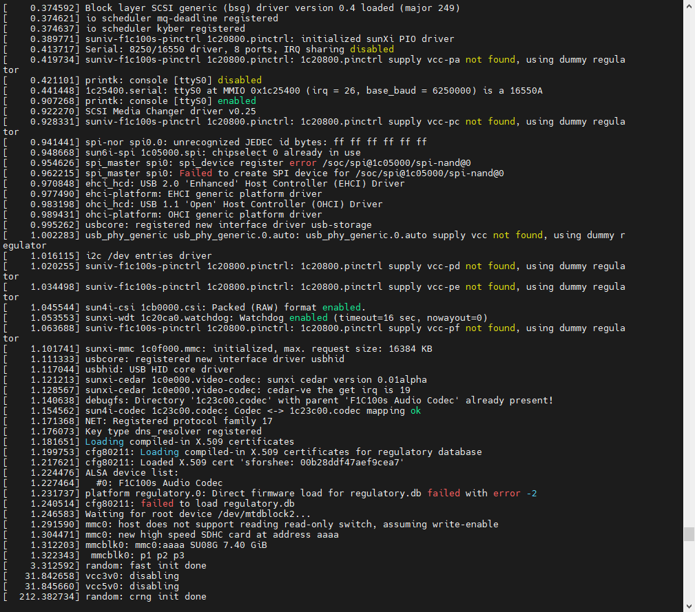

按照您的提示重新编译后
i2cdetect -l
i2c-0 i2c mv64xxx_i2c adapter I2C adapter
export TSLIB_TSDEVICE=/dev/input/event1
ts_test
ts_open: No such file or directory
ts_calibrate
ts_setup: No such file or directory
还是同样的问题

日志有没有出现 tsc2007 设备? 是不是 /dev/input/event1 ?

是的,启动日志没有tsc2007,在/dev/下也没有input

检查 "board/allwinner/suniv-f1c100s/linux.defconfig"
有没有勾选
CONFIG_TOUCHSCREEN_TSC2007
这个文件是否存在:
output/target/lib/modules/5.4.66/kernel/drivers/input/touchscreen/tsc2007.ko
再执行 ./rebuild-kernel.sh & make

检查board/allwinner/suniv-f1c100s/linux.defconfig
CONFIG_TOUCHSCREEN_TSC2007=m
存在output/target/lib/modules/5.4.66/kernel/drivers/input/touchscreen/tsc2007.ko
tiny200上的是NS2009触摸芯片,是不是应该检查ns2009驱动呢?

ns2009指令与tsc2003/tsc2007兼容, 很可能就是逆(po)向(jie)设计的。

执行如下命令还是出现错误
ts_test
ts_calibrate

检查驱动/设备树/硬件等,log都没出现tsc2007,你在应用层再努力有什么用呢?

向天笑 wrote:
  1. 修改u-boot lcd 的分辨率
    直接改这个文件: "board/widora/mangopi/r3/uboot.defconfig", 然后执行 ./rebuild-uboot.sh & make
  2. 打包是这个文件 board/allwinner/suniv-f1c100s/scripts/genimage.sh
配置文件:

redstar wrote:
你现在想完成什么功能?
#60 2020-10-25 22:02:22
已发帖子: 3,409
积分: 1907
gubaoyl wrote:
编译打包
烧录
第一步,想这么用起来。
redstar wrote:
你现在想完成什么功能?
①windows平台用win32diskimager, ②linux平台用dd命令把 output/images/sysimage-sdcard.img 烧到tf卡即可.
#61 2020-10-25 22:34:31
gubaoyl
注册时间: 2020-10-17
已发帖子: 20
积分: 20
谢谢,原来最终包都生成好了。

哇酷小二 wrote:
gubaoyl wrote:
编译打包
烧录
第一步,想这么用起来。
redstar wrote:
你现在想完成什么功能?
最近编辑记录 gubaoyl (2020-10-25 22:43:46)

linux小白求助,DL文件夹已经下载好放入主目录了,但是编译到最后还是出现下载100多M的文件包是啥原因?

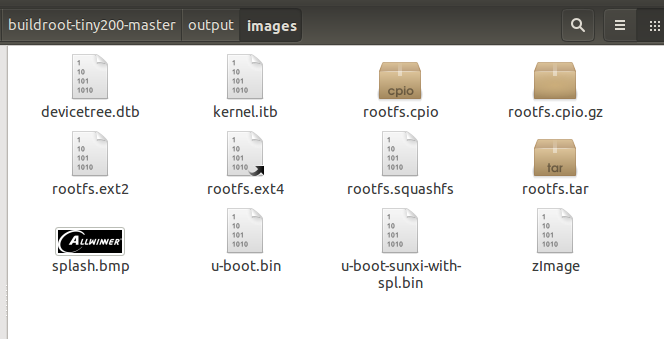

请教一下老哥,这个编译成功后在显示这些是什么意思,文件的下载地址吗?
INFO: cmd: "mkdir -p "/home/xiang/linux/buildroot-tiny200/output/images"" (stderr):
INFO: flash(sysimage-nor.img): writing image partition 'u-boot' (0x80000@0x0)
INFO: flash(sysimage-nor.img): writing image partition 'splash' (0x80000@0x80000)
INFO: flash(sysimage-nor.img): writing image partition 'kernel' (0x500000@0x100000)
INFO: flash(sysimage-nor.img): writing image partition 'rom' (0xa00000@0x600000)
board/allwinner/generic/genimage-nand.cfg:33: no sub-section title/index for 'config'
INFO: cmd: "mkdir -p "/home/xiang/linux/buildroot-tiny200/output/build/genimage.tmp"" (stderr):
INFO: cmd: "rm -rf "/home/xiang/linux/buildroot-tiny200/output/build/genimage.tmp"/*" (stderr):
INFO: cmd: "cp -a "/tmp/tmp.tQn4VicX1u" "/home/xiang/linux/buildroot-tiny200/output/build/genimage.tmp/root"" (stderr):
INFO: cmd: "find '/home/xiang/linux/buildroot-tiny200/output/build/genimage.tmp/root' -depth -type d -printf '%P\0' | xargs -0 -I {} touch -r '/tmp/tmp.tQn4VicX1u/{}' '/home/xiang/linux/buildroot-tiny200/output/build/genimage.tmp/root/{}'" (stderr):
INFO: flash(sysimage-nand.img): writing image partition 'u-boot' (0x80000@0x0)
INFO: flash(sysimage-nand.img): writing image partition 'splash' (0x80000@0x80000)
INFO: flash(sysimage-nand.img): writing image partition 'kernel' (0x500000@0x100000)
INFO: flash(sysimage-nand.img): writing image partition 'rom' (0x7a00000@0x600000)
然后在output\images\生成的文件是啥意思,咋使用。

老哥,我使用你上面说的命令生成bmp图像直接打不开阿,成jpg打开是花的,这是什么情况阿。是我那里需要修改一下吗.图片传不上来,我是这样执行的。
fswebcam -d /dev/video0 -S 3 -p UYVY test.bmp
--- Opening /dev/video0...
Trying source module v4l2...
/dev/video0 opened.
--- Capturing frame...
Skipping 3 frames...
Capturing 1 frames...
Captured 4 frames in 0.12 seconds. (34 fps)
--- Processing captured image...
Unable to load font 'sans': Could not find/open font
Disabling the the banner.
Writing JPEG image to 'test.bmp'.
[ 588.638546] configfs-gadget gadget: high-speed config #1: c
fswebcam -d /dev/video0 -S 3 -p UYVY test.jpg
/dev/video0 opened.
Captured 4 frames in 0.21 seconds. (19 fps)
Writing JPEG image to 'test.jpg'.
[ 623.712339] configfs-gadget gadget: high-speed config #1: c

编译到最后提示出现如下错误,不知又是什么原因? 看output目录里面已经有一些生成的文件,有zImage,但没有uImage

把 \buildroot-tiny200\board\allwinner\generic\scripts\genimage.sh 中生成 u-boot-sunxi-with-nand-spl.bin 的调用屏蔽掉后,
重新运行make,就能生成 sysimage-nor.img 和 sysimage-sdcard.img 文件,
虽然生成sysimage-nand.img还是提示失败,但板子没有用到nand,所以先不关心这个。

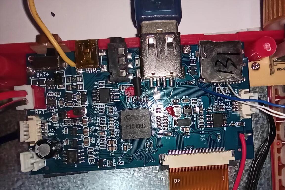

问题又来了, 用 dd 命令把 sysimage-sdcard.img 写到TF卡中,插到之前在淘宝买的老人唱戏机,感觉没什么反应。
UART0 和 SD卡 有部分端口共用, 所以也看不了串口是否有输出。
具体 dd 命令
 sudo dd if=sysimage-sdcard.img of=/dev/sdb
老人唱戏机

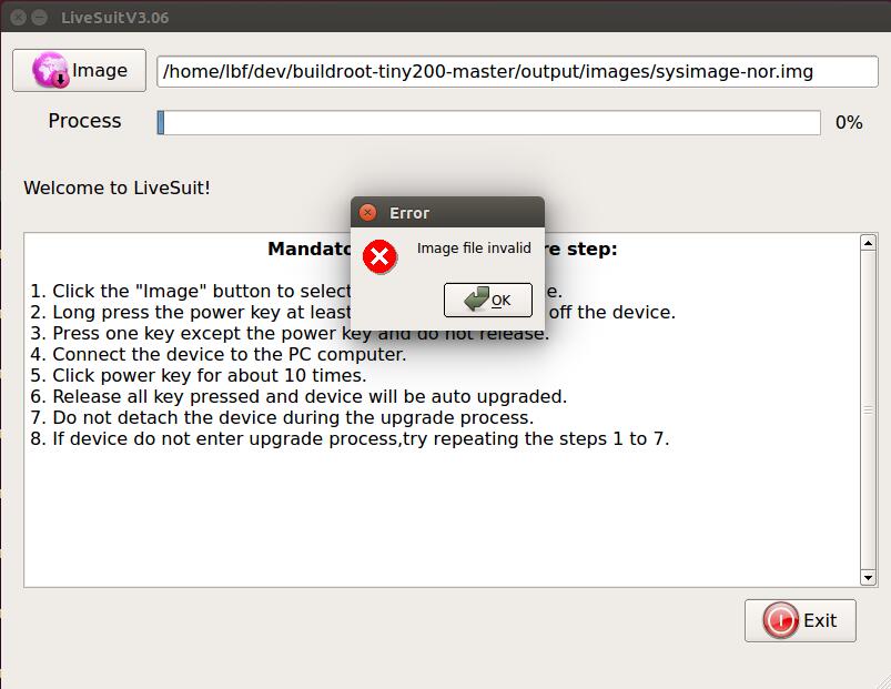

想着把 sysimage-nor.img 写到板子的SPI FLASH中,看是否有反应,谁知 LiveSuit 直接提示文件格式无效, 选择 sysimage-sdcard.img 也是同样提示,
不知道生成的文件是否有问题?

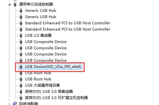

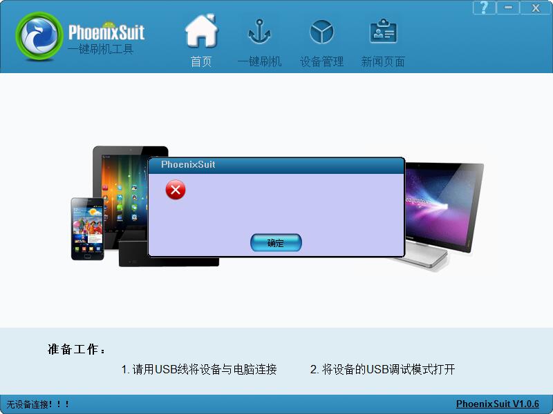

接上面,不插TF卡, 插入USB接到电脑,设备管理是能检测到新增的USB设备的,但是PhoenixSuit会自动弹出错误框。
大虾们,接下来该如何弄呢?脑瓜痛!
PhoenixSuit 提示错误

在output/image/文件夹里面已经生成了4个文件,
 $ ls
devicetree.dtb  u-boot.bin  u-boot-sunxi-with-spl.bin  zImage
慢慢研究了,是不是可以直接把这4个文件打包或直接烧录到SpiFlash去测试,好像之前编译的时候,就是这几个文件用buildroot打一下包。

没有其他环境的安装操作,dl文件夹是自己下载的,没有复制进去。经过一夜的编译,正确的生成了目标文件。环境很重要,不能使用ubuntu 22.04。
zl@ubuntu:~/f1c200s/buildroot-tiny200/output/images$ ls -l
total 260912
-rw-r--r-- 1 zl zl   8388608 Feb  4 19:59 bootfs.vfat
-rw-r--r-- 1 zl zl     15666 Feb  4 19:35 devicetree.dtb
-rw-r--r-- 1 zl zl   4326936 Feb  4 19:59 kernel.itb
-rw-r--r-- 1 zl zl  18583040 Feb  4 19:59 rootfs.cpio
-rw-r--r-- 1 zl zl   5970377 Feb  4 19:59 rootfs.cpio.gz
-rw-r--r-- 1 zl zl 104857600 Feb  4 19:59 rootfs.ext2
lrwxrwxrwx 1 zl zl        11 Feb  4 19:59 rootfs.ext4 -> rootfs.ext2
-rw-r--r-- 1 zl zl   6021120 Feb  4 19:59 rootfs.squashfs
-rw-r--r-- 1 zl zl  19671040 Feb  4 19:59 rootfs.tar
-rw-r--r-- 1 zl zl     94514 Feb  4 19:59 splash.bmp
-rw-r--r-- 1 zl zl 134217728 Feb  4 19:59 sysimage-nand.img
-rw-r--r-- 1 zl zl  16777216 Feb  4 19:59 sysimage-nor.img
-rw-r--r-- 1 zl zl 114294784 Feb  4 19:59 sysimage-sdcard.img
-rw-r--r-- 1 zl zl    451858 Feb  4 19:59 u-boot-sunxi-with-nand-spl.bin
-rw-r--r-- 1 zl zl    431378 Feb  4 19:19 u-boot-sunxi-with-spl.bin
-rw-r--r-- 1 zl zl    398546 Feb  4 19:19 u-boot.bin
-rw-r--r-- 1 zl zl   4309472 Feb  4 19:35 zImage
