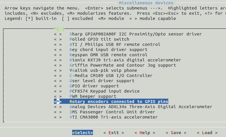

  1. make menuconfig
勾选旋转编码器驱动:
              Device Drivers  --->      Input device support  --->  Miscellaneous devices
--->     <*>   Rotary encoders connected to GPIO pins

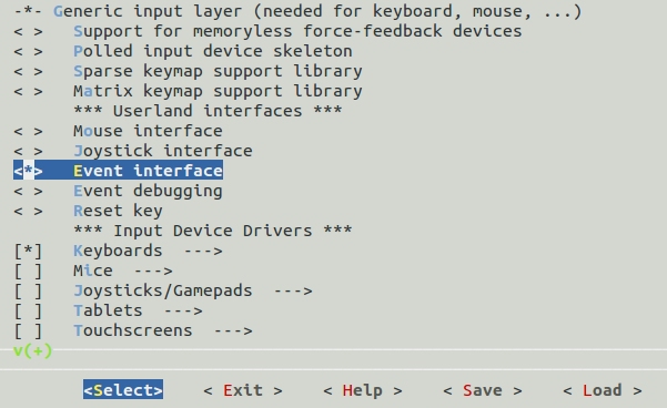

选中用户接口, 使驱动产生 /dev/input/eventX 设备
              Device Drivers  --->      Input device support  --->    <*>   Event interface

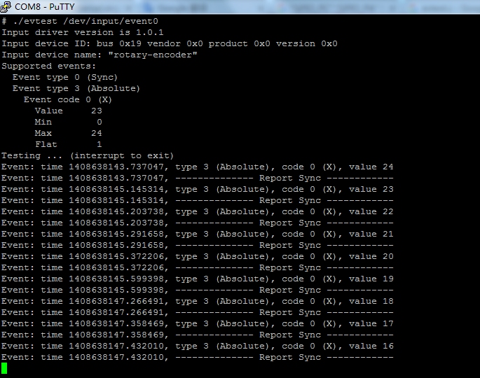

  1. 下载编译 http://elinux.org/images/9/93/Evtest.c
    执行 evtest /dev/input/eventX
