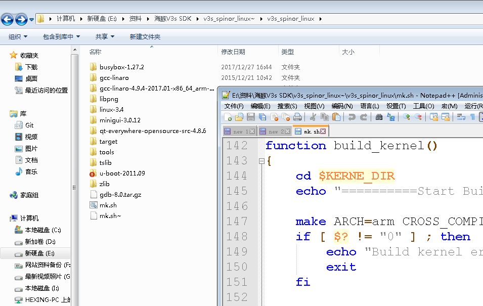

checking that generated files are newer than configure... done
configure: creating ./config.status
config.status: creating Makefile
config.status: creating etc/Makefile
config.status: creating plugins/Makefile
config.status: creating src/Makefile
config.status: creating tests/Makefile
config.status: creating tslib.pc
config.status: creating tslib-1.0.pc
config.status: creating config.h
config.status: config.h is unchanged
config.status: executing depfiles commands
config.status: executing libtool commands
cd . && /bin/bash /disk5/v3s_spinor_linux/tslib/missing automake-1.15 --gnu
/disk5/v3s_spinor_linux/tslib/missing: line 81: automake-1.15: command not found
WARNING: 'automake-1.15' is missing on your system.
You should only need it if you modified 'Makefile.am' or
'configure.ac' or m4 files included by 'configure.ac'.
The 'automake' program is part of the GNU Automake package:
<http://www.gnu.org/software/automake>
It also requires GNU Autoconf, GNU m4 and Perl in order to run:
<http://www.gnu.org/software/autoconf>
<http://www.gnu.org/software/m4/>
<http://www.perl.org/>
make: *** [Makefile.in] Error 1
CDPATH="${ZSH_VERSION+.}:" && cd . && /bin/bash /disk5/v3s_spinor_linux/tslib/missing autoconf
make: *** Waiting for unfinished jobs....
Build ts lib error!!
./mk.sh: line 195: exit: 1tools: numeric argument required
hexing@ubuntu:/disk5/v3s_spinor_linux$
参考: https://github.com/satoken/centroid-rna-package/issues/4
sudo apt-get install autotools-dev
sudo apt-get install automake
sudo apt-get install boost libboost-all-dev
楼主 #16 2018-03-21 20:08:53

基本没怎么操心, 编译完成了。
